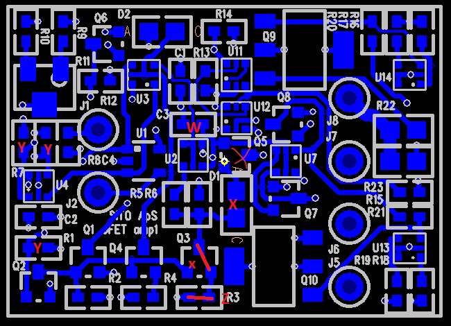

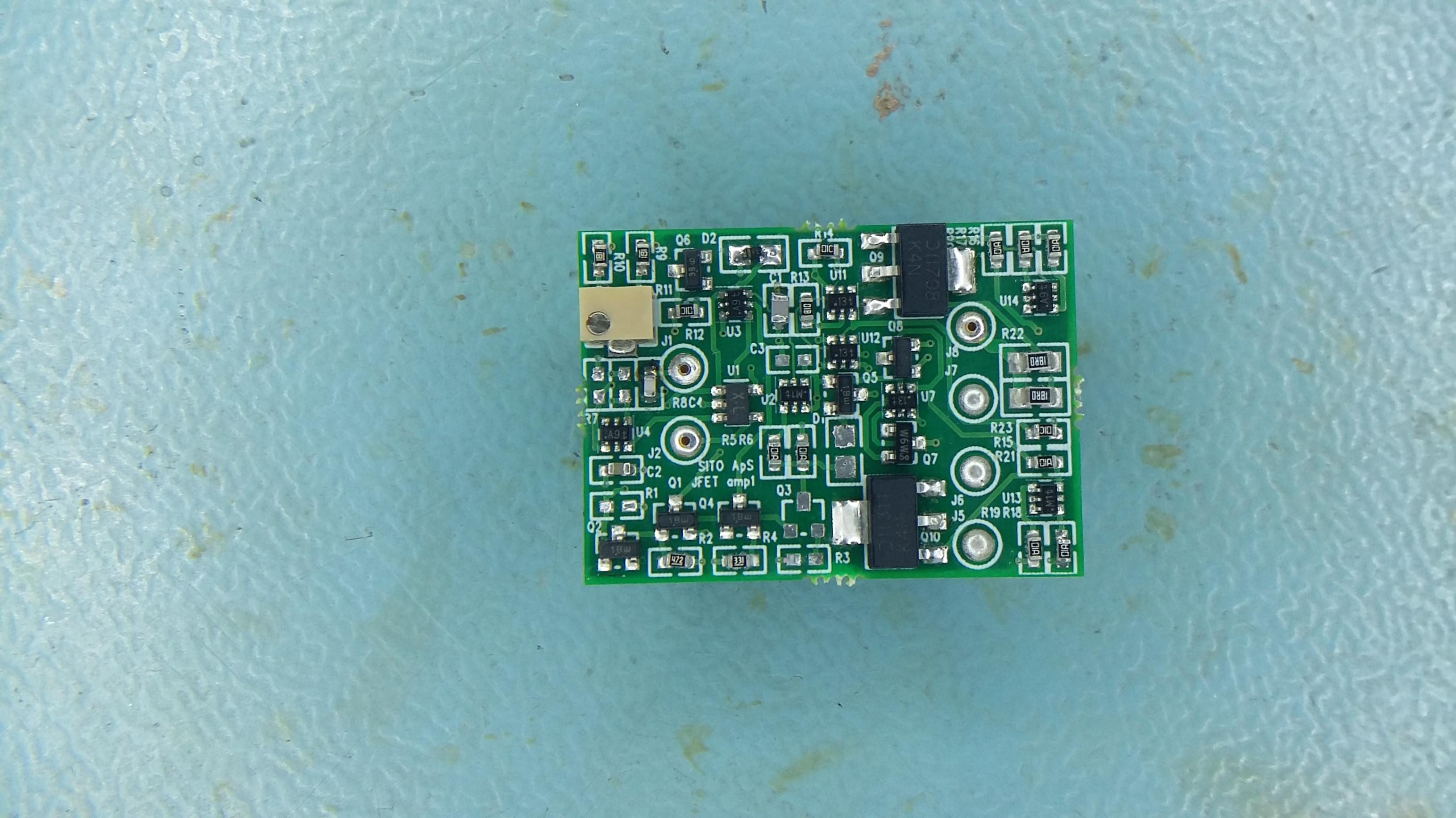

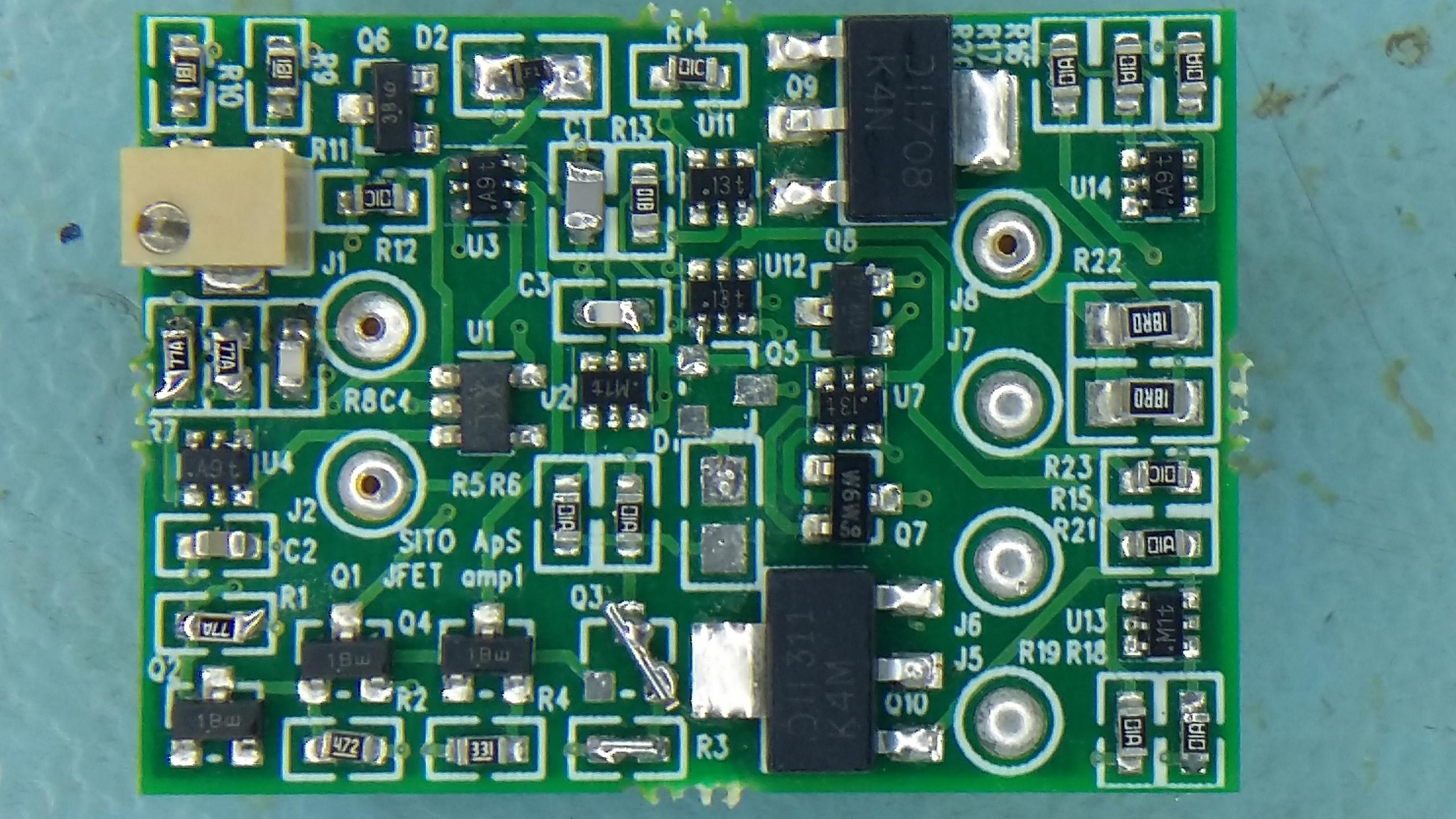

Yes, I had tried quickly the modification suggested by Sonny.
The quick part was doing it; listening / evaluating is still in progress. There is always that shrieking sound of fresh solder on the boards (rigorously un-scientific observation ��)
I would repeat here
- the guide printed by Sonny;
- the original board with only the parts removed; (except Q5..)
- the final assembly.
Y = 620 ohm; .1% susumu RG 0603;
W = 22pF COG 0603

The sound: obviously, attention, subjective opinion coming! And first impression. Also the system is settling.
In the original version I have always very much appreciated a beautiful, refined, full, natural sound, with a hint of a romantic 'halo' around. A tube like sound. With a slight, beneficial veil, probably.. a slight middle-range emphasis.
Now it had changed. The new version opened up, bass is more impactful, contrast augmented, projects a bigger, wider and deeper soundstage, more precise sound but with a warm tone; gives the feeling of more dynamics..
Very entertaining; spectacular.
There is more agressivity in the highs - - now it still to be understood what part of it is still due to burn- in (not existent..) or more transparency revealing nasties hidden before (happens all time to me)...

What happen with the changes was the removal of a bootstrap circuit supposed to give high open loop gain...... So the changed made the circuit simpler but also open loop gain smaller. This was compensated by the lower current in the VAS stage.
