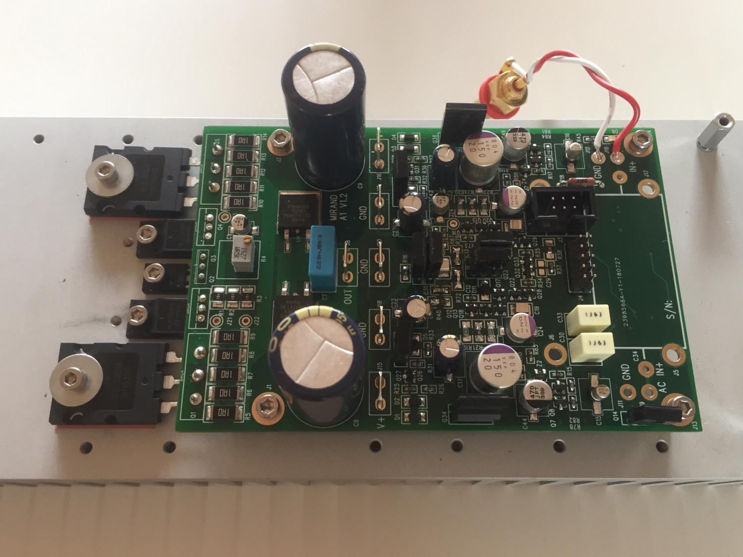

If the ones who have ordered would like to take a look on the picture and see if the assembly of the power transistor is okay!?
Then we could install the power transistors.
Vgeorge?
Vitalica?
Aboe?
Joseph K?
Ravid?
Steven?
By the Way that is 16 channel's until now... Thanks the interest and support in my products 🙂 :cheerful:

I would like to hear how people want's the power transistors orientated on the MIRAND A1 V1.2 so that we can ship them out.

Could you please be more specific? A picture of the options would help.

It looks fine form me, I don't know if there are other options.

Hi Sonny ,
I want under pcb (as in the picture).
Thank you.

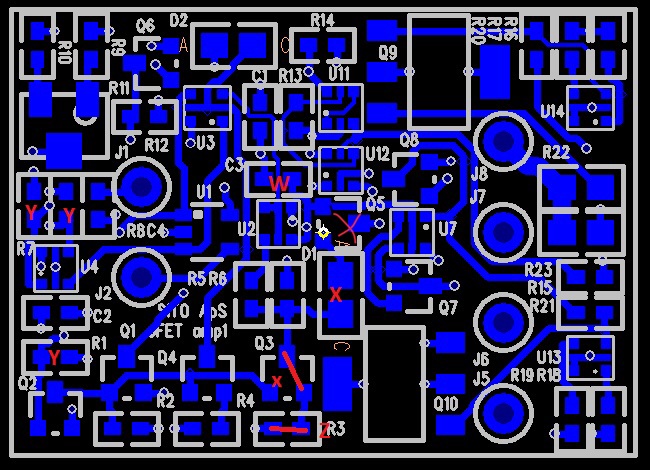

Correction!! Q5 should Also be removedNew Gain module and how to modify the previous version
We have a new Gain module on its way. It sounds better and the current is lower and less heat.
Now existing customers can change there modules if they are experienced in SMT assembly.
Look at the attached picture.
X = remove, If red line (Q3) then a short.
z = 0R 0603 resistor
Y = 620R 1% 0603 resistor
W = 22pF
The new Gain module cost 80€

Does it need to be jumpered like Q3?
