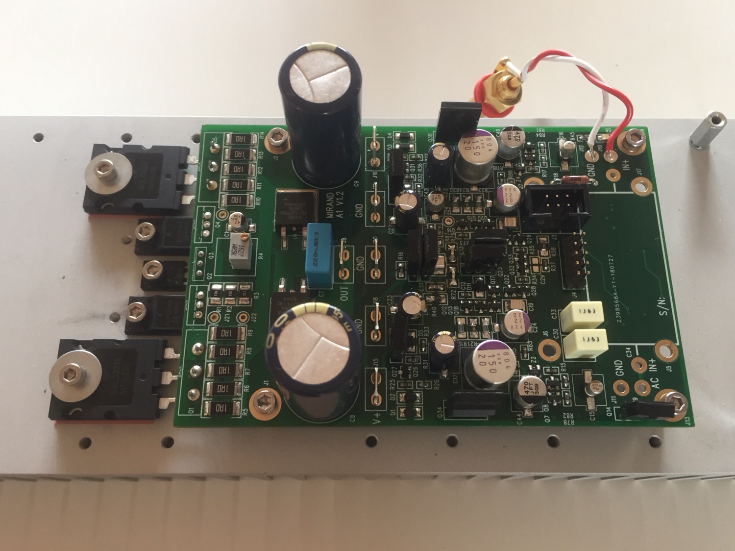

This is How it looks. Only trimming is bias.
And running very stable.
It is set not to break any records. But to be stable. Still it performs very well.

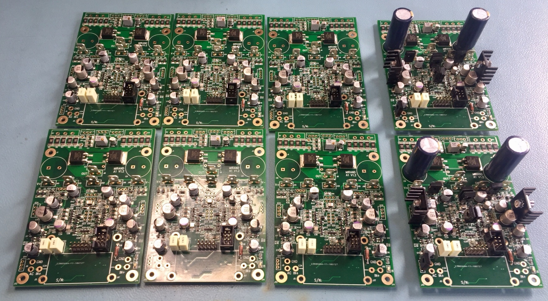

We have tested and Will ship out 2 sets monday/wednesday.
3 sets more is reserved out of 12 pairs. So there is 7 pairs left.
We only had to change 4 caps that takes care of loop stability. They was set very conservative.
Yes it sounds amazing. I have build a lot of amps but this one is in top 3.

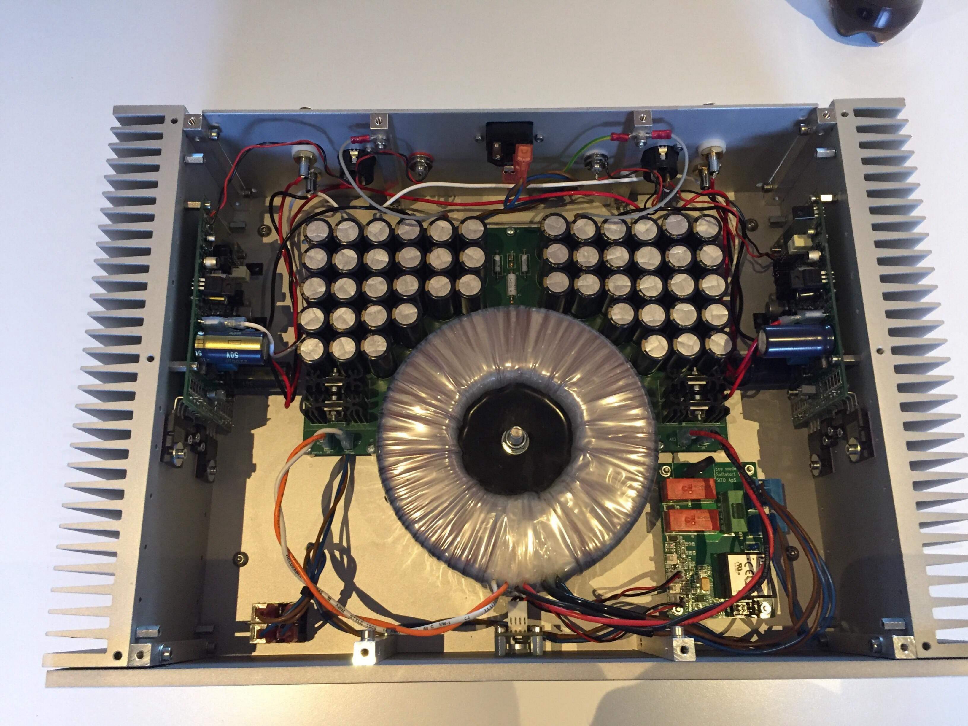

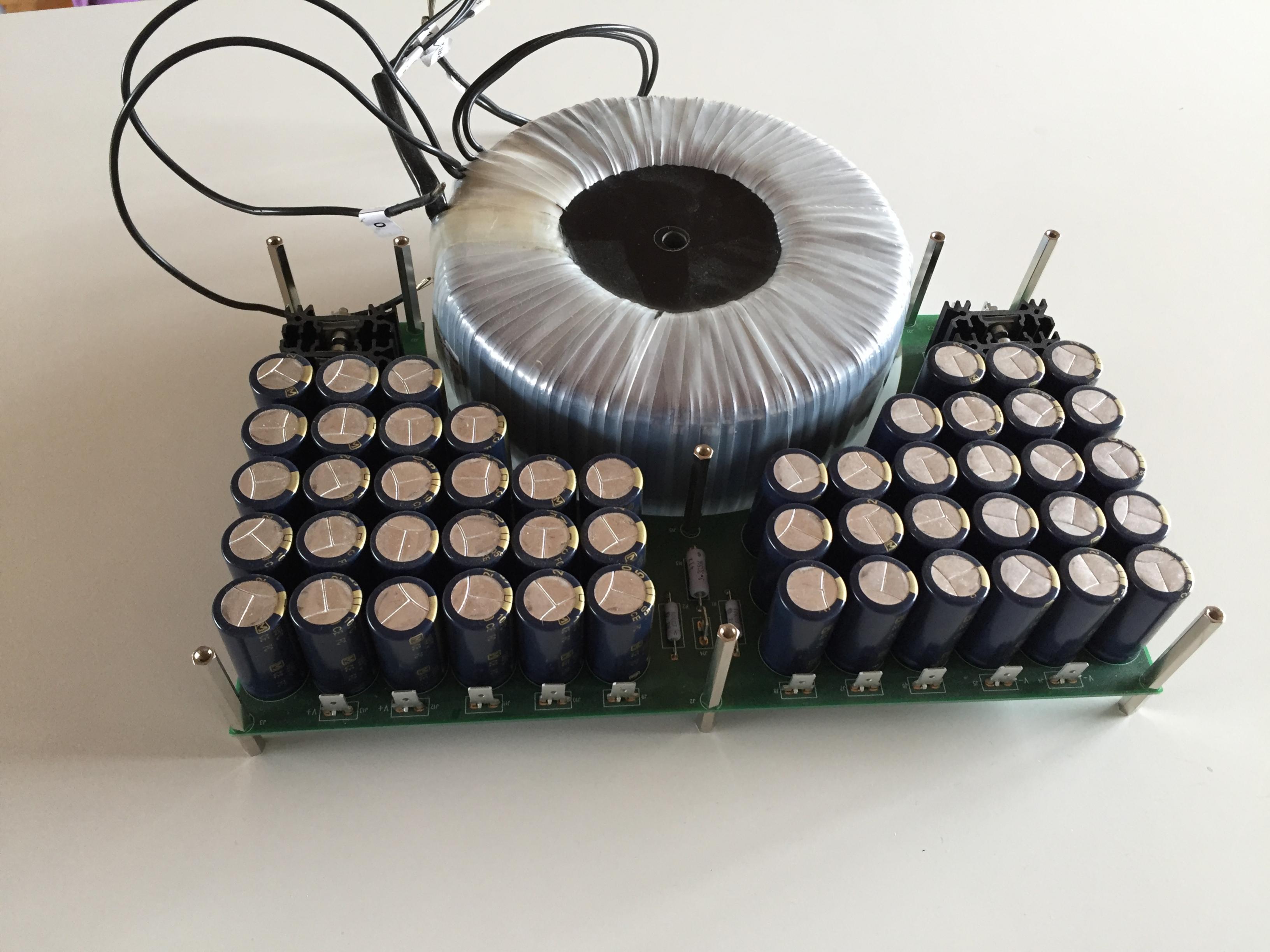

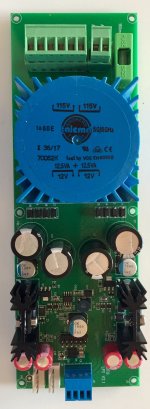

People ask for at powersupply for the Amplifier.
The following board in the attached picture gives 110.000uF/50V or 90.000uF/63V for 230€.
On the second picture you can see a build up using this powersupply and a 800VA transformer.
Cabling is a bit sluggish.

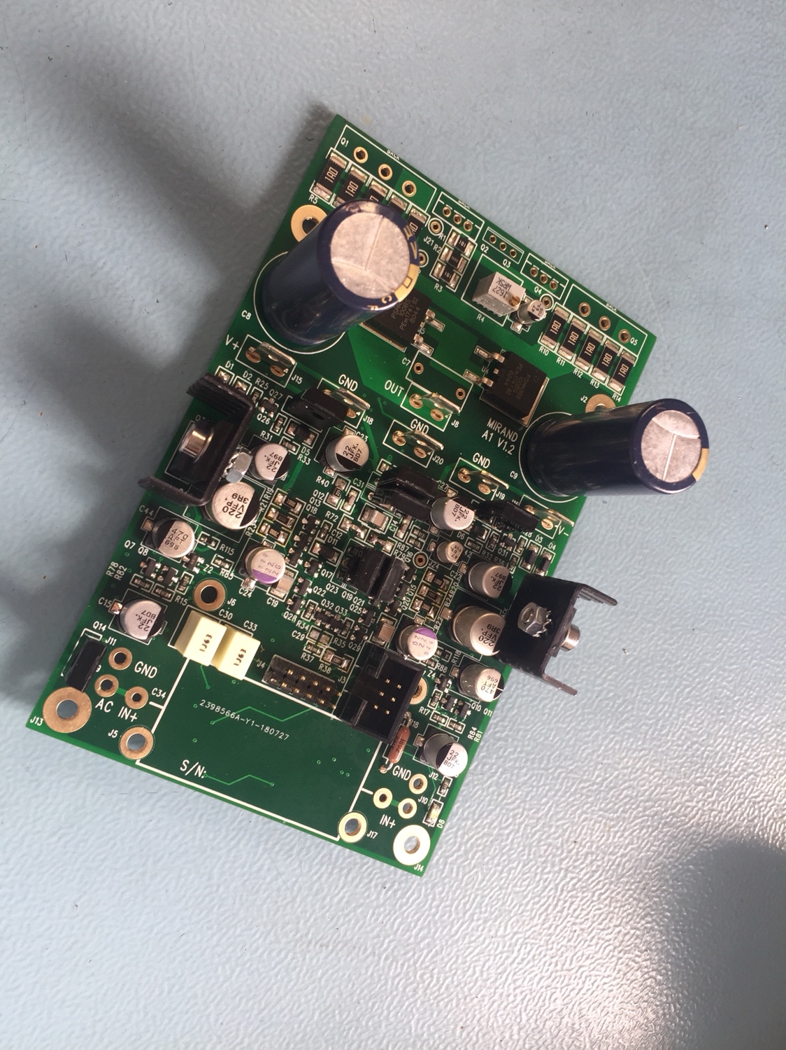

MIRAND A1 V12 specs. Updated!!!
I did some optimization on resistor and capacitor values. Now this has enhanced the performance.
Test is done on a 800VA transformer with 2x32VAC secondaries.
Previous slew rate was 200V/uSec. It is now 300V/uSec.
Bandwidth was 800KHz. It is now 1.3MHz.
The power rating is:
80Watt @8Ohm.
150Watt @4Ohm.
250Watt @2Ohm.
We have optimized on all the amps that we will ship out. No one will not get the old performance.
Only one thing that the amp has hard time cooping with is 10 - 15VDC on the inputs.
So if one plays around with frontends and is a bit reckless from time to time like me i would suggest installing a good capacitor on the front where there is place for it. 4,7uF (-3dB at 3Hz)

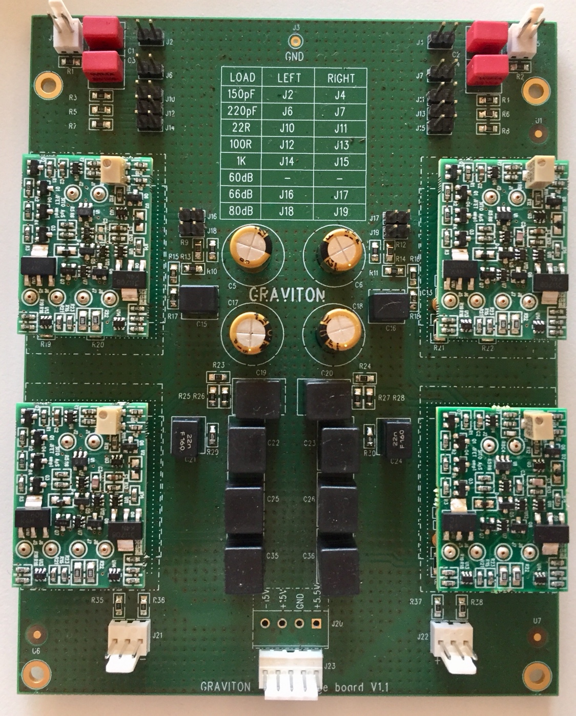

I have some news. For the amplifier, we have designed and ordered a discrete balanced input frontend. It has +6dB gain on top of the 26,9dB gain of the amplifier.
Input impedance is 10Kohm.
Vitalica have ordered them as well. This frontend module cost 80€.

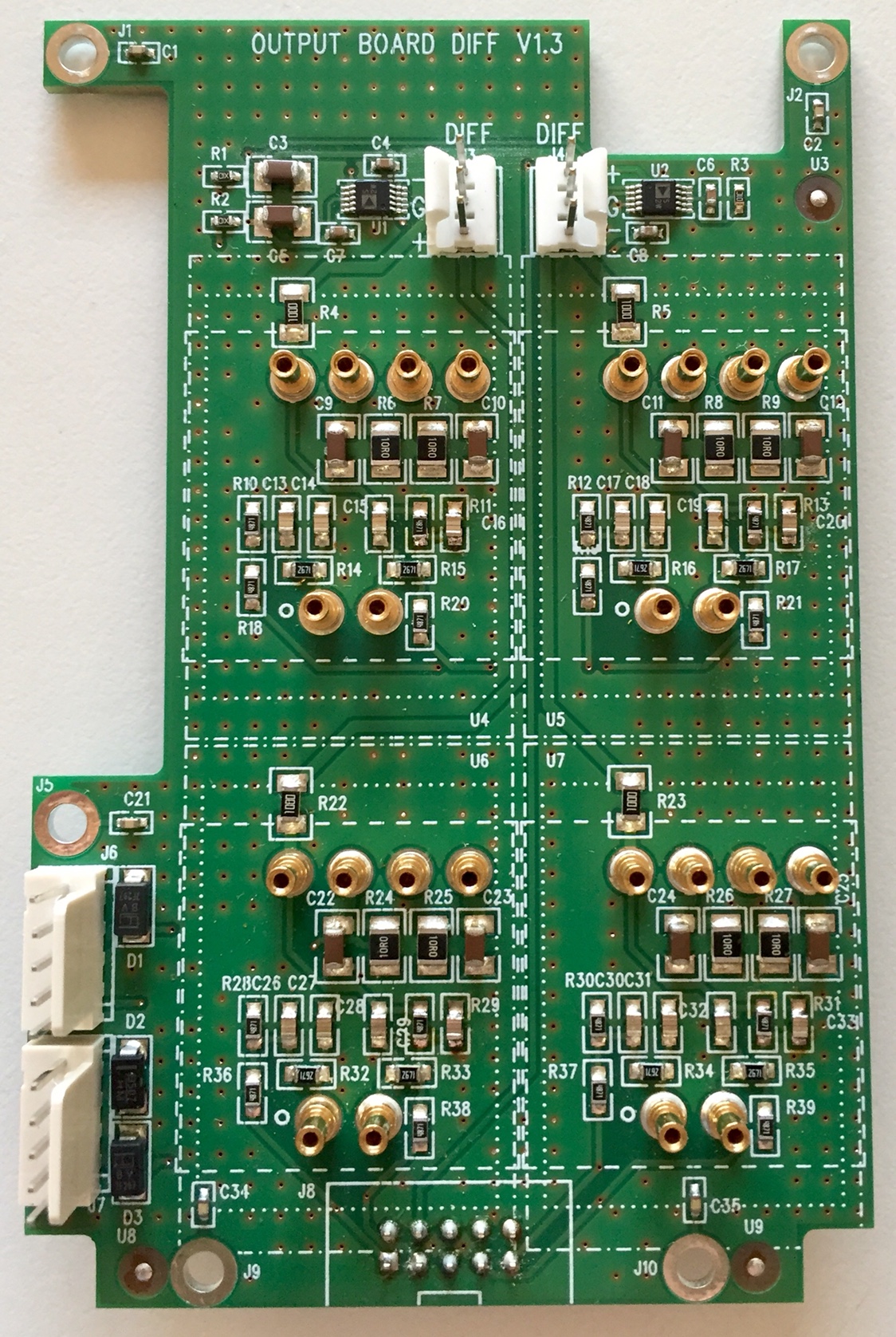

Just A quick update.
We have made a shield board for the discrete output stage. The board where the gain modules are mounted. We have modified the mute circuit to shunt to GND rather than disabling. And it works better and has less impact on the sound.
Also we still have the phono stage which can run at up to 22V supply giving it more headroom.
For the phonostage we just deliver a variant of our LPS V2.1 with output voltage changed to 22V instead of 15V.
If it is shielded from the power supply it produces a very quiet signal which is neutral sounding and in the same time has the same wonderful sound signature of the gain modules.
It can easily be used for MC pickup as well as MM.

We have adjusted some of the current to get a lower power dissipation. We are aware of it with the higher voltage. It is mainly in the frontend VAS conversion and it is not necessary to run that high bias as we have done.
And thanks Joseph.
I do not know if it makes sense to write this.:
The Mirand A1 V1.2 is not exacly cheap with 199€/channel.
So if someone would ask what if they break? Will they put out DC on the speakers? Short no they will not put out DC on the speakers. Only max a few Volt but that is in faulty state... Normally we should not see more than a dew millivolts.
The protection circuit is a separate section. Meaning that it monitors powersupply and DC on the output. So if they break or the customers have put DC on the input, They will disable the output.
If a customer is not sure about the source or if they are playing around with sources... I would strongly recommend to install a capacitor in the input... There is space for it.....
It can happen to us (Also me) all, if we play with own build (DIY preamps and DAC's) sources, that we could have DC on the input and 2.5 to 3 VDC should not be a problem but 5 - 15VDC will destroy the input on the amp due to excessive current through the input stages. ...
Short i am prepared to support in such cases. And we do repair them...

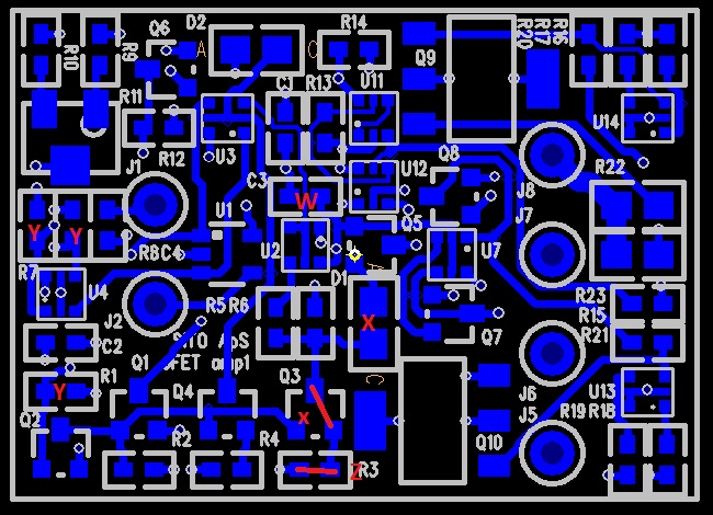

New Gain module and how to modify the previous version
We have a new Gain module on its way. It sounds better and the current is lower and less heat.
Now existing customers can change there modules if they are experienced in SMT assembly.
Look at the attached picture.
X = remove, If red line (Q3) then a short.
z = 0R 0603 resistor
Y = 620R 1% 0603 resistor
W = 22pF
The new Gain module cost 80€
