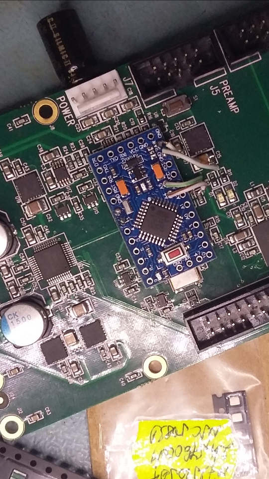

As Sonny knows it so well: we are in two with this request..
Although with sligthly different configurations, I am using the dac in a 'headless' mode with appropriate firmware.
Right now, to get the dac in dsd-direct mode, I'm using this hardware hack with an arduino
