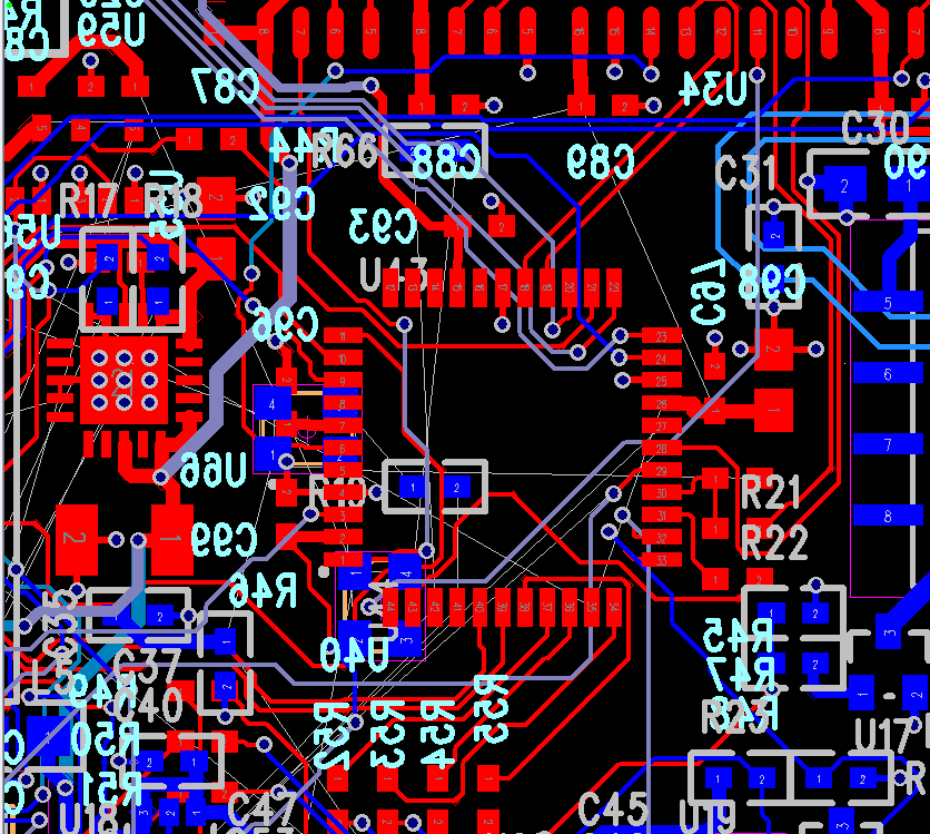

Regarding the DAC V1.2 i have made some changes to the oscillator because it was simply not good enough.
I have added low pass filtering on the powersupply and i am going to give the oscillators there own ground reference today because they sit on top of the U43 44 TQFP (Shown in the attached picture).. And i am sure that is the source for the problems.
So later today i will upload a picture of the same position showing the ground plane for the oscillators.

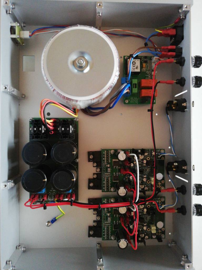

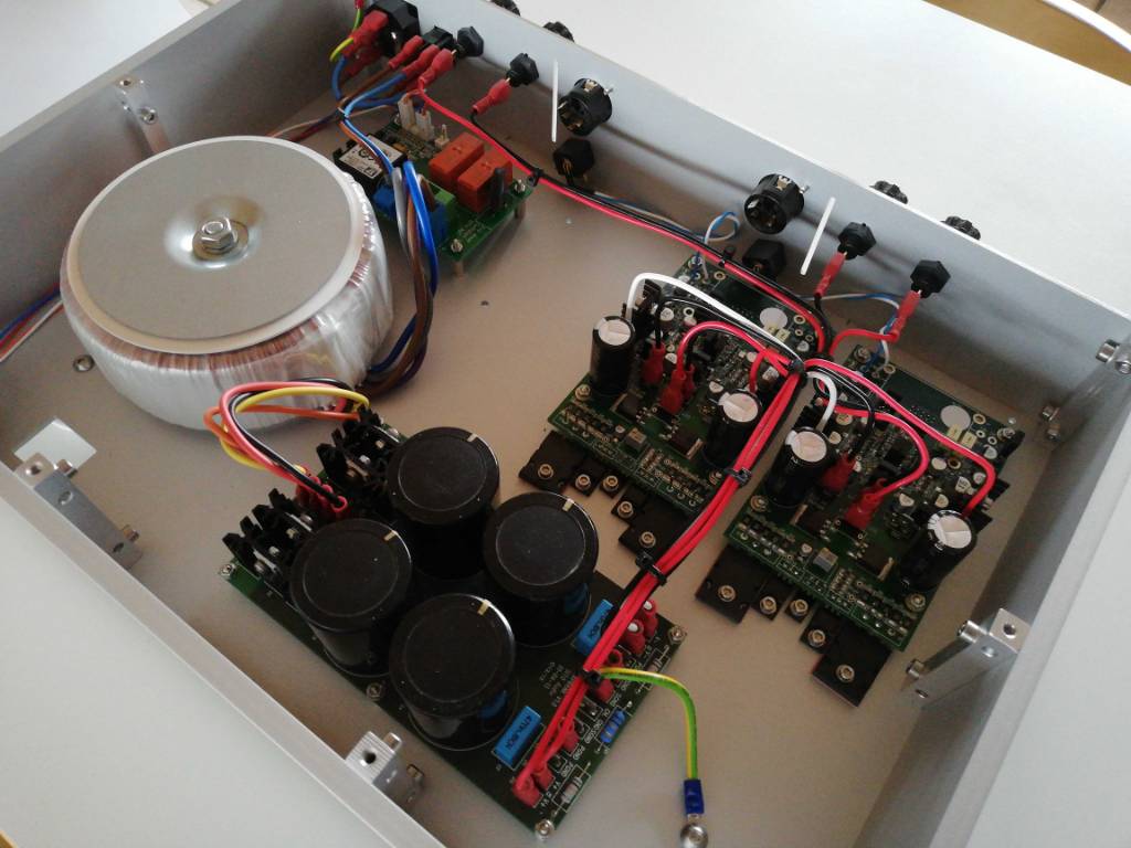

Does anyone have photos of fully assembled amps?
