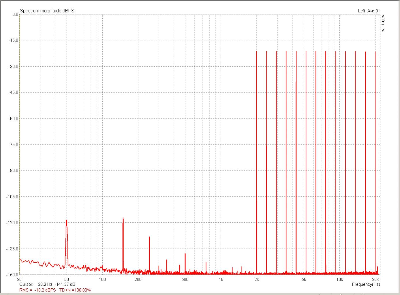

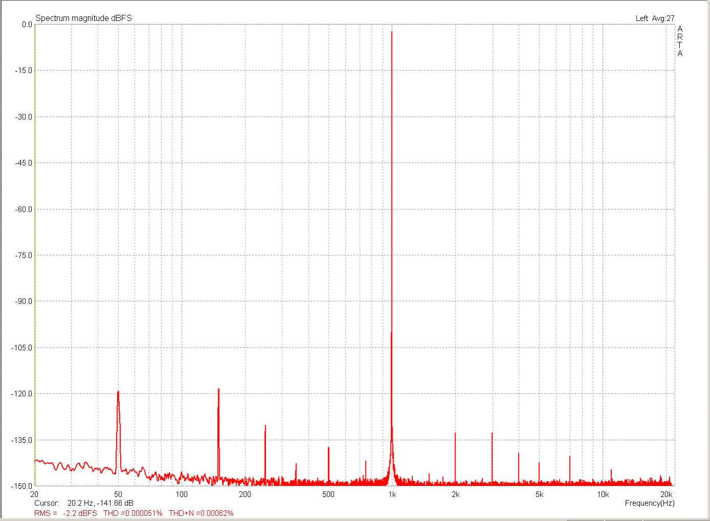

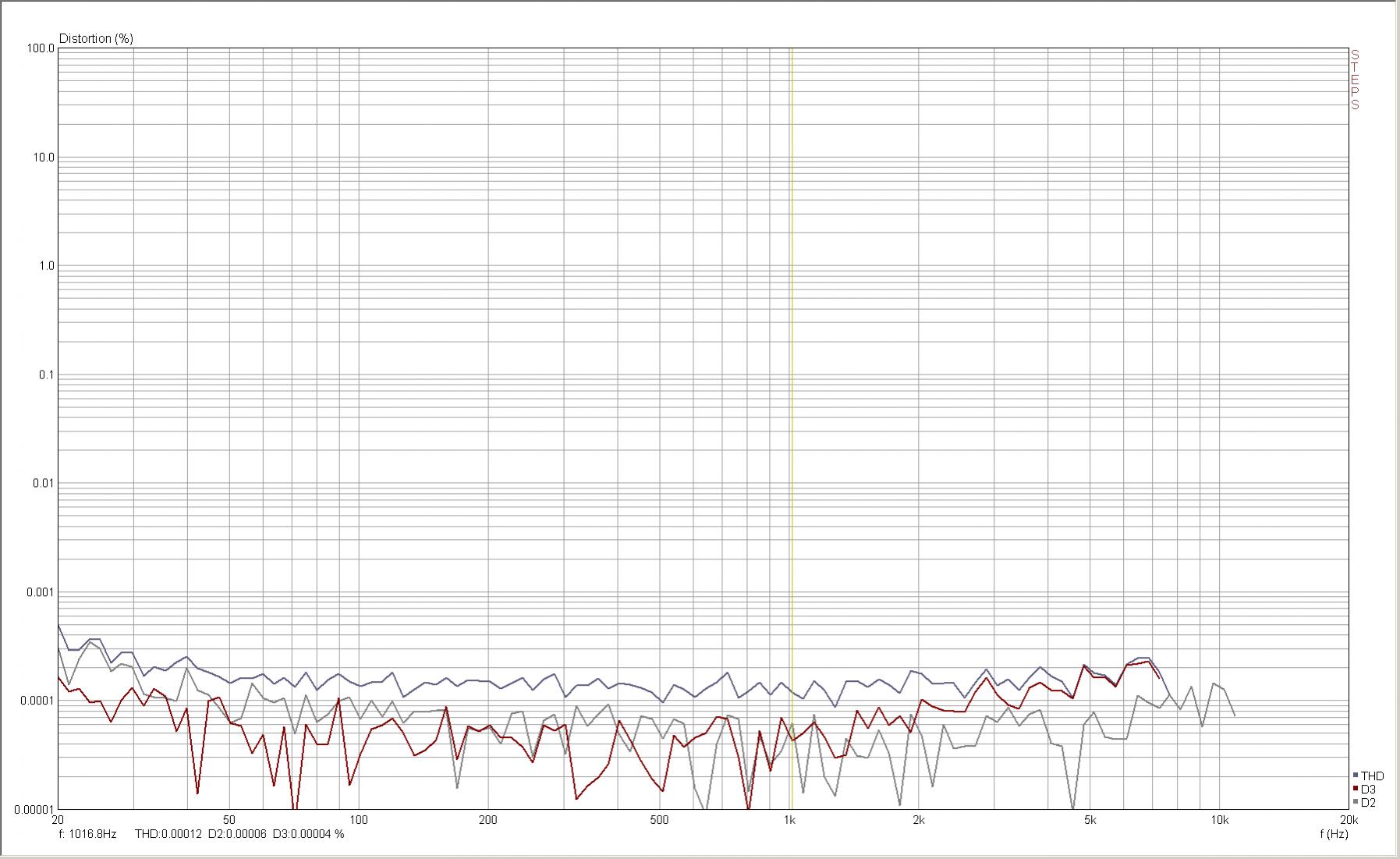

During xmas I had been following, quite amused, the debate about the qualities of Sonny-s discrete output in the Mirand dac.
I had been traveling, and had to get access again to Factory2nd's Mirand dac, but wishing to have a better look at it..
Here it is the performance of Sonny's Mirand Dac+discrete shield into my EMU1616m sound card.
Usually I'm testing at a lower than maximum output level, more relevant to real listening situation. The sweet spot in my EMU card is usually at -10db wit respect to Full Scale.
The dac is having an above average output level, so it's -10dB FS is fitting well to the ADC 0 dB full scale in the EMU card. The Single Ended output is used, and he EMU card is set to Consumer level input, -10dB setting.
Also, I'm using 44.1 kHz sampling, so as to be able to reveal this low levels of distortion..
The performance get's more 'real world' like at higher frequencies. I got 0,0002% THD at 5kHz, and 0.0003% THD at 10kHz.
Also, work is in progress for eliminating the residual hum still visible.
Not an easy task because of the large ground loop created in the measurement. (DAC is not isolated, and the measurement is not balanced)
Concluson: I got quite much baffled when I first had seen this. It's kind of better than most opamp outputs..
Ciao, George

Thanks for the measurements you have done, It is better to have a non affiliate to do such measurements.
Thanks again.
