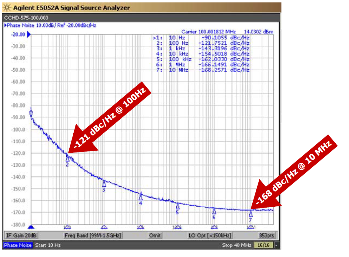

Old AK4490 USB DAC upgrades. Many have asked about the oscillators onboard if it is possible to get them with better oscillators.
Now it is. Crystek offers an oscillator called CCHD-575. This oscillator has really low phase noise in a package of size 7.5x5mm so they can replace the FOX used before.
New boards of AK4490 USB DAC V1.0 (USB only) can be fitted with them for additional 10€ (5€ extra per oscillator - You cannot buy them at that price)
If you have an old board. The easiest way of fitting them is to use a standard heatgun with nozzle and 260 degrees Celsius and a
tweezer.
Mouser has them in stock
CCHD-575-25-24.576
CCHD-575-25-22.5792
The phase noise is 25dB better than the FOX electronics.

Sonny, that phase noise plot is for 100Mhz the 22.576Mhz is 10dB better.
