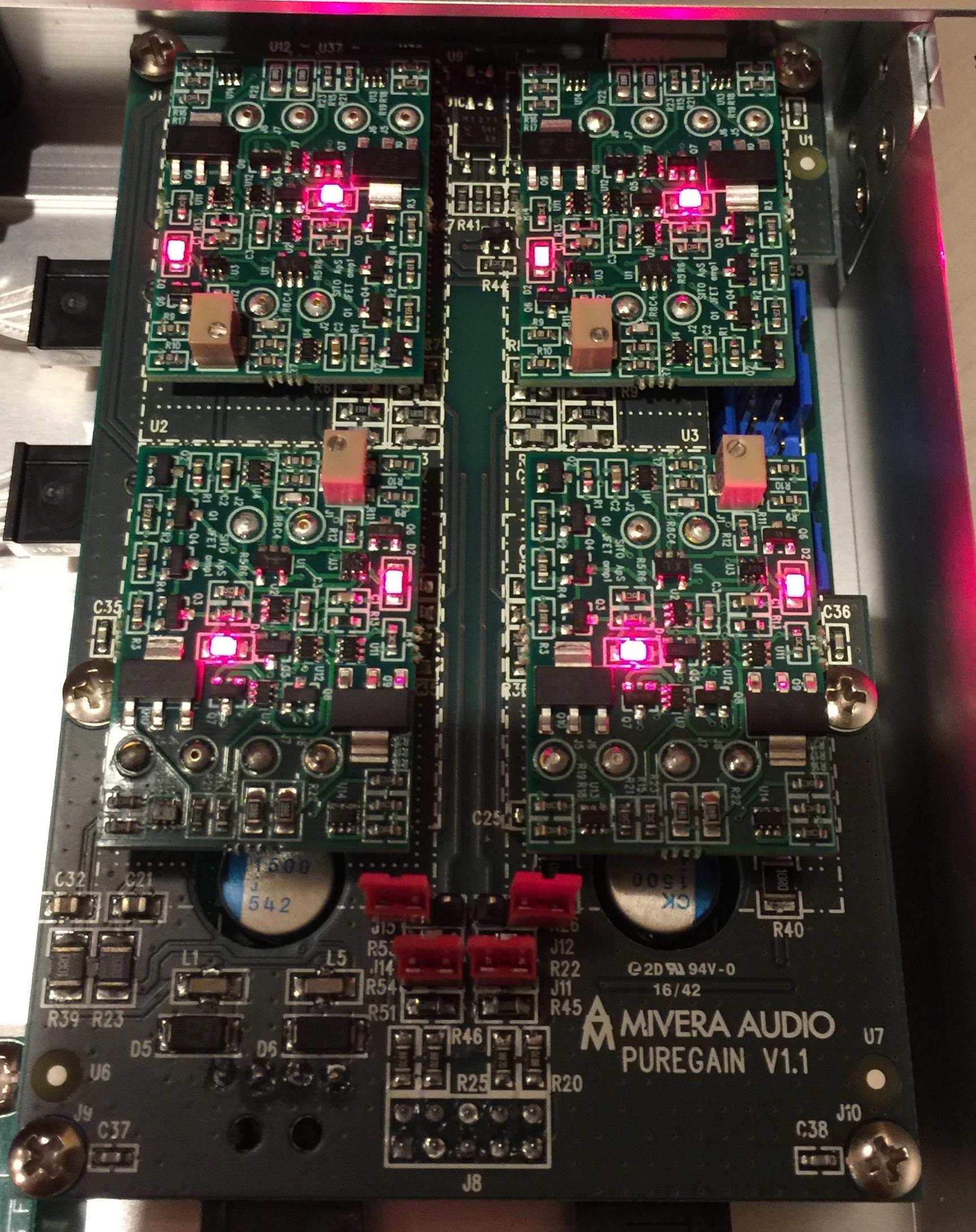

No wonder printline closed, used them a couple of times for prototypes, but after my 2nd batch of significant substandard PCB's I gave up on them....
Now I use only PCBCART for my prototypes and sometime first series, they just work....
The PCB i showed above is from multi circuit. They are okay fast, and the Stencils are only ~85€ compared to the 200€ from Scanditron, Elprint, Printline...
Only Scanditron does know what they are doing, so the stencils are better from them.
I had a talk earlier with a guy from Rokoko (He is a member here) and he asked me about quality from pcbcart. So i will just pass you comment onto him.

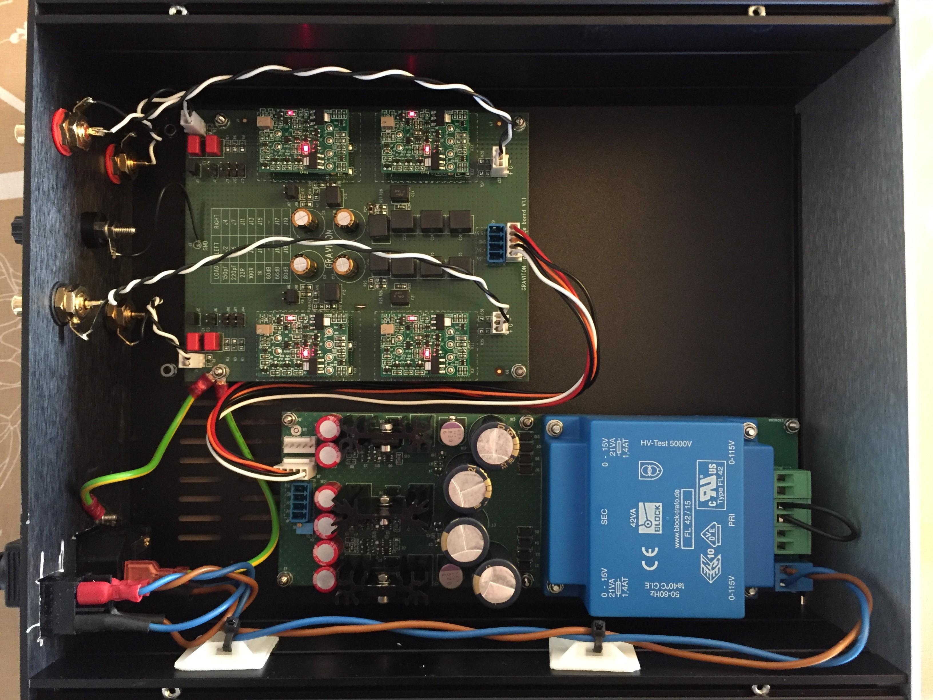

While waiting on me to get the new DAC board (I am working on the DAC today with SPDIF, optical, USB and a I2S header)and Graviton power amplifier ready i have uploaded picture of an example of an assembled Graviton phonostage.
On the picture below you can see that i have the PSU in the same chassis.
I would recommend to have it in a separate chassis or having a wall between the powersupply and the RIAA stage.
So in this example i have hum, but it is regardless of selected gain.
Even at 80dB gain the S/N is very good.
