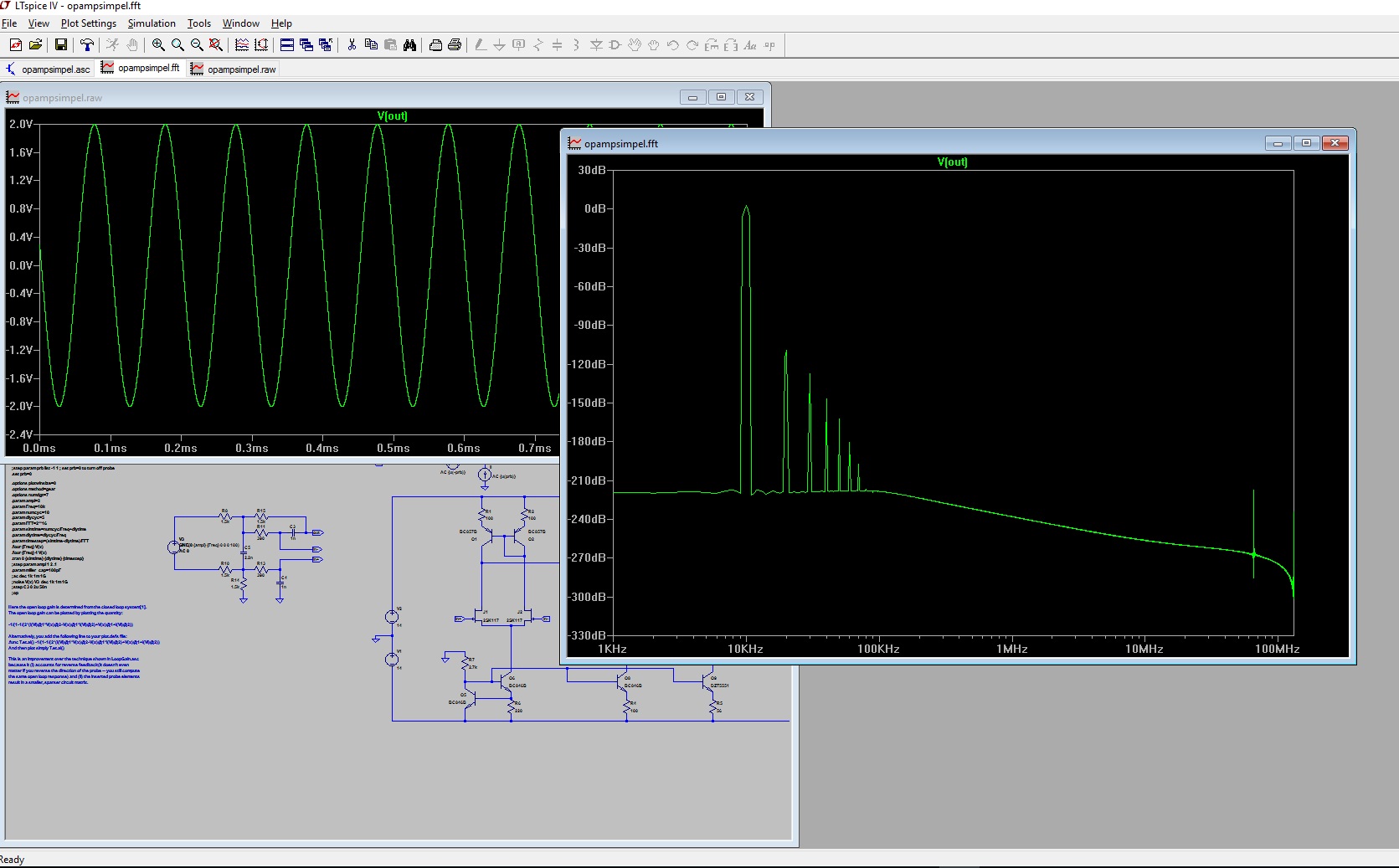

Now to give some impression here of the performance of the discrete at 10KHz. with 1Kohm load.
Harmonic Frequency Fourier Normalized Phase Normalized
Number [Hz] Component Component [degree] Phase [deg]
1 1.000e+04 2.000e+00 1.000e+00 171.53° 0.00°
2 2.000e+04 4.869e-06 2.434e-06 65.22° -106.31°
3 3.000e+04 6.168e-07 3.084e-07 -109.76° -281.29°
4 4.000e+04 6.568e-08 3.283e-08 165.88° -5.65°
5 5.000e+04 1.051e-08 5.252e-09 63.65° -107.89°
6 6.000e+04 1.303e-09 6.516e-10 -36.55° -208.08°
7 7.000e+04 1.851e-10 9.252e-11 -139.92° -311.45°
8 8.000e+04 2.592e-11 1.296e-11 134.14° -37.39°
9 9.000e+04 5.322e-12 2.661e-12 -164.56° -336.09°
Total Harmonic Distortion: 0.000245%(0.000247%)
And the FFT simulation is attached. I have real world measurement for the DAC also that backs it up.
BR
Sonny
I don' believe you..
Atached file is for opamp..
Discrete output have 1% at 10kHz
Screendump attached!!!!! 😕
Never mind, I will find some time to make simulation from your schematic.. it is impossible to have such THD.. if your real measurements and simulation which screenshot you upload are same, there is nothing to 'use against you'..
