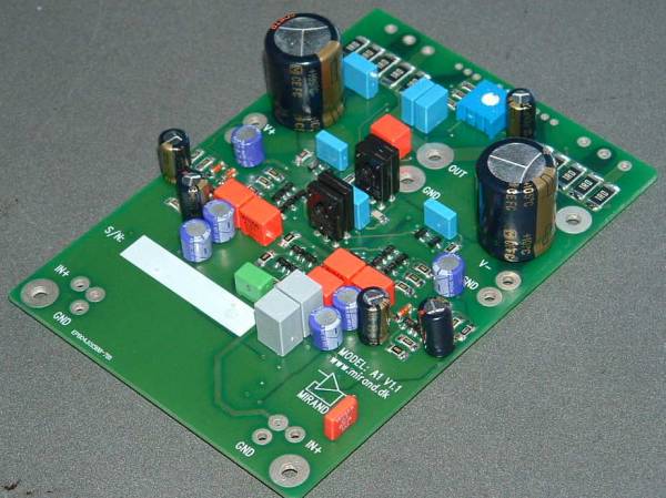

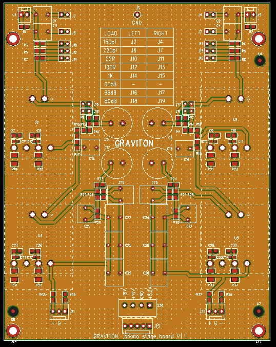

Hi The Graviton is a current feedback that is DC coupled and uses a servo to get offset below a few millivolts. It is based on the Mirand A1 V1.1 which is updated. (see picture of the original A1 V1.1 amplifier)
Gain is 26.4dB
Slewrate: ~75V/us (Higher can be achived at the expense of phasemargin)
Phase margin at 470nF||8R : 42 degrees
Supply voltage : +/-45VDC
Min load impedance is 4R.
Bandwidth: 1Hz (Servo limited) to 480KHz.

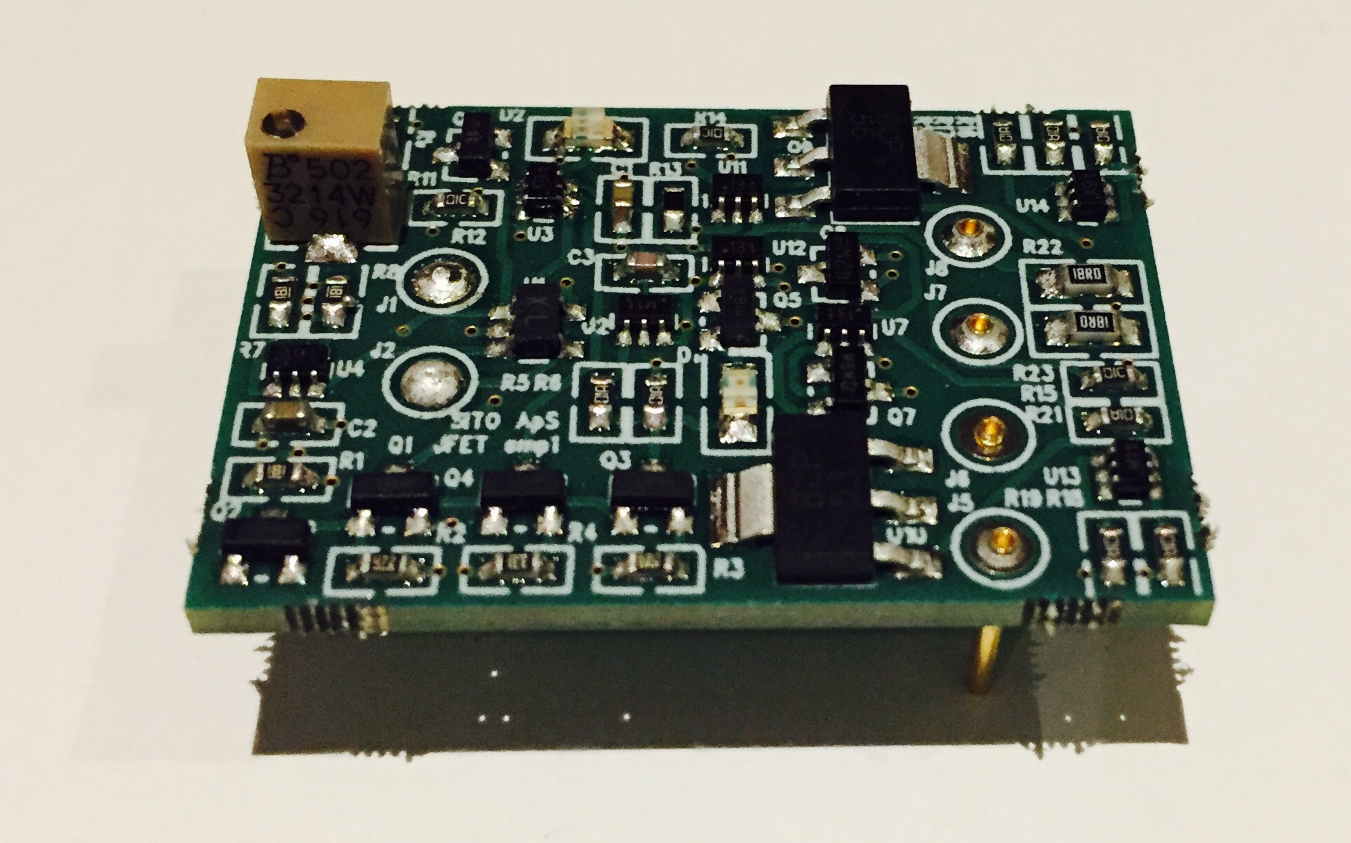

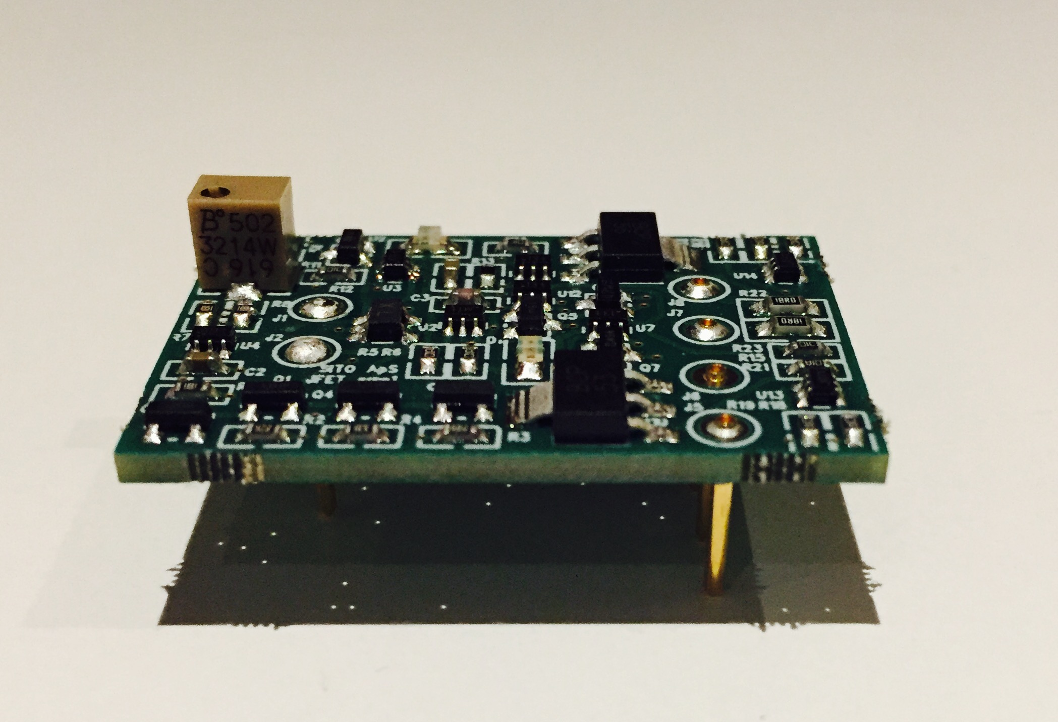

I forgot some features
1) D.C. Protection build in
2) input for external temp sensor
3) interface to front panel with i2c
