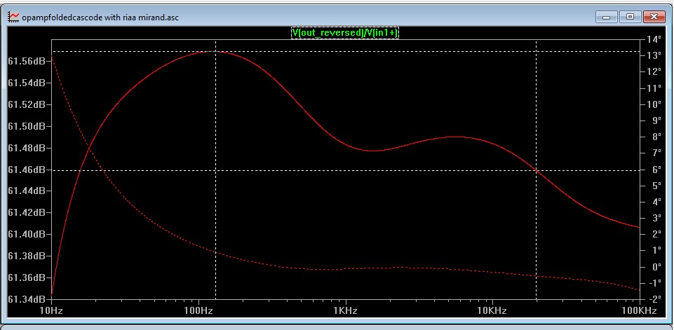

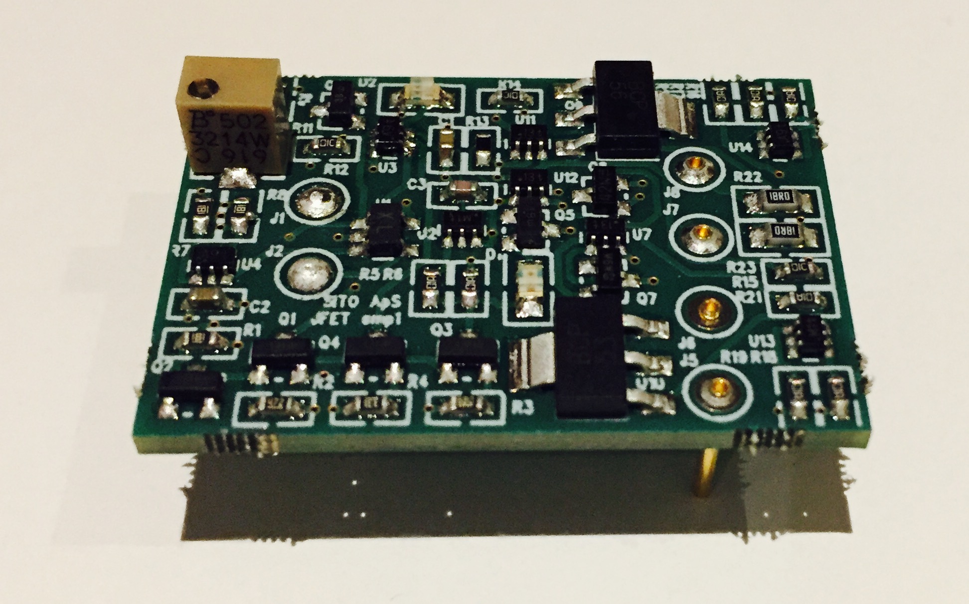

I have attached the RIAA curve. It looks wavy curve but look at the left scale and you will see it is within 0.2dB.
It uses two of the modules per channel as the one shown below. It is 2520 pin compatible. So the design is safe for several years as there is several modules on the market in 2520 design.

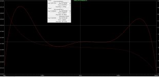

The RIAA curve with MKP1837/KP1830/FKP2.
