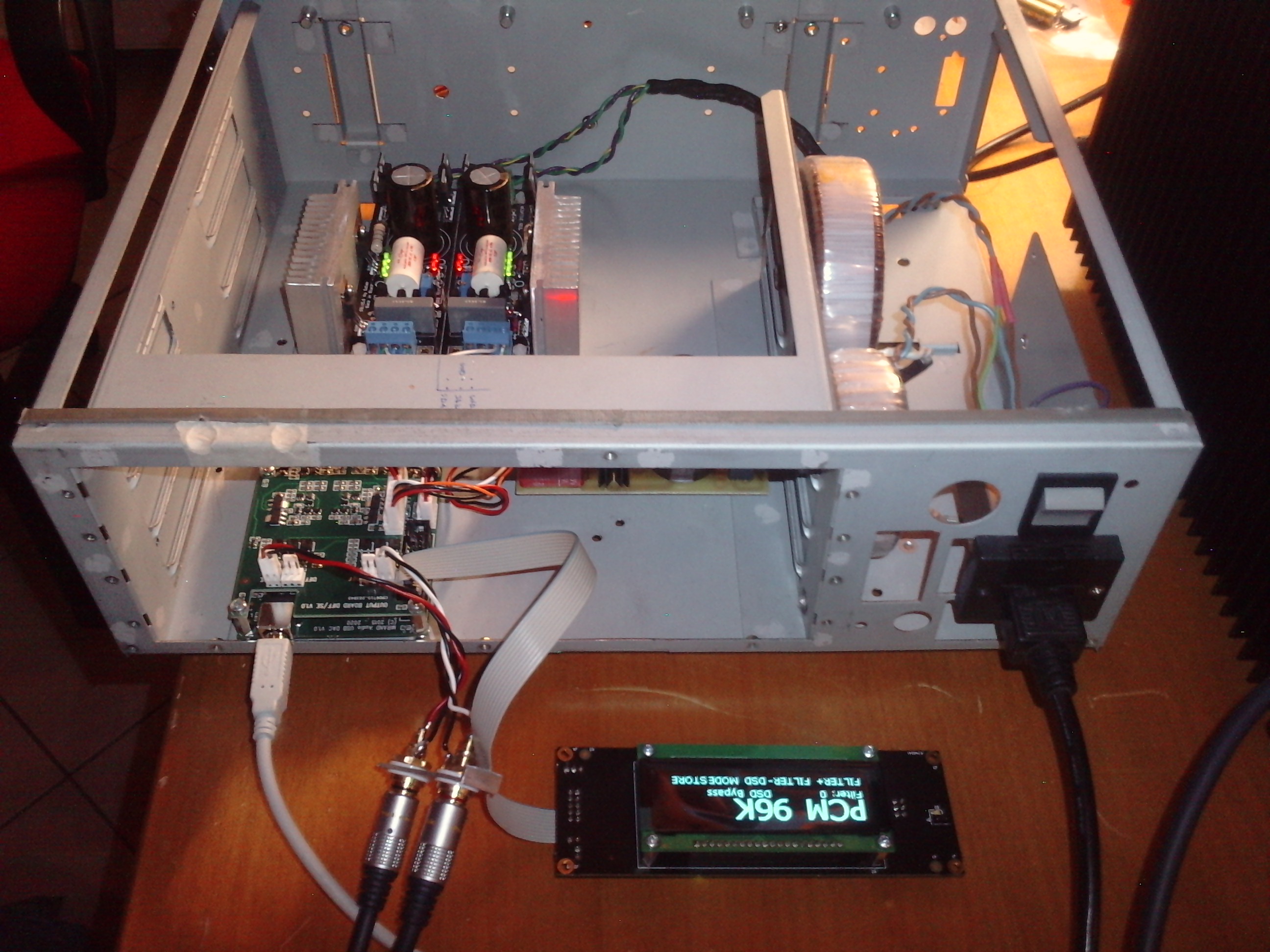

I do not find words to describe the admirable sound of this DAC🙂🙂🙂
i supply it with one Reflector at 6.20V and one Bib +/-14V

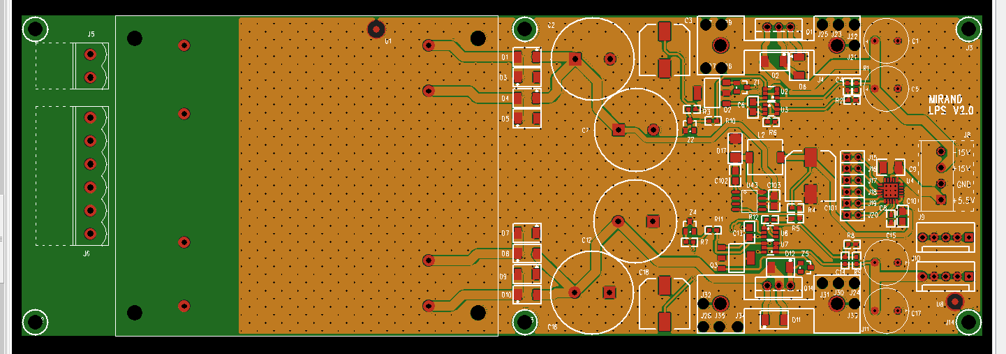

We have changed the size of the heatsink and added a low noise smps before the +5.5V low noise regulator.
But everything still fits in the space
The wrongly made LPS (V1.0) does work but is limited to 200mA on the +/-15V and 100mA on the +5.5V (can be adjusted from +5V to +6V)
I sell the LPS V1.0 to 75€/pcs until the 9pcs are gone.

It uses larger heatsinks now. PCB has ventilation holes around the heatsinks.
The +5.5V which generated a low of heat is made up of an LM2674M simple switcher with fixed frequency so the noise from it is very low. On top of that it is followed by a low noise voltage regulator from TI. TPS7A4700. So the +5.5V is very low noise as well and heat is lower.

New firmware for the frontpanel when used with the DAC only.
Two weeks ago we have made a new firmware for the frontpanel used with the DAC only.
