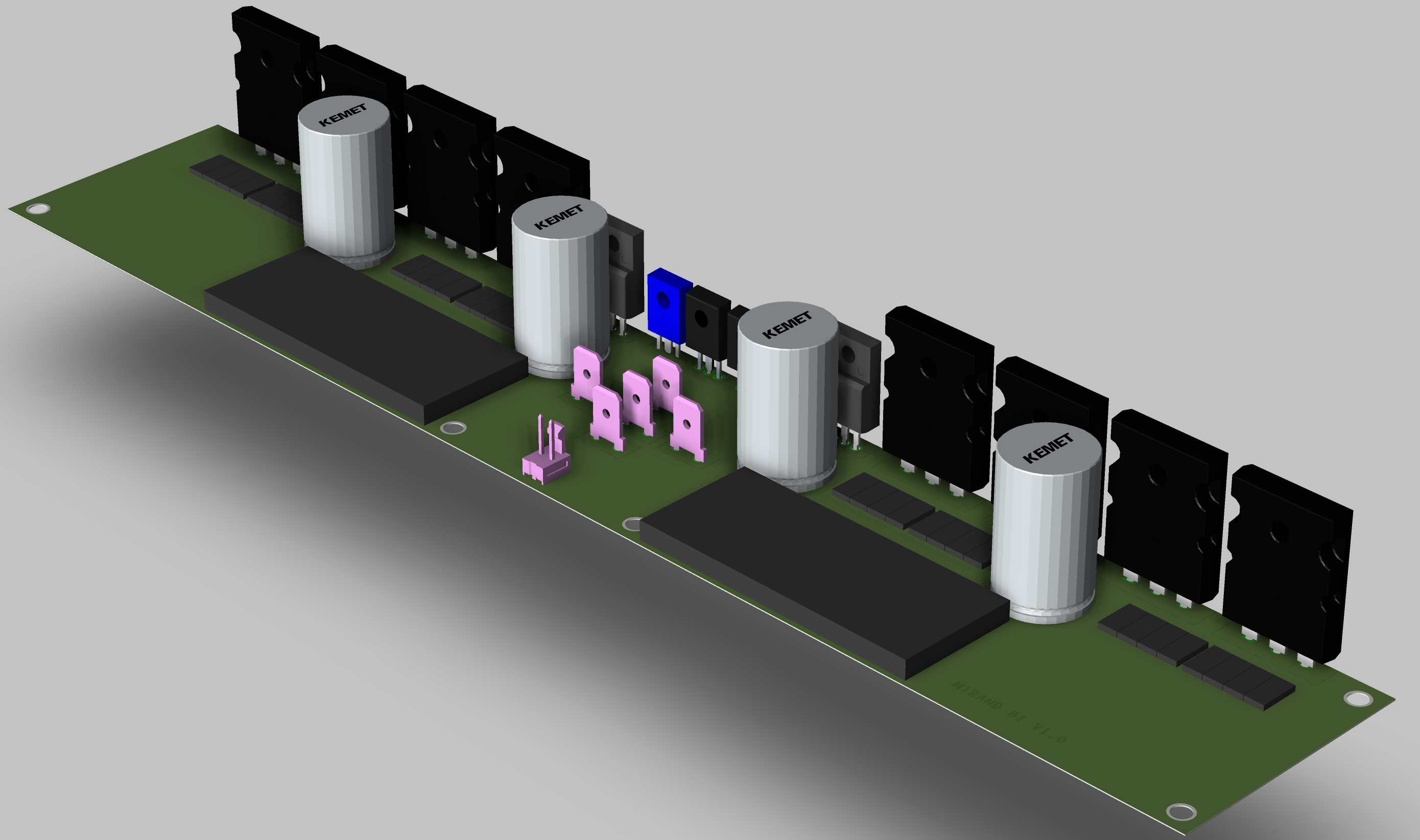

Is this to big? 280x50mm
I know that some of the caps is in the way of screws in power transistors.
Also the two flat package in the front is supposed to be two axial film capacitors.

Yes it is more powerful. It can run up to +/-85v. But that would require good cooling as it will dissipate close to 400W worst case.
So to any working with amps is 300W range with 4.output devices only... That is not enough as they will dissipate close to 100W each. That's why it is 8 power devices.
I call this one a elektor legacy as it is still current feedback but there are some simerlarities with some of the elektor design. It is more simple.
The two input caps are essentially working in parallel. So best is better than 5% tolerance.
