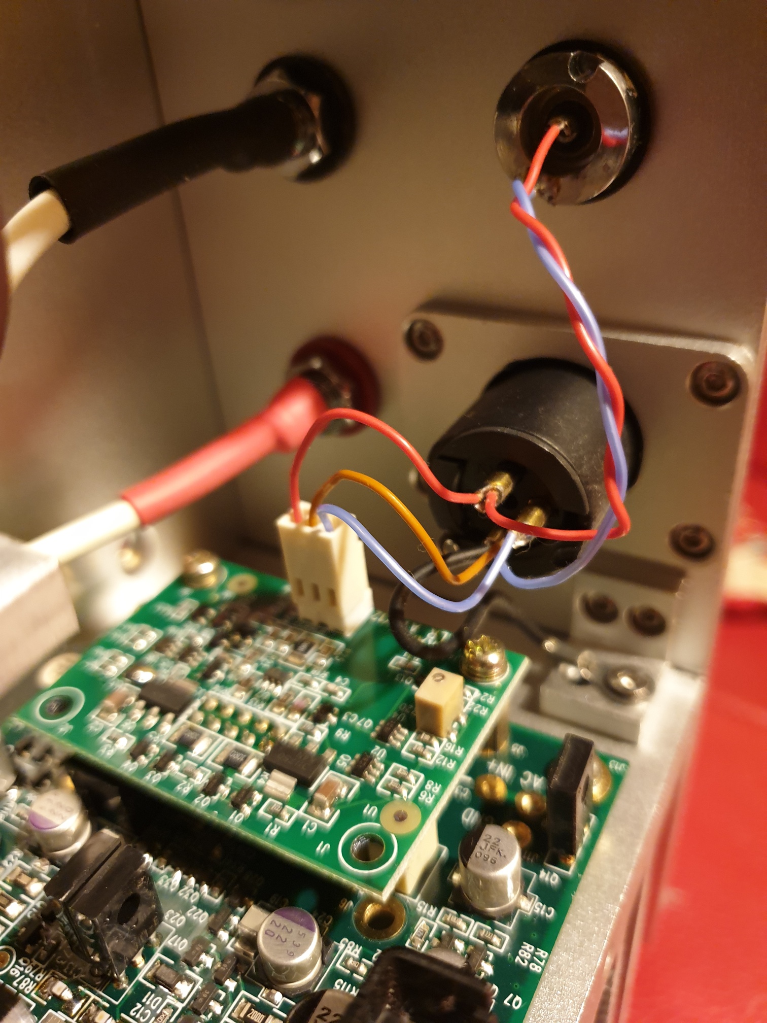

This must be one of the easiest amplifier to setup, one trimmer for bias and that's it!
Set it at 20mV which is 50mA. Since they're not like Mosfets which love heat, I decided to keep them biased like this. I think this will a good start point and will test different set points to hear any differences if any. I know that VZaudio keeps their amps biased around 20mA and they sound amazing.
Do
So this was all setup properly after I read the second section of the manual.. 😀
Still have these questions though..

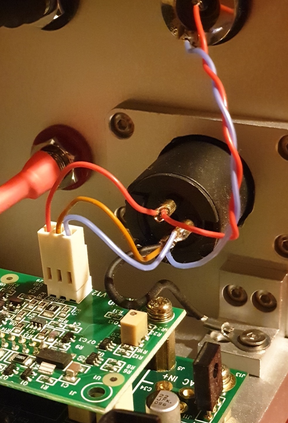

- What is the optimal input cap value 2.2uF / 3.3uF? Can we omit input cap?
- If using the XLR input board, the 3 pin input connector is not labelled with +/-/gnd, I found out that center pin is gnd by probing and looking at Vitalie's pictures (which was hard to see the connection), if looking at the PCB from the input side, from left to right, left being pin 1 for this scenario:
1 = (-) or cold
2 = (gnd)
3 = (+) or hot
Is that correct? There's no documentation for the XLR input PCB...

XLR A1V12
I hope it looks good now 🙂

Dominic: Did you get it fired up? It is best to run it with XLR frontend. It is setup as differential with output sense point attached to amp. it has a huge poisitive impact on the current loops. If you use it without the frontend you could use 3.3uF in series giving it a highpass frequency of around 4,8Hz
BR
Sonny
Hi Sonny,
I will use the XLR board and use pseudo differential cables if I need to run a unbalance source on it. I got the first board fired-up last week and adjustments was quite easy. I was just missing some standoffs for adding the second board, I received them this Tuesday and will play with the amp this weekend if time allows it. Can't wait to listen to it!
Ciao!

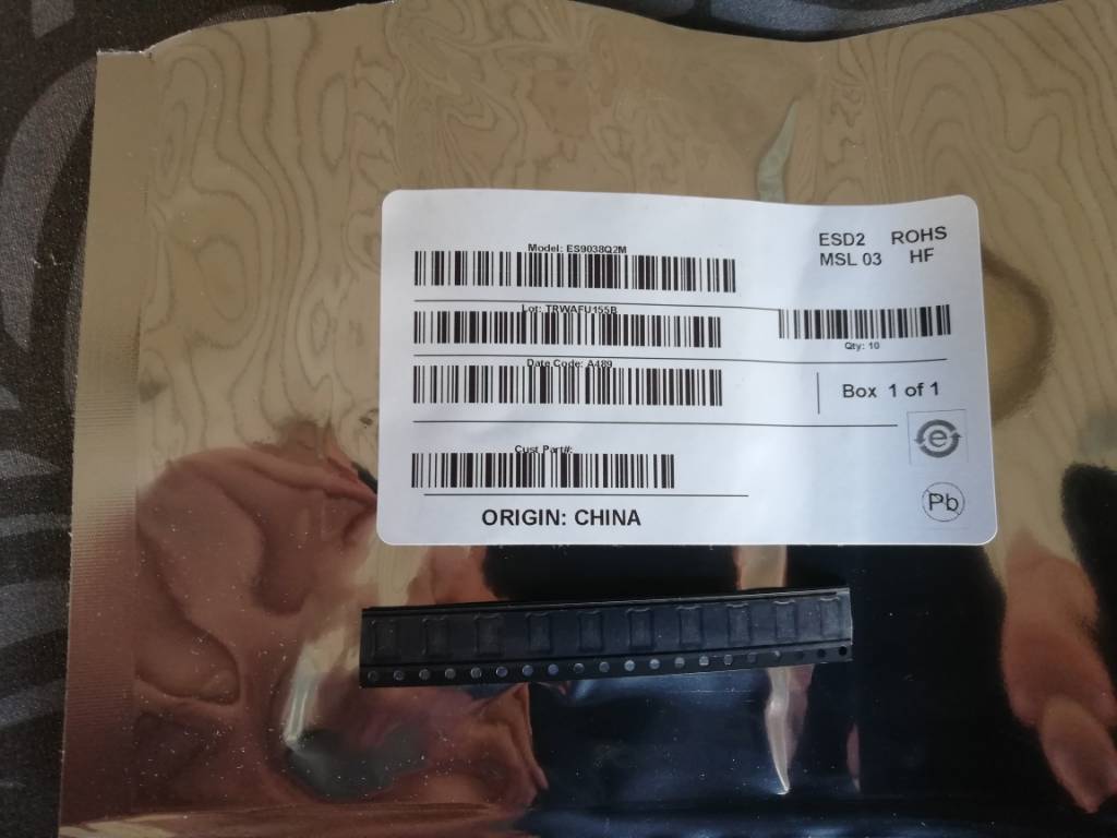

I have 10 of those es9038q2m . I am thinking of build 10 USB dac with those and keeping 2 of them. Should be very simple. Board will be identical to the AK4493 with 4 extra pins for reference voltage to run them in current mode. That would require a new shield board. But it will also work very well with the present output shields.
Crystal should be good so I will add a cchd-575 100Mhz. Reference voltage will be made with lt3042.
I have tested on the es9038q2m and es9038pro and they can replace src4392. So even if es9038q2m and cchd-575 is more expensive then I think the price will be the same. IMG_20201010_172155.jpg
