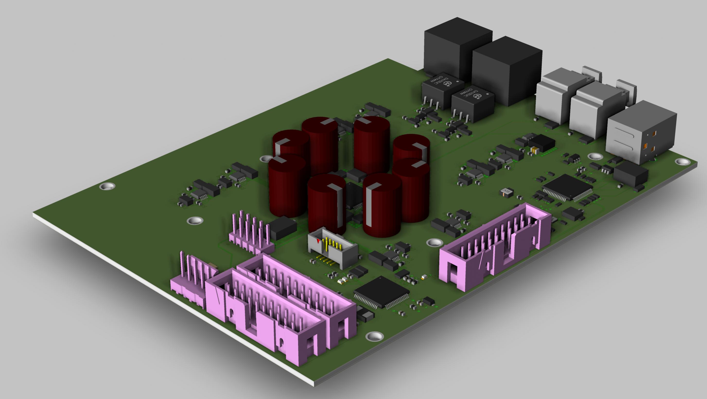

In the light of AKM is out of the game, i have made this new board. It is actually a version 2.
Now this is a ES9038PRO board. The existing output shields can be used or a current output shield can be used instead, the gain modules are the same.
It has 2 optical, two RCA and 1 USB.
I have used weeks in optimizing the PCB around the DAC actually the complete board.
It is in the press. First boards arrive next week.
So for a beginning old output shields can be used on it and later upgraded.

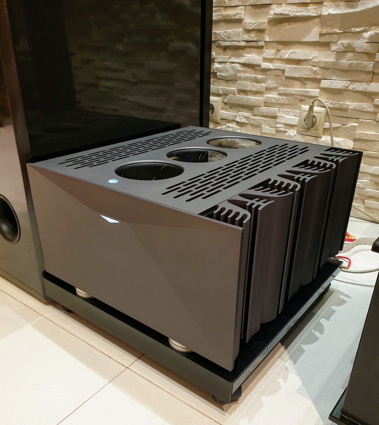

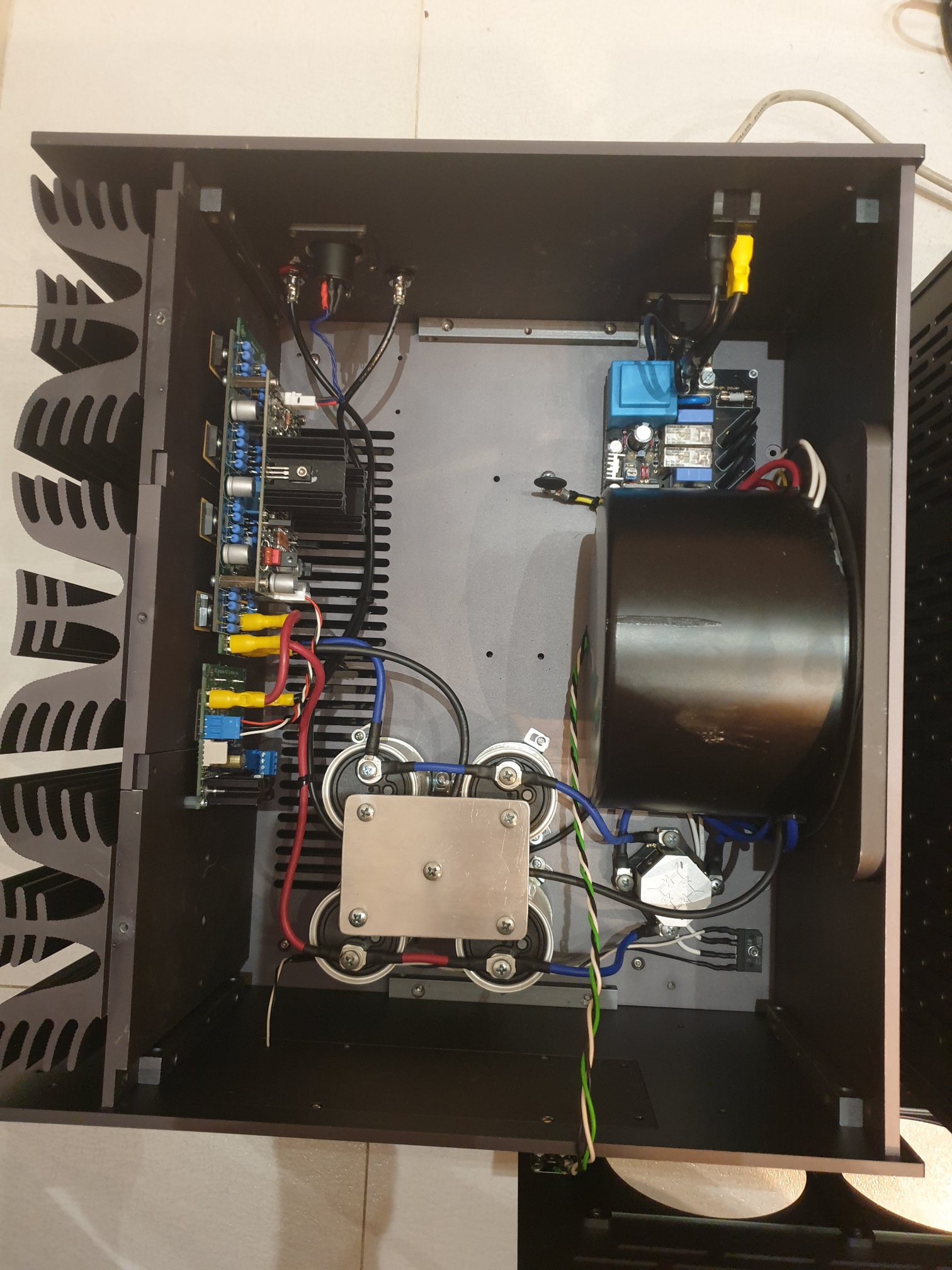

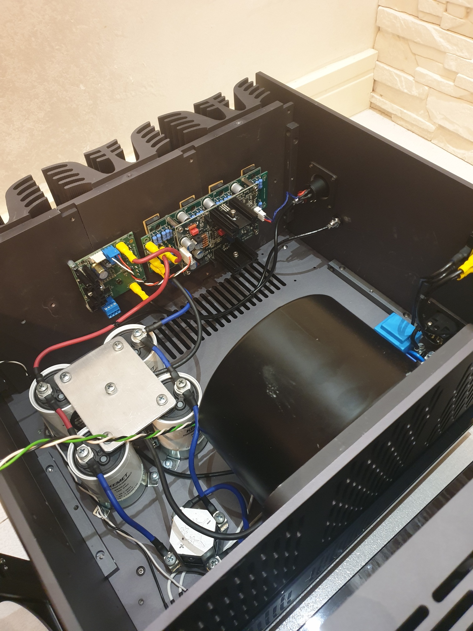

I am very happy that I finally managed to finish this project with Sonny's TSSA V4 amplifier. I made a dual mono variant, with 2x52VAC / 1000VA transformer, with RIFA PEH169 capacitors. These modules were bought some time ago and I tested them with the classic + 50VDC PSU. They sounded good, but not so much that I thought of finalizing them in a case. But after an accident, I fed them with - + 72VDC and I was very surprised by what I heard.
I don't have the talent to describe the sound, but I can say that it beats any amplifier I made in class AB (some of them are Goldmund 9.2, Telos 400, Accuphase 701)
Very detailed, huge dynamics, fast bass and fist, I just love it.
I would like to thank Sonny with all my heart for all his products and for all his help over the years. He is a great talent and I am very happy to have met him through this forum. I wish him good health and I hope that we will hear from him wonderful things in the field of audio.
