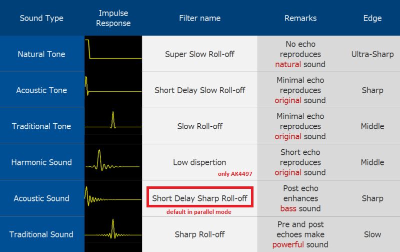

Just found this: AK4490EQ Filter adjustment - Gieseler Audio - StereoNET
I'm agreed with that:
"I was expecting "Minimum delay Sharp Roll-off" (Minimum Phase on the M-DAC) to sound the best, but instead it was second worst - quite glary and aggressive sounding, although very sharp and detailed. I suspect this is due to the very severe post-ringing of this filter type (far worse than even a brickwall filter)."

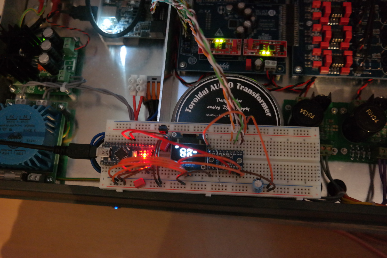

just a question, because of I began with the controller setup (Arduino nano).
I've studied your code "AK4490_STM32F-v1.35" and do not understand one thing:
the chip adress code (e.g. 0x13) must followed by an eight, R/W bit. That is not the case in your code (e.g. by the "ReadRegister", "WriteRegister" objects). Does it functioning indeed, or I am wrong?

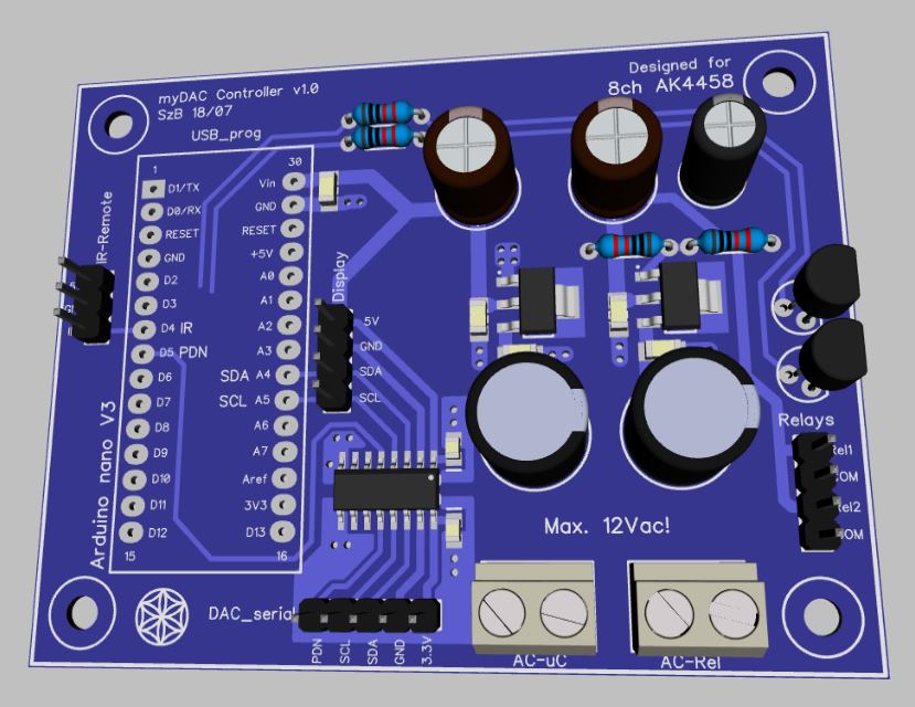

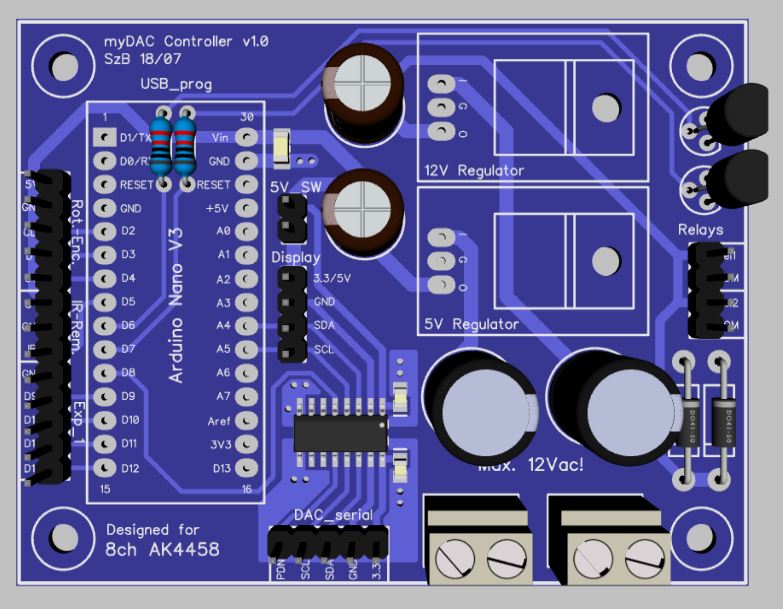

Hi, I have PCBs for you if you wish, but without IC. The DAC can be ordered from DigiKey only, they have a free delivery from 50€ (below that 18€ shipping!!) I think.... So you should order with other components together, so makes it sense...
