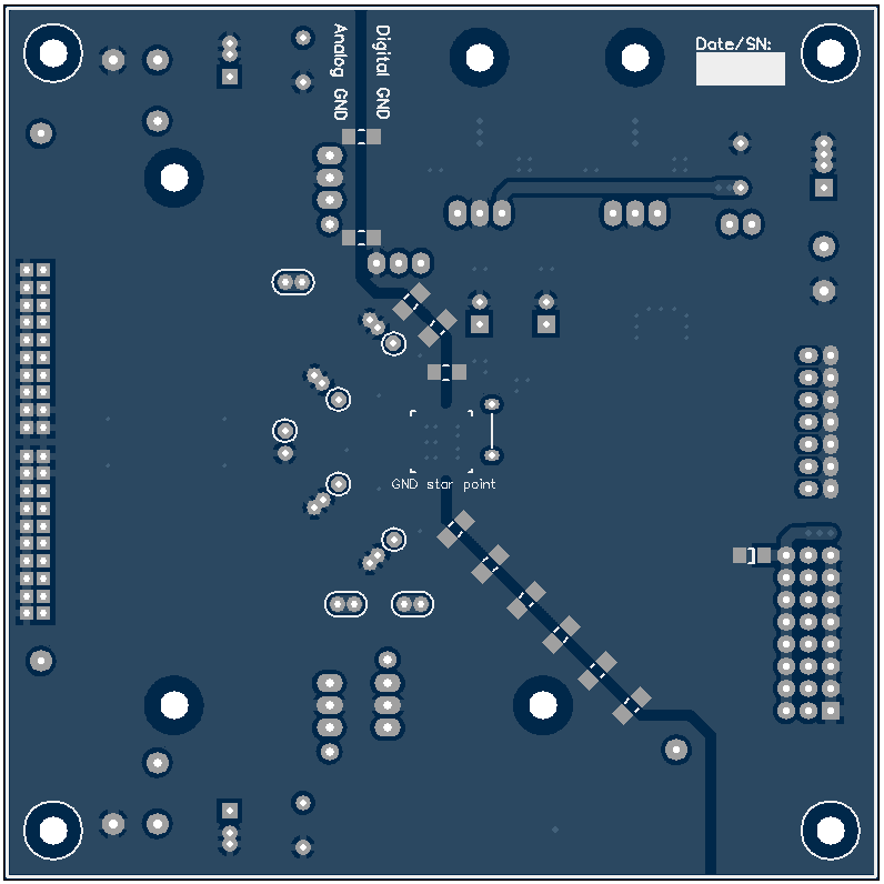

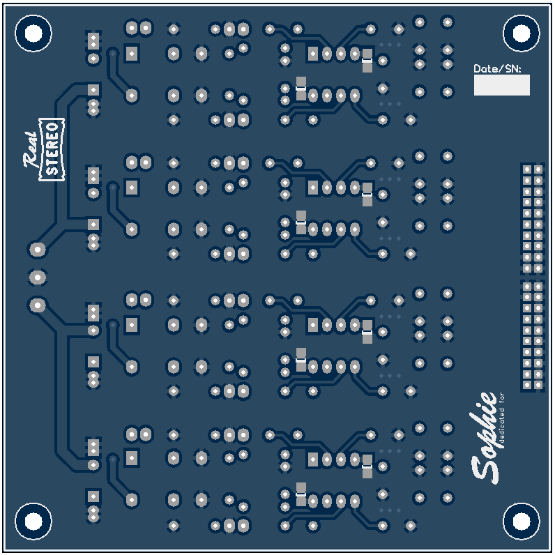

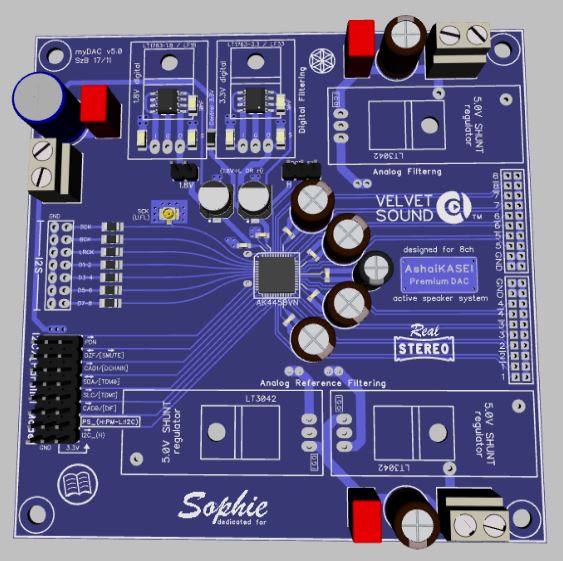

So, I have made as I find it right...
The big bypass capacitors (10-100uF) have separate traces to the GND connection point. The small caps (10-100nF) near the OPAs are connected to the copper pour on both side. I didn't find a separate way for them. Some top-bottom GND vias must be still placed perhaps.
The lower side (for Ch1-4) must be simply mirrored...
At the first I do not plan to use the on-board regulators (I have external ones), will simply short them.

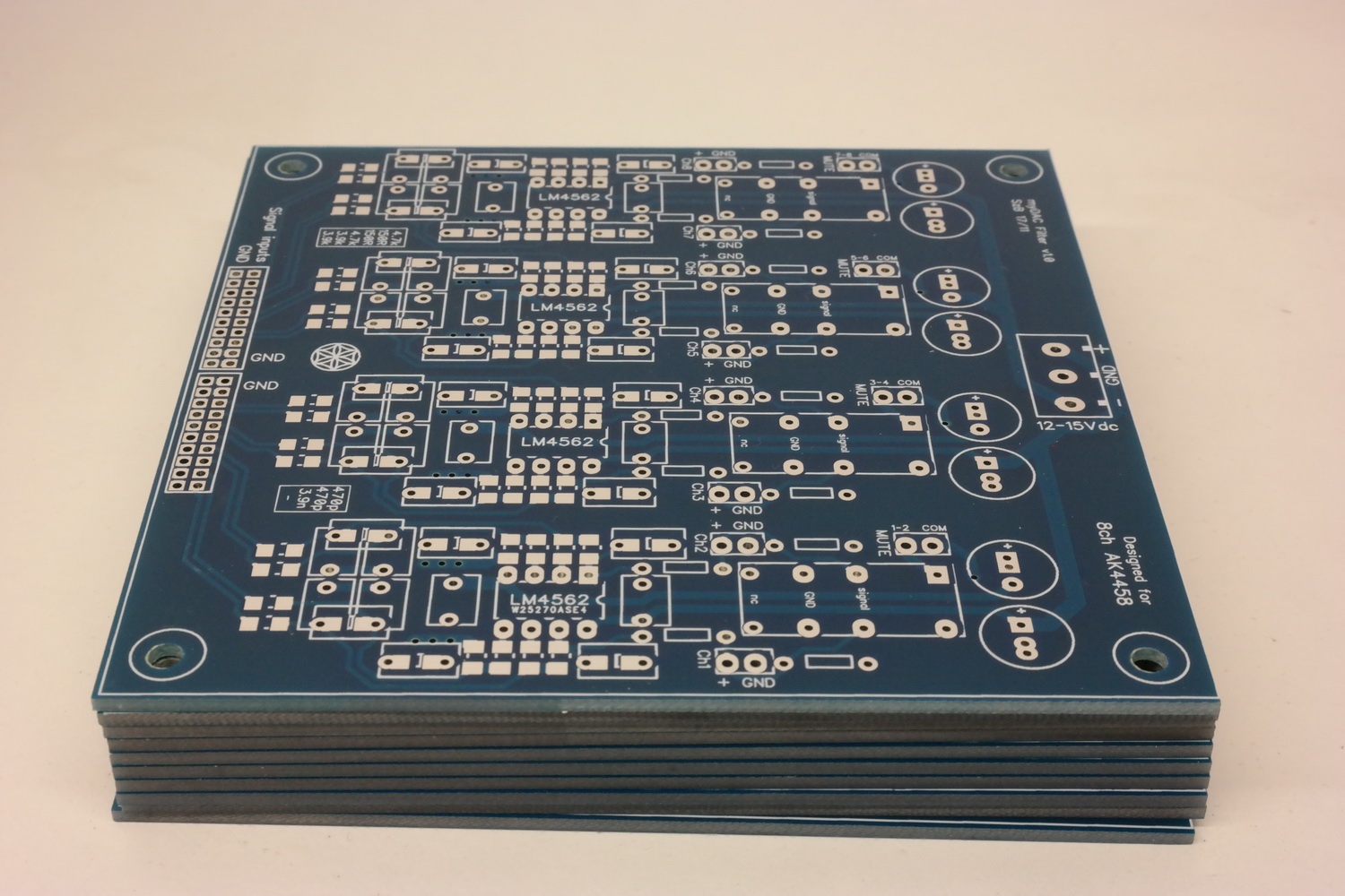

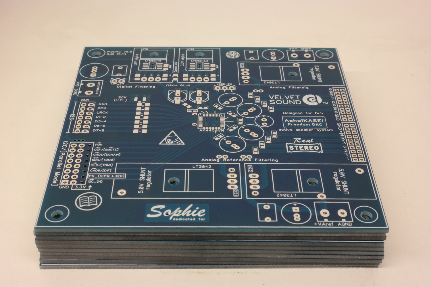

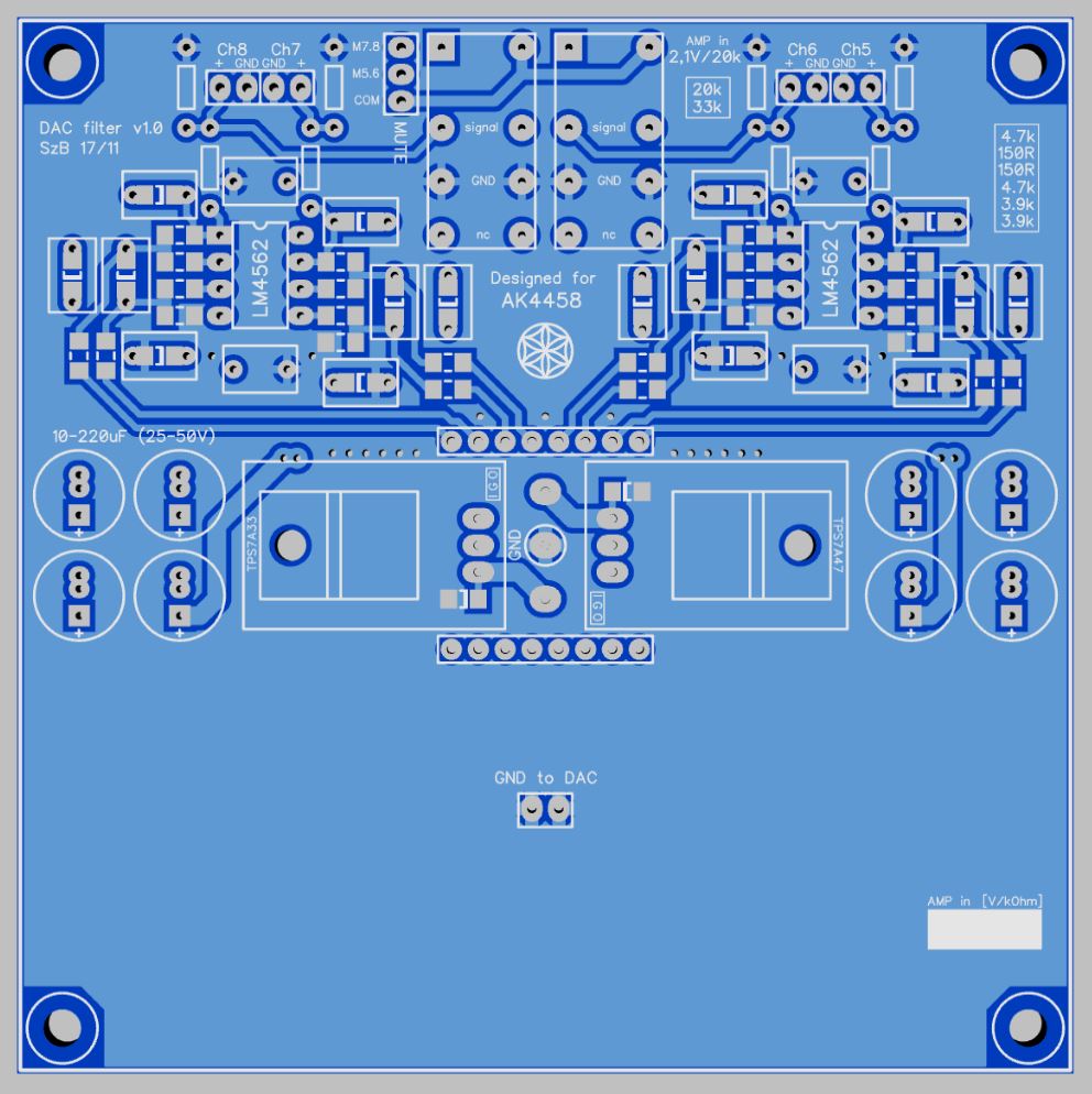

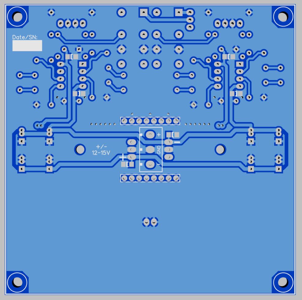

Slowly but surely...
The filter pcb with only 4 channel and without copper pour yet (soon will be finished)...

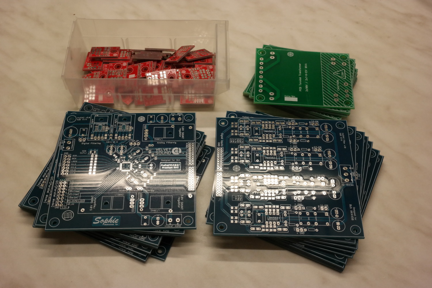

I`ll order 10 pcs. from each pcb. Will somebody get from that?

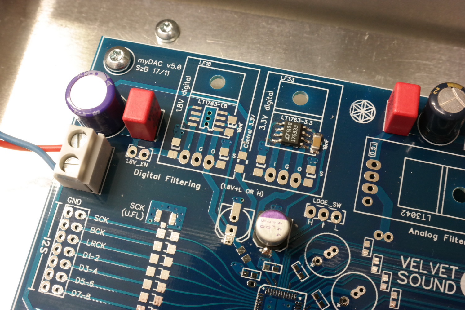

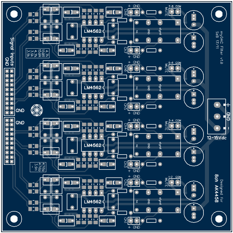

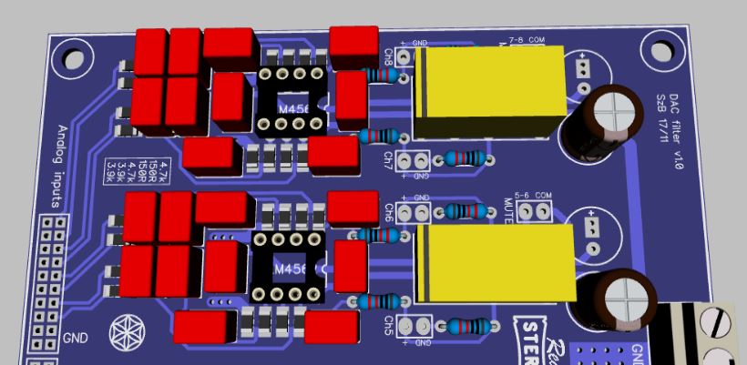

I've completly redesigned the DAC and filter boards. I've left the stacked arrangement and made a new side-by-side concept with revised signal and power supply line paths...
I don't have a precision measuring equipment, so I can't deliver exact measurements unfortunatelly...

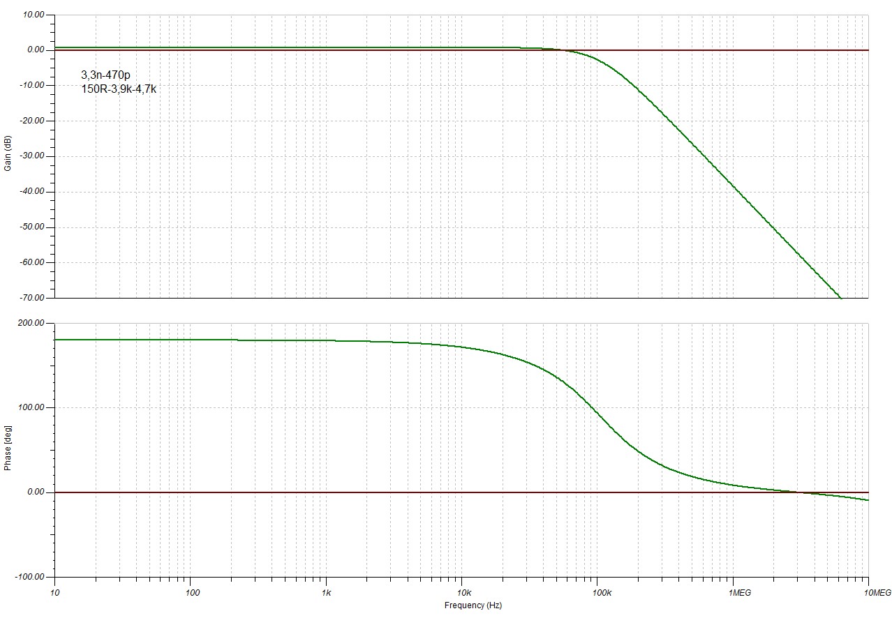

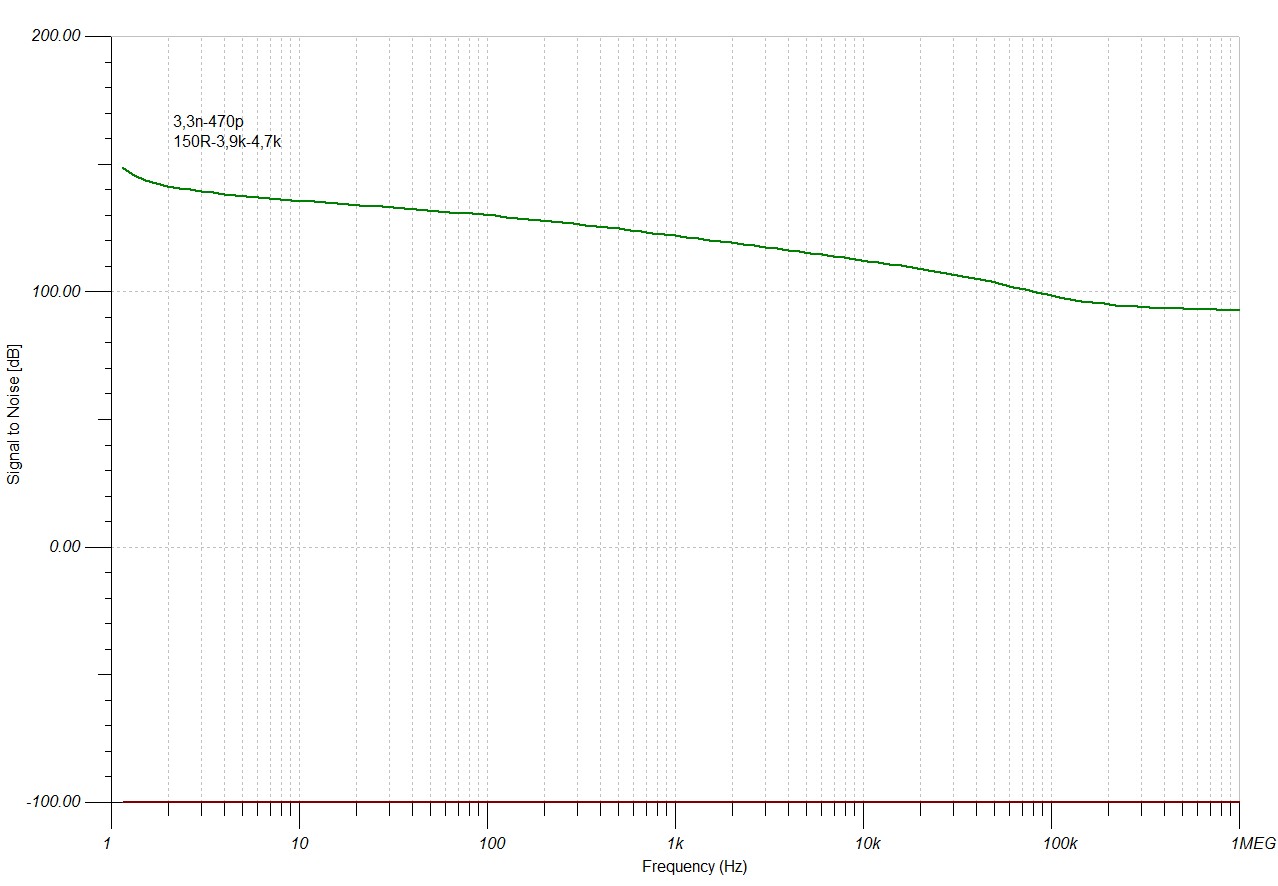

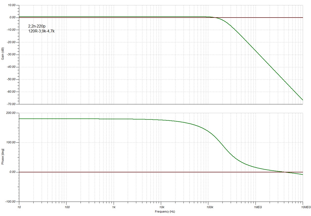

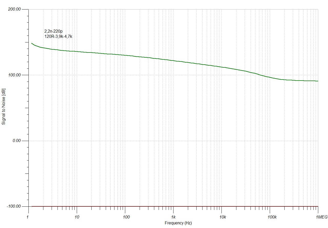

I'm not sure witch filter should I use. Is it enough a 2dn order with about fc=200kHz (2,2n-220p-3,9k-4,7k-120R)? (opa is an LM4562, 55Mhz)
Hi Marcel,
I've ordered 10 pieces because of minimal ordering amount.
But if you wish, I can send a set of pcbs for you. Or did you meant complete, soldered panels?
Unfortunatelly I couldn't finish mine yet, I'll receive the DAC IC only at the beginning of April...
