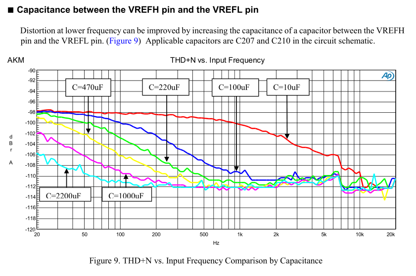

What do you think about the big Vref capacitors? Are they really necessary if the regulators are placed close to the DAC on the pcb?
The attachment is for AK4490. Also take a look at the notes on page 78 of AK4458 datasheets.
"Power lines of AVDD and VREFH1-4 should be distributed separately from LDO and etc. while keeping low impedance. If it is not possible, it is recommended to connect a LPF composed by a 10Ω resistor and a 220uF capacitor between VREFL1-4 and VREFH1-4."
I know this magic curve, but datasheet says that these are needed if the regulator is far away from the IC....

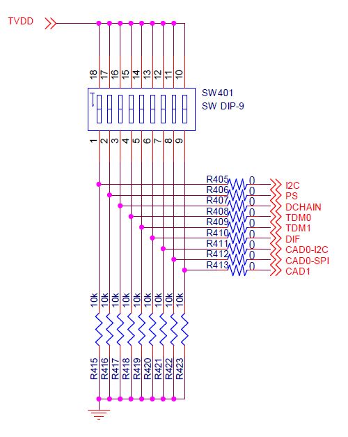

The idea is to never leave a pin "floating", i.e. not connected to anything. So a pin should be connected to either gnd or Vcc.
However, if the pin is (or could be set by software to be) an output pin a resistor is a good idea to protect the pin from overloading in case of a fault or programmer error.
Of course, there are always exceptions to these rules. For example, if you look at your datasheet you will probably see that certain pins can be left floating / unconnected.
