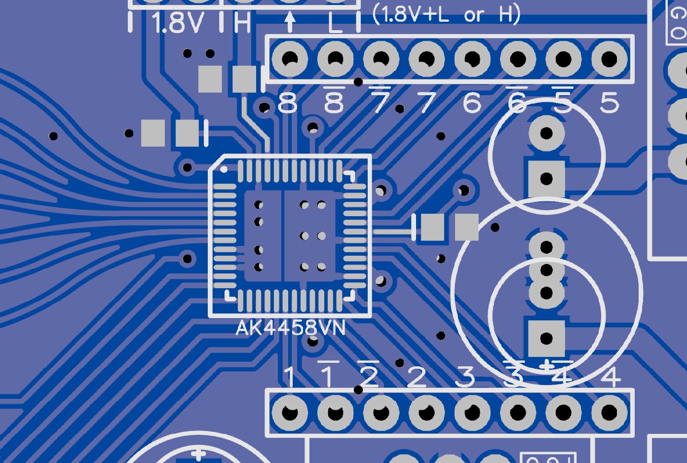

Transmission line impedance and termination goes together. The main reason for termination is to compensate for impedance mismatch and suppress resulting signal reflections which cause increased jitter and bad signal quality. As this board is double layer only your line impedance isn't near 50R at all at this trace width.
An easy tool for calculations is the Saturn PCB-Toolkit:
https://www.saturnpcb.com/pcb_toolkit.htm
For the local decoupling caps, get then as close as possible to the chip and disable the thermals for them.

Ok, thermals can be disabled by smd-s.
More nearer I can not place them, 1-2mm does not mean anything anyway...

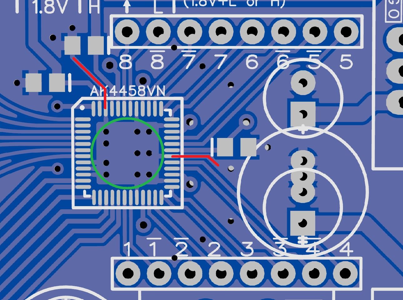

And what about the added red earthing connections?

1-2mm means 1-2nH inductance.
For the red grounding, draw the full power patch from the cap to the IC. This means Cap+ -> IC Pin+ -> IC GND -> Cap- ...
You want to have the smallest loop (minimized loop area within the loop) with least inductance.
If you can't put these caps in parallel to the 2 pins, the positive side should always face to the IC, like actually done.

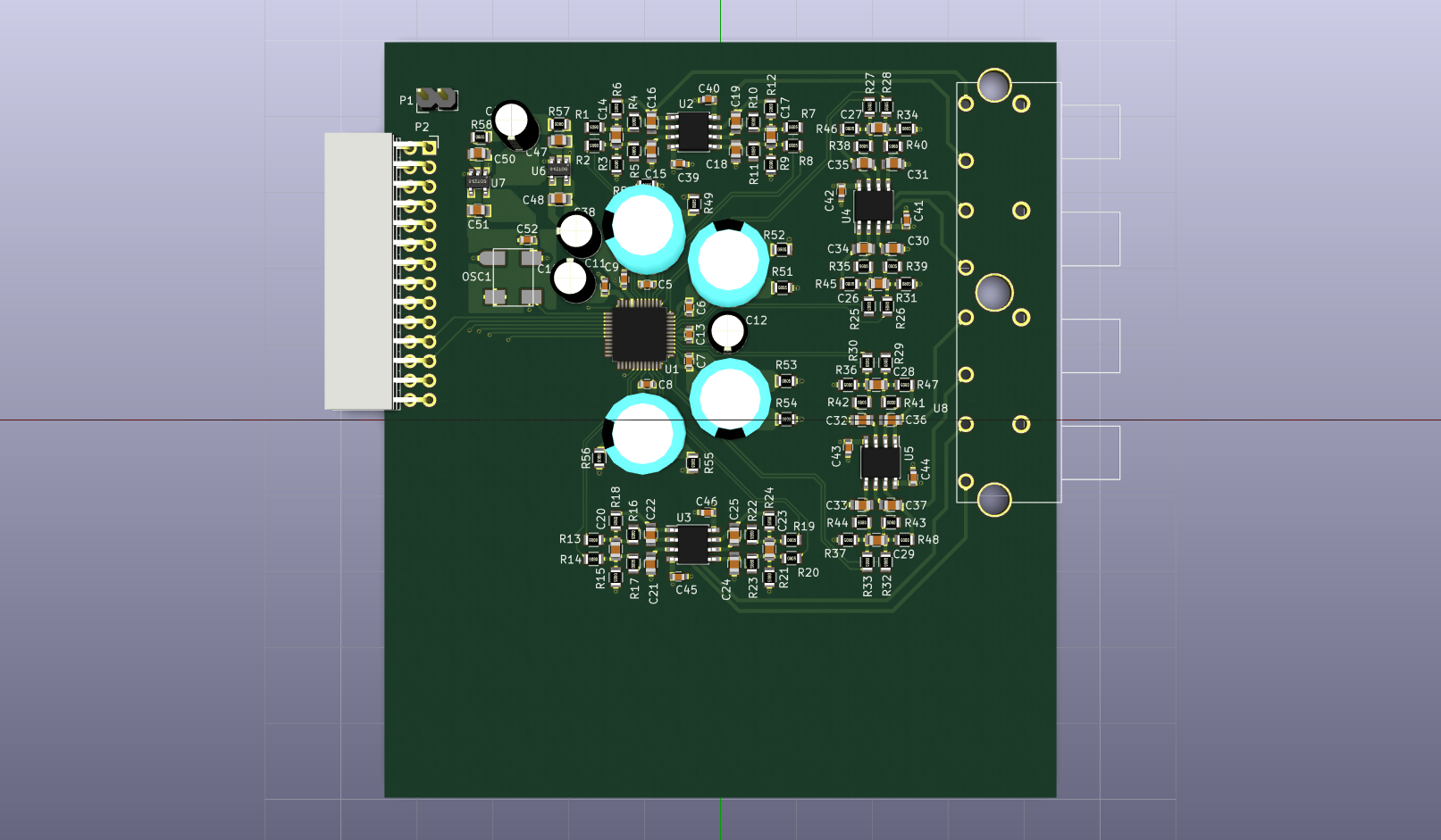

How come you only have one oscillator? Do you intend to only use one "family" of sampling rates?
This was designed to work with ADAU1452 with built in ASRC.
I need to add terminating resistors and a clock buffer IC because now it feeds directly two IC's from the clock.
Super...🙂
Can I know something else about your design? I have a lot of question....
Schematic maybe?
What OPAs do you use?
You have planed only unbalanced outputs or?
I see the clock and and TVDD regulator (what type?) but for the analog side nothing....
You are using the internal 1,8V LDO or?
How do you connect the control pins? Under the IC are some vias?
2 or 4 sided pcbs?
2 or 4 sided pcbs?

OPA NE5532 or any dual. Only unbalanced.
Electrolytic bypass also missing on OPAMP's.
TVDD and clock regulator LP5907. LT3042 x 2 will be used for analog supply and VREF. Internal regulator is enabled.
TPS7A3301 and TPS7A4701 for OPAMP's.
This is a 4 layer PCB. Control pins (I2C, PDN) will go an on a 4 pin header. Serial control mode.
I will upload schematic as soon as I can and pics of the PCB layers.

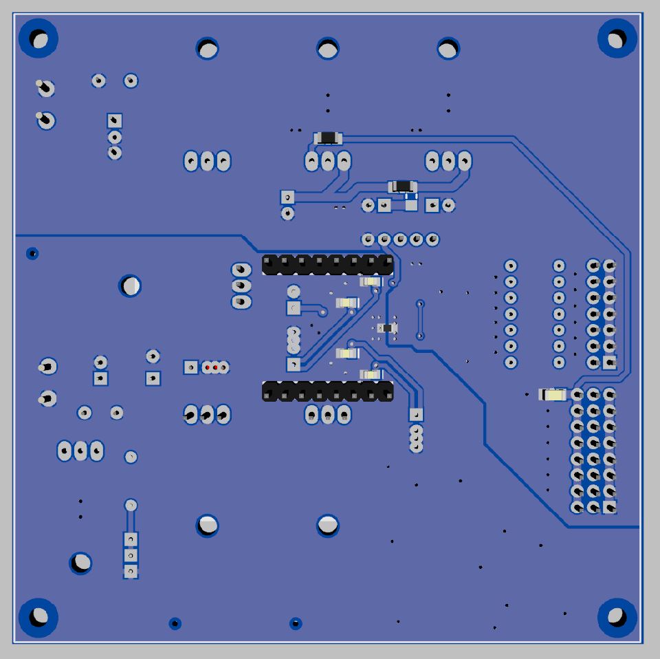

You should try to make this an a 4 layer PCB. It's not difficult and the price difference is small. Mine is 10cm x 10cm.
