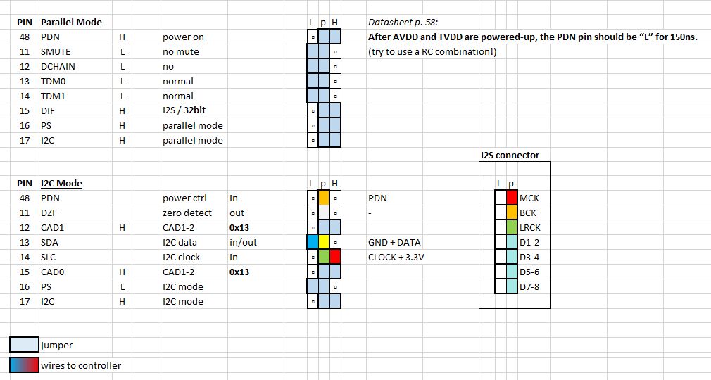

Some questions:
I will use pga2311 for volume control, and I'll have +-5V from linear regs, that are dropping it from the +-15V of the opamp linear regs. Can I use the +15V for the +5V reference of the Vref lines and +5V for AVDD? I still have a spare 9VAC line that I was thinking to integrate into the DC/DC converter along with the other one. The opamps are running light so there shouldn't be much load on the +-15V lines. All four pga2311 would draw around 80mA on the +-5V lines combined.
I still haven't looked at the clock part of the circuit, so I'll sink some current into extra parts used for that. That other 9VAC line would come in useful for the dc/dc converter used for the digital supply.

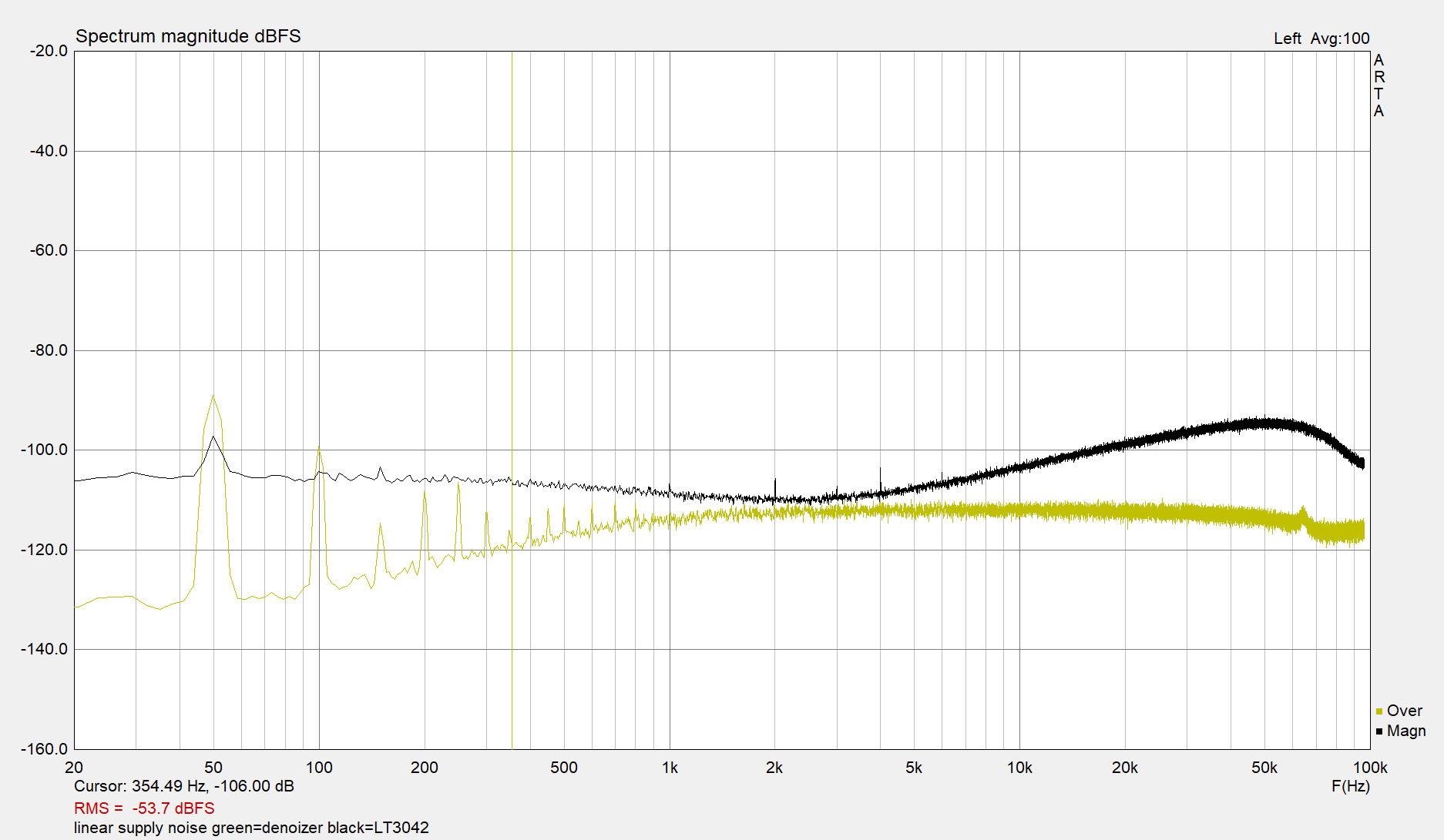

Ok, maybe they are on par, but the nonoizer circuit should perform better. I already have all the parts, it's practically free.

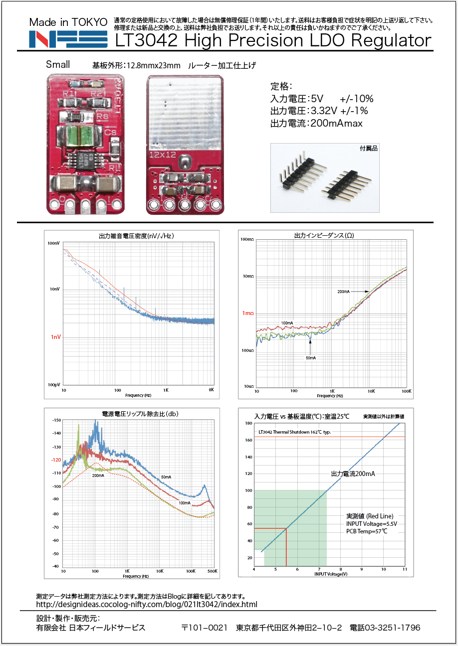

Trileru, I'm not convinced, sorry.... please calculate the noise in dB for the LT3042: 5V to 1uV! -133dB or? It is far enough for the AK4458, and for the better DACs too. But it's your life, if the LM317 makes you happy then go on....!

This is not about convincing, this is about numbers/measurements. There's people that have built and measured it and it measures better (nonoiser). What you do with this information is up to you of-course. I'm not trying to convince you of using it, or anything else. I was justifying why I'll use it.
That's the issue for me with lt304x, I have to order it from other places, money piles up, then I have the free stuff laying around for similar performance.
