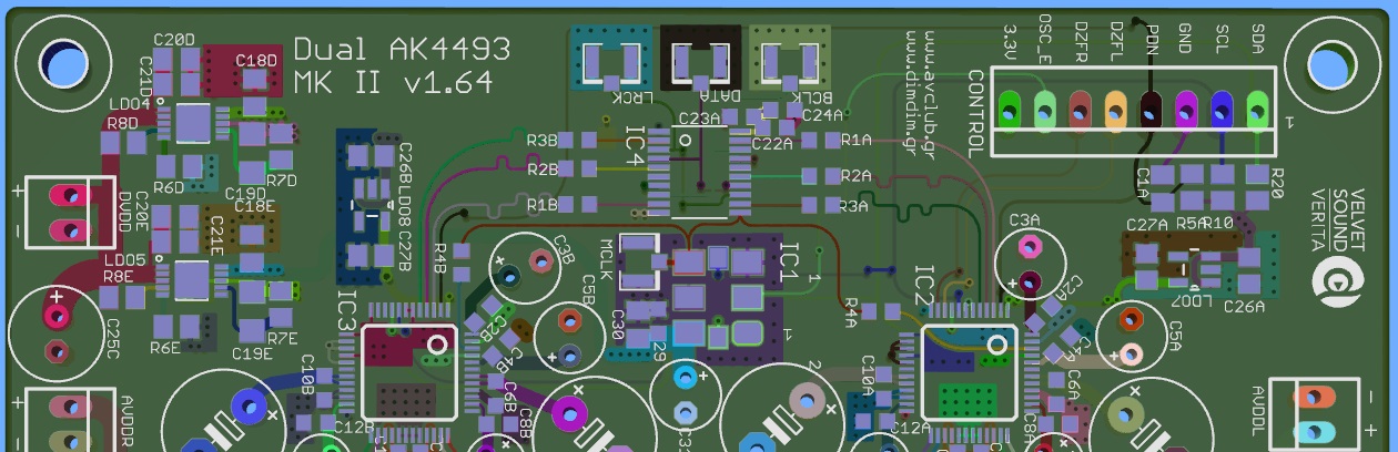

Zarandok,
Very nice project! Do you have plans for adding i2S isolation and flip/flops?
I guess the miniDSP i2S signal would benefit from it, as it is considered to be somewhat noisy in the I2S and not very well timed...?

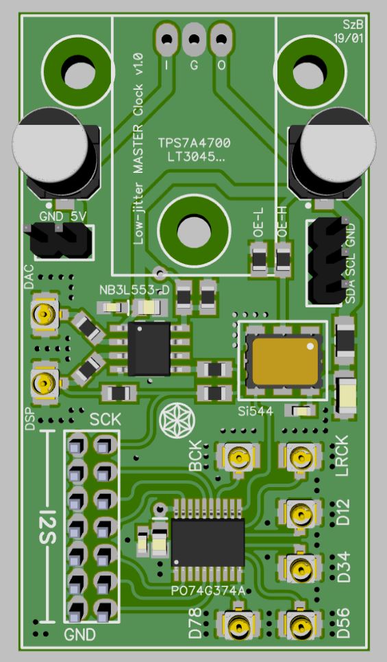

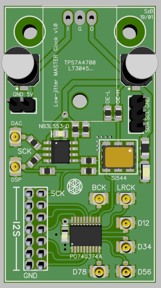

Thanks! I am considering at the time another layout with Si570 (I2C controlled programmable oscillator) and flip-flops. But I'm not sure that should I use rather single flip-flops (e.g. 74AUP1G79) or a 8x (e.g. Potato PO54G374A)...
Zarandok,
I used single flip-flops on my original AK4490 but my Rev.2 (Dual AK4493s, PCBs are in the fab. 🙂 ) will use the Potato part. It should easily outperform the 74AUP1G79s. It makes for a cleaner layout too.
attachment.php
Btw, I'll also be upgrading my Si570 to an Si544.. that should also be interesting.
Very nice, thank you! You have take care about the trace lenghts too...🙂

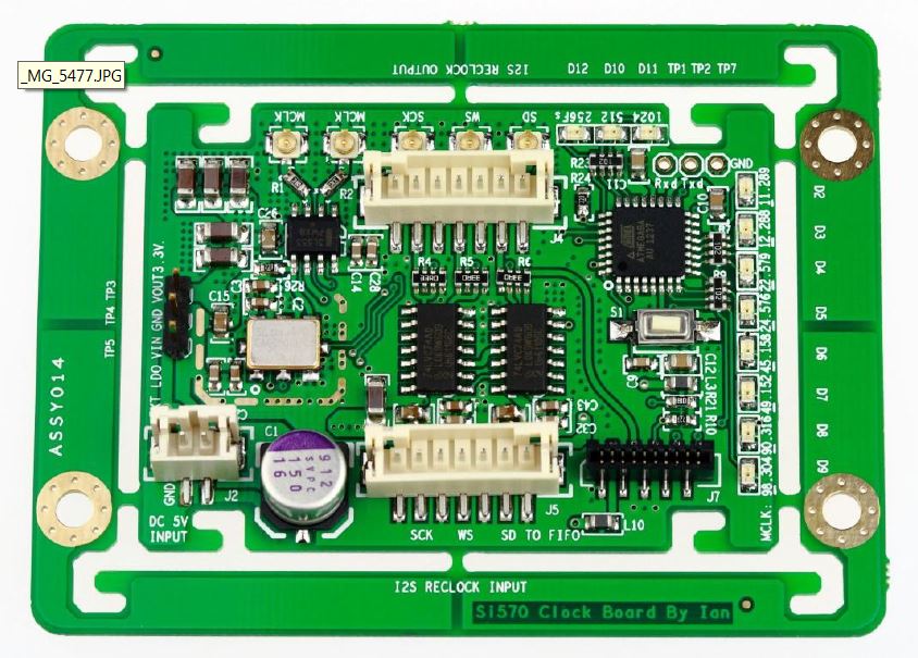

One question: you are don't using a clock buffer, the DACs and the output MCLK to the receiver are directly connected to the clock. What's your consideration about that?
So it is only all about the current supply capatibility? I thought it has some other reasons, e.g. isolating devices and minimize the interaction between them.
Ian uses clock buffer, that's why I asked...

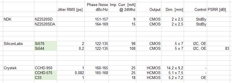

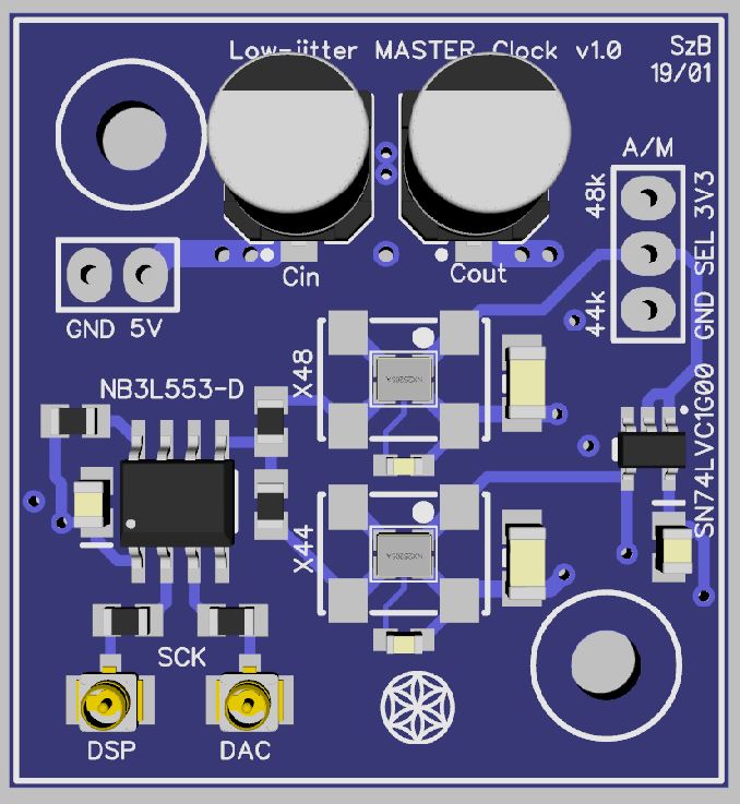

CMOS (or even better dual CMOS if you can find it - you might be able to omit the clock buffer if 2 outputs are enough for your use case).
If you don't need to be able to enable/disable the Si you can leave the OE pin floating (its internally pulled high or low so as to keep the Si enabled).
I'm considering what other clocks can be use with my Si5xx footprint, perhaps design an universal pattern. But the NDK clocks are simply too small, unfortunatelly not possible if I don't want to get a short with the bigger 6 pin examples. Alternatives are the Crystek C33xx and CCDH-575 models, they have about the same size, but only 4 pads.
The Si clocks have relativ high phase noise, and are sentitive to the power supply (experience of Ian) regardless to the good PSRR value. That's why I thinking about alternatives....
