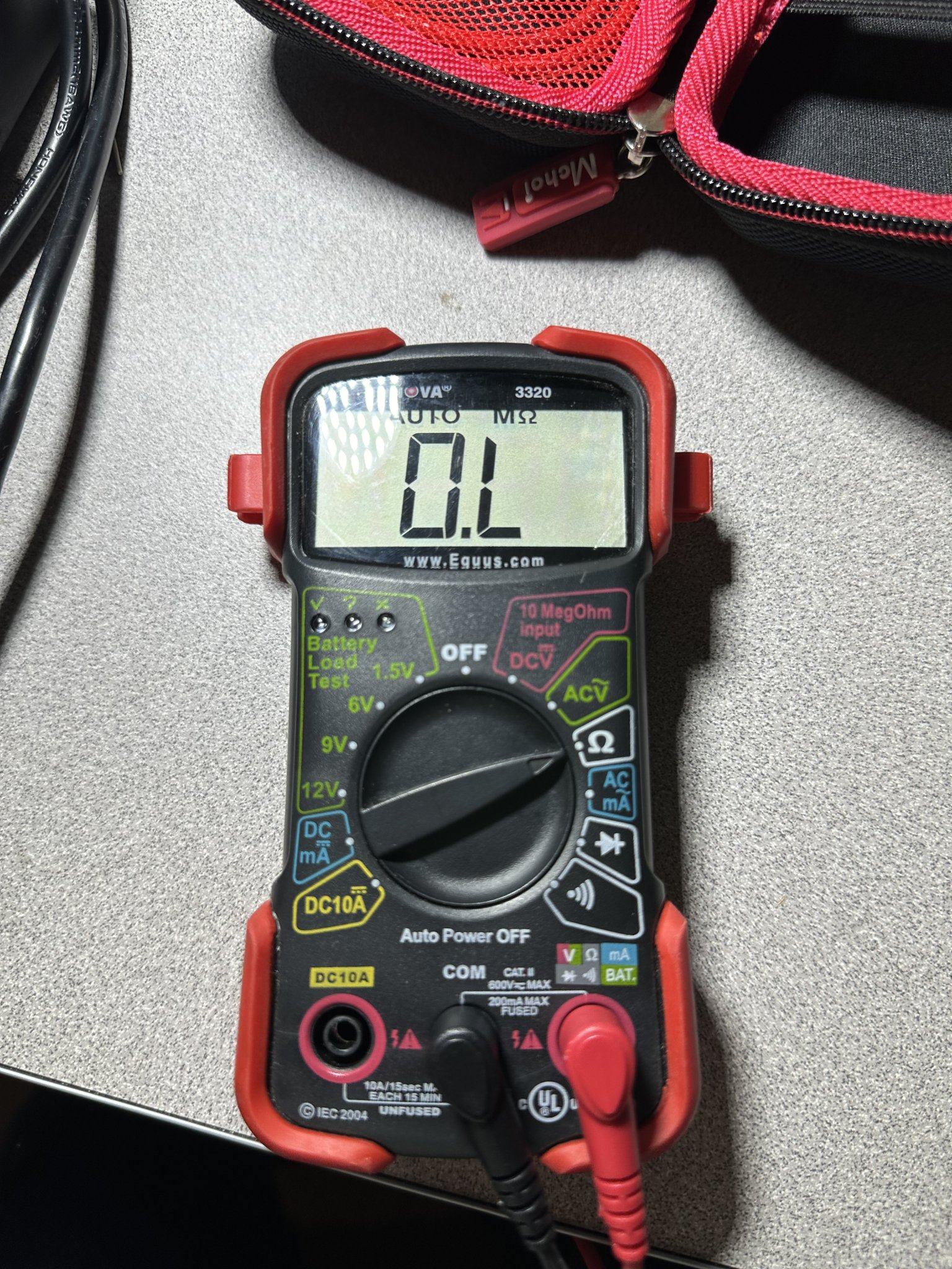

I have an auto multimeter as well, both multimeters showed nothing on either polarity

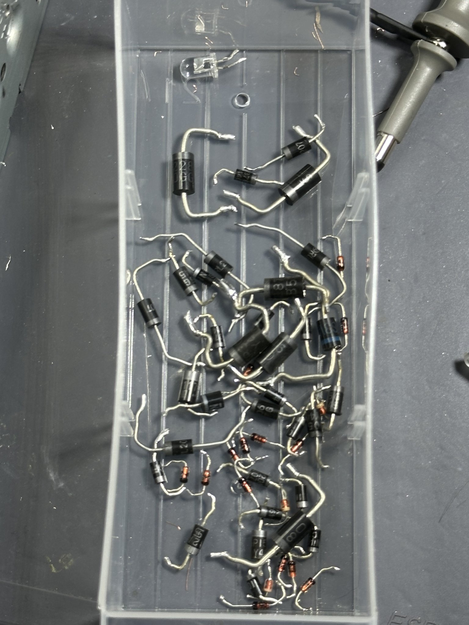

These are the other diodes I have, not sure which I could use

I meant to say this earlier but 'showed nothing' isn't very meaningful and could be misinterpreted. When you give a meter reading, give the mode and the exact displayed reading (all digits).
If the meter reads the same as with the probes in contact with nothing but air, say it's an open circuit.
Check your meter. What does it read on resistance if you hold the probes together?
Auto-ranging or automotive meter? The meter you posted earlier (post #46) isn't auto-ranging.
When I say “showed nothing” I’m referring to open circuit, sorry about that
Yellow meter reads 0.002 on the 2k ohm setting when probes are put together
This is the second meter I have
Auto as in auto-ranging
Reads 00.0 when probes together

Not really sure what you mean by that. Where would I put the positive probe? Also can I see if the diode is leaking with continuity? As in it would allow continuity one way and not the other, and if it’s leaking it would show both or neither?
I think D713 is leaking as well as on the diode setting, it showed >1 one way and showed .801 the other way
D716 read .885 and D712 read .875, both only showed in one direction (other way was open circuit) if that is useful
