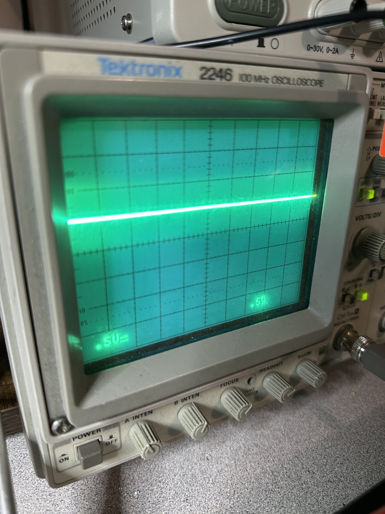

Aiwa CDC-MP32 Headunit Unresponsive

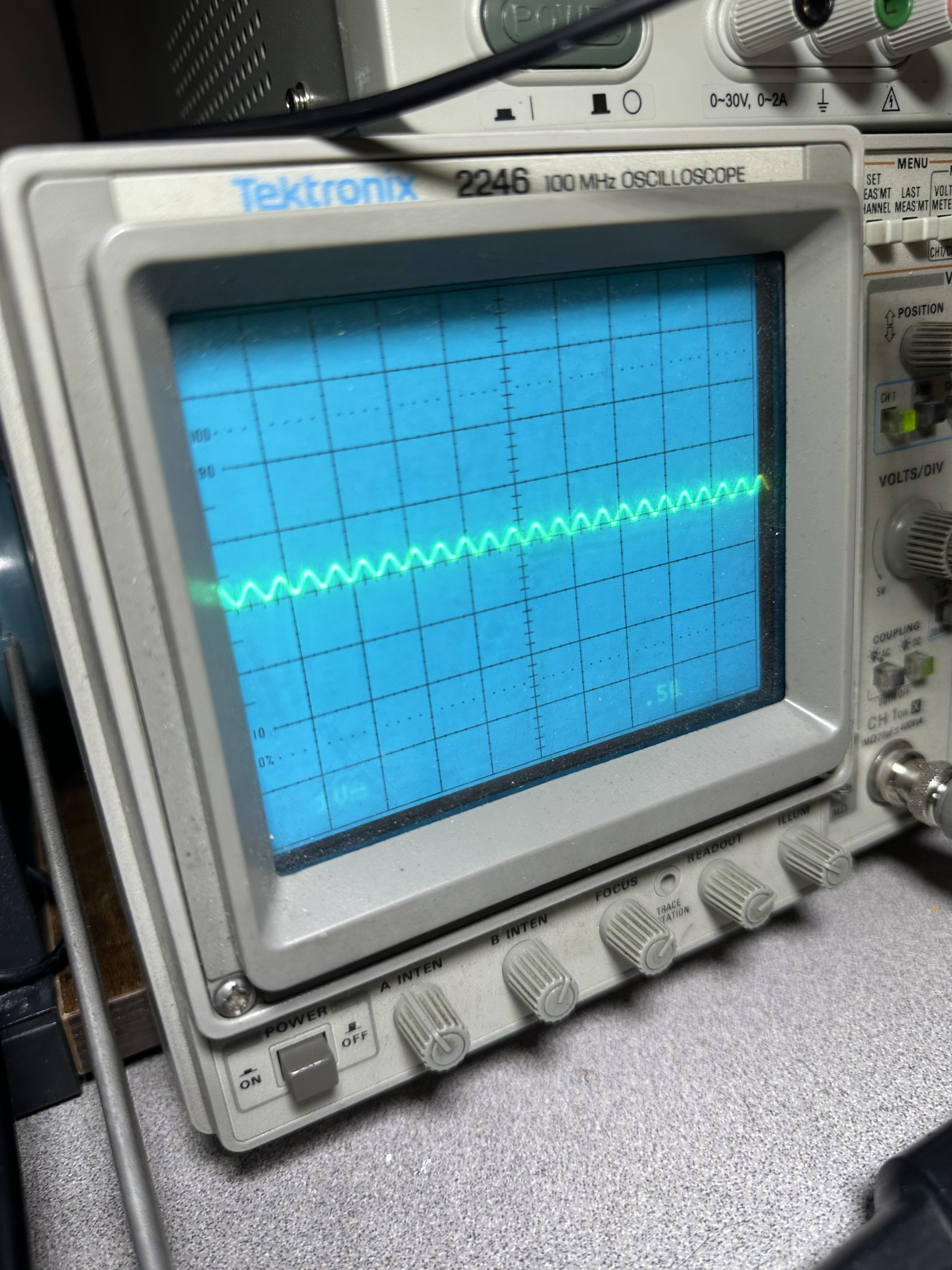

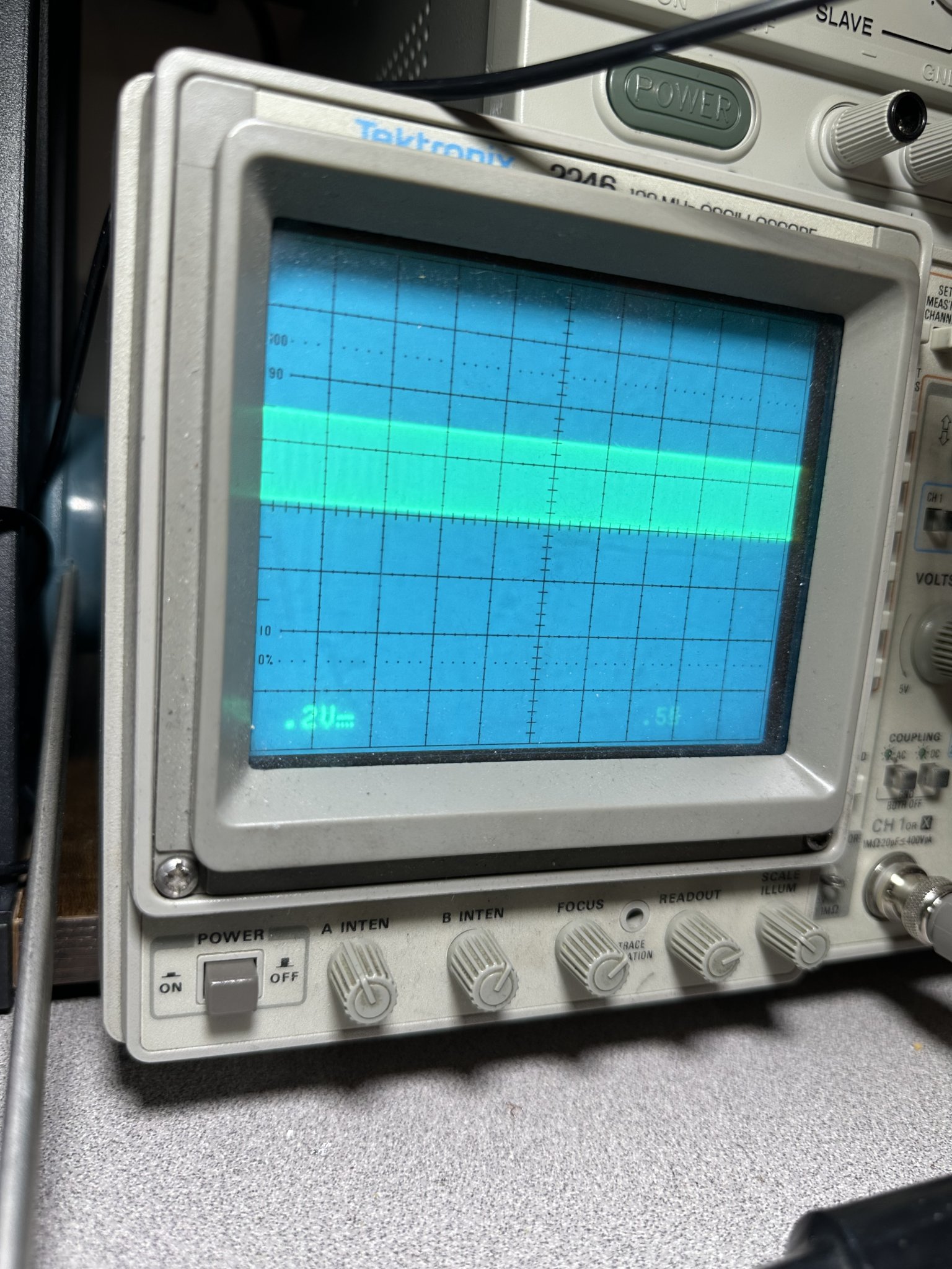

.5v both sides
X901. Metal can (stadium/pill shaped) on the top of the board, terminals on bottom.
Probe must be on 10x (unless you have a 100x probe). The oscillation is fragile and the loading of the scope is sometimes enough to stop it from oscillating. This is inconclusive but there aren't many tests left.

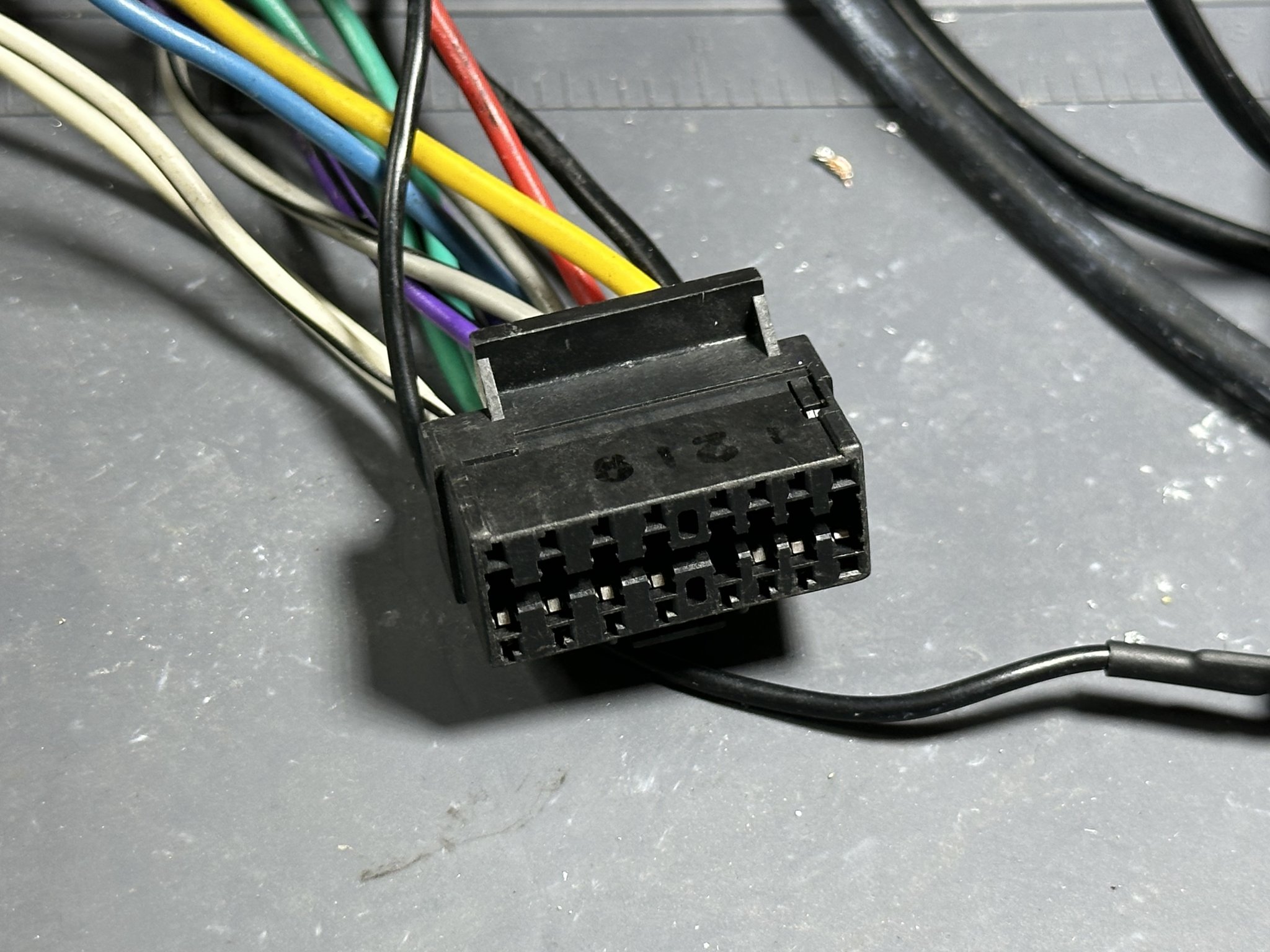

This? Or do you mean the terminals on the board where this connects

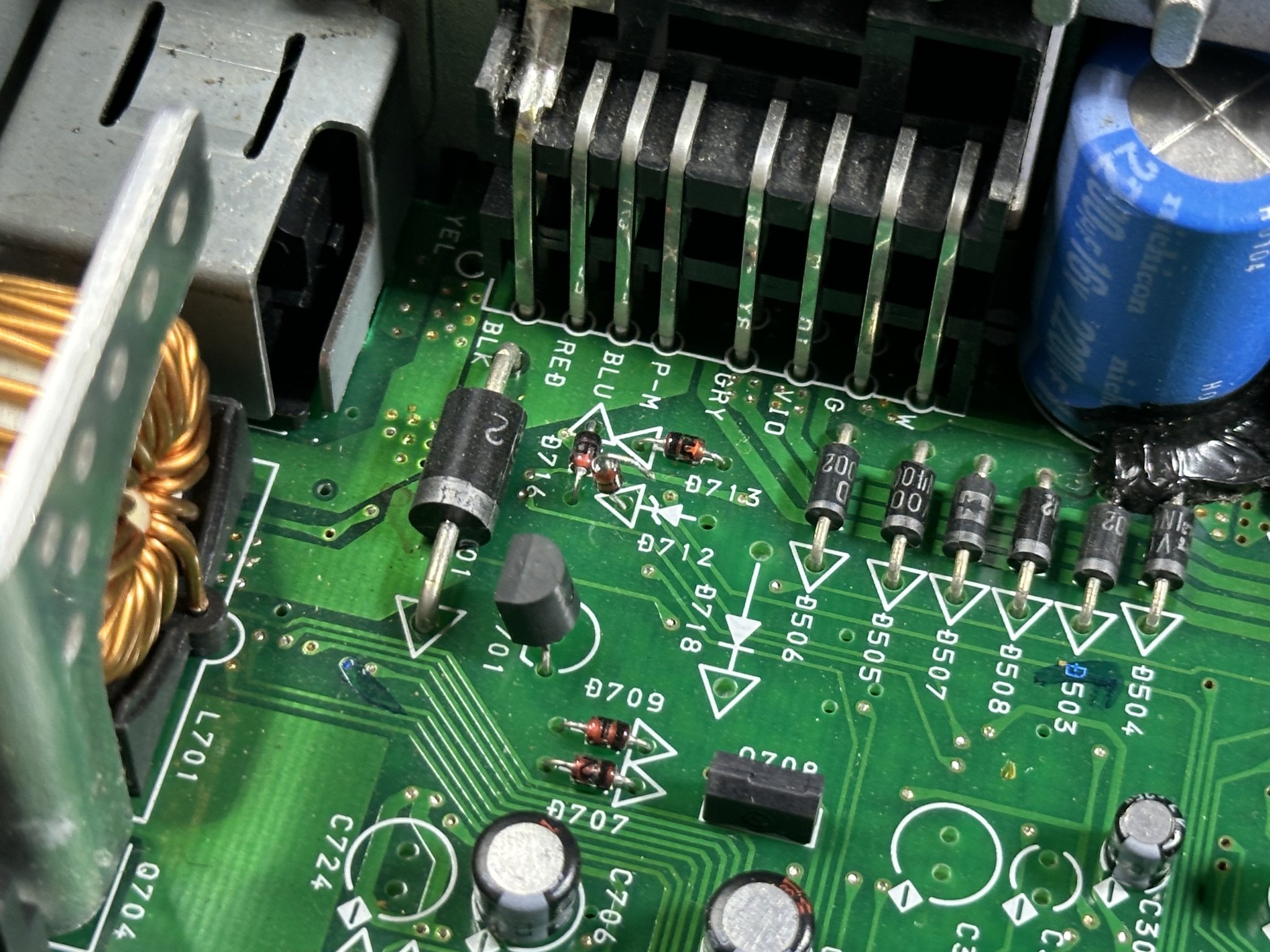

If it’s the connector, accessory and power both have 12.07v
Corresponding terminals on the board have 12.05v
