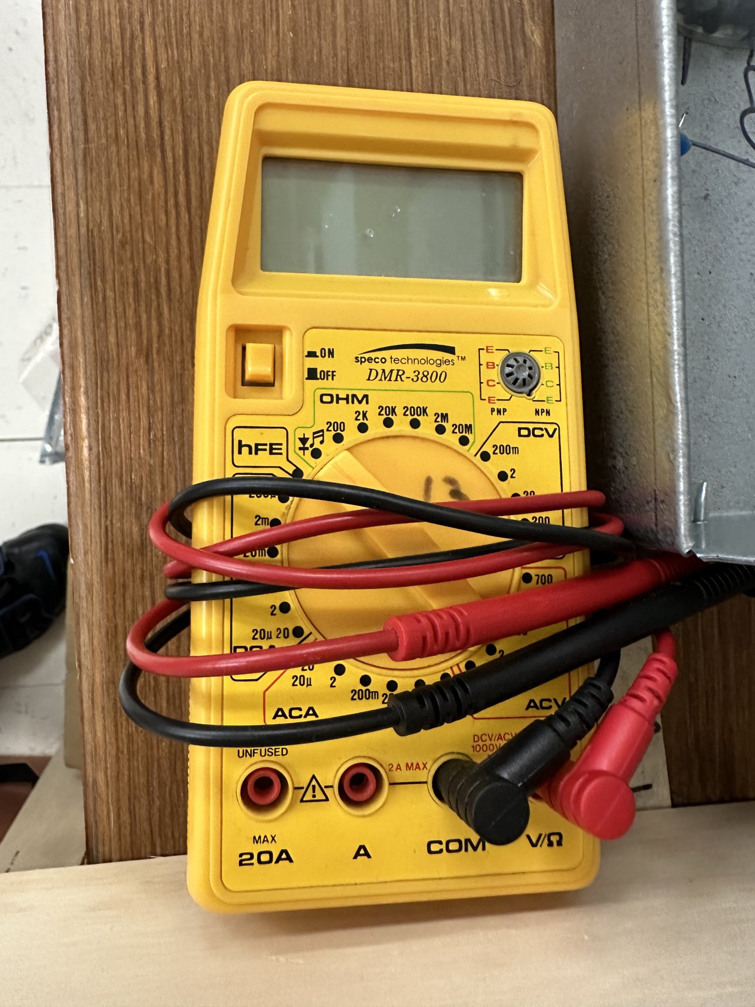

This is the only other one I could potentially have access to, would it be worth trying to borrow it?

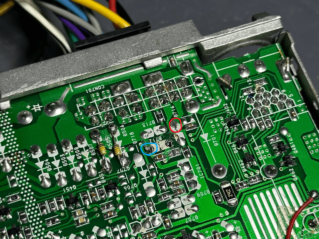

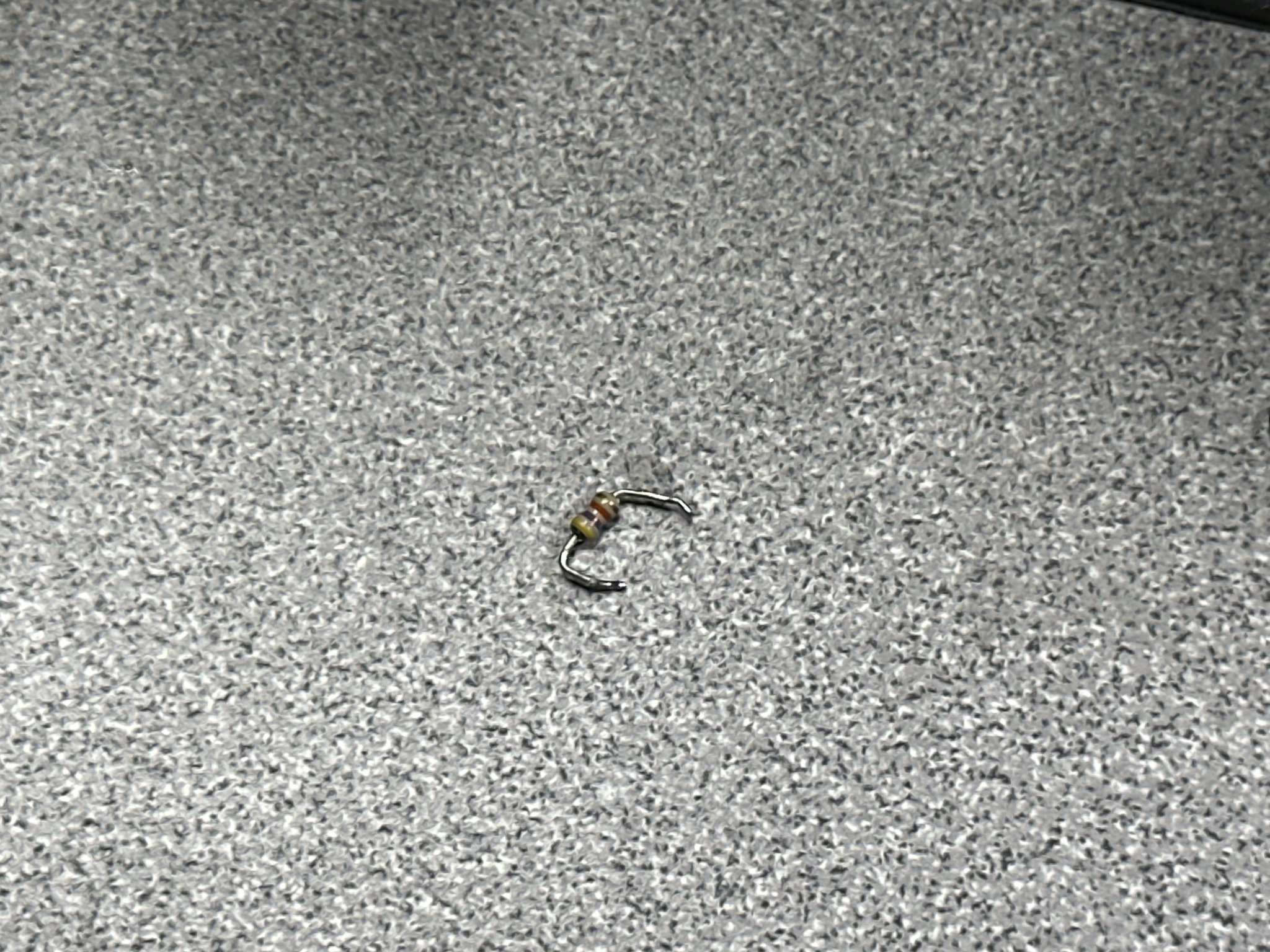

For D712 (or an equivalent diode that you purchased), ground the anode, Connect the cathode (striped end) to the resistor. Connect the free end of the 47k resistor to the 12v terminal of the power supply. What's the DCV directly across the diode?
^^^ This must be done with the diode out of the circuit.
Absolutely do NOT power the head unit up with the diode out of the circuit.
