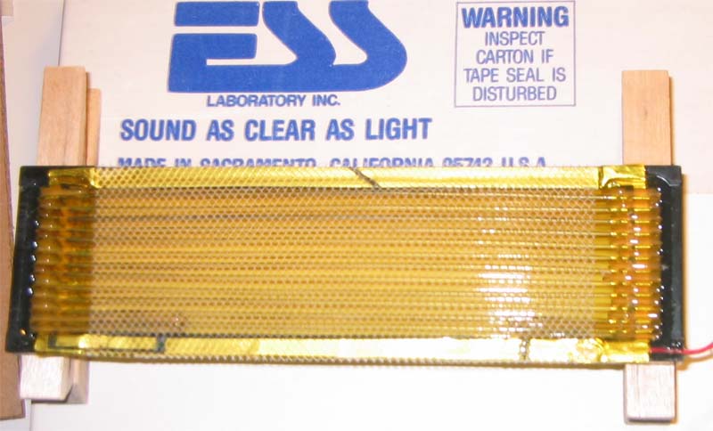

promitheus said:this picture was posted a few posts back.
when this side is in the front does it mean the red wire is plus.
my diaphragms hace blue and purple. How do I know which is plus.
These are the diaphragms I have and posted measurements for.
As stated elsewhere, use a 1.5v battery and tap the leads on it.
With a magnifying glass you can see the diaphragms action and
deduce which side the air is "squeezed" out of and which side it
is "sucked" in.
cheers
Terry
Polarity doesn't matter much although it makes sense to hook both drivers up the same way in a stereo system. In fact, both sides of the diaphragm push and pull at the same time, just on opposite sides of the same pleat. Remember the diaphragm doesn't move in and out like on piston type speakers.
Polarity with regard to woofers is meaningless.
Making your own diaphragms isn't trivial, as I have discovered. OTOH, I haven't worked that hard on them. I now know the materials the latest ESS diaphagms were made from, but these are reputed to roll off in the highest frequencies in exchange for handling heat better, so I'm not investing in that material just yet. Still working with mylar which has worked well in mine for 30 years.
More soon I hope.
Meanwhile, the rest of you, try making your own and getting back to us.
-Jeff

Sorry, this is not true.
AMT have polarity just like any other driver.
Driver polarity is specified such that when connected correctly, a
+ electrical impulse will move the driver forward. The AMt is just the
same, on a + impulse the pleats will "squish" air forward at the front
and "suck" air inward at the rear.
The end result is exactly the same.
Also absolute phase in conjunction with other drivers is also
important, as is with any other driver.
cheers
Terry

Phase is relative; just flip a coin and hook the AMT up. Play a sine wave of a frequency near the XO point. Now listen very carefully and switch the wires. You should definitely be able to hear a difference. It should sound "louder" and more coherent when in phase. If not, then just leave it alone and consider all well.😉

I was just playing round with my Heils and I can confirm they are dipole.
I held the Heils up to my ears like a pair of headphones. I turned one of the heils around and the signal was out of phase with the other Heil. Definitely dipole. Mystery solved.
