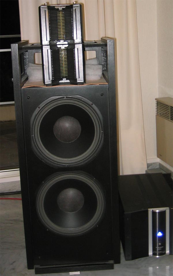

Any one tried to make a Heil speaker using JBL bass drivers, may be even K2 drivers (2x 12 or 1x 15 inch)?
CD

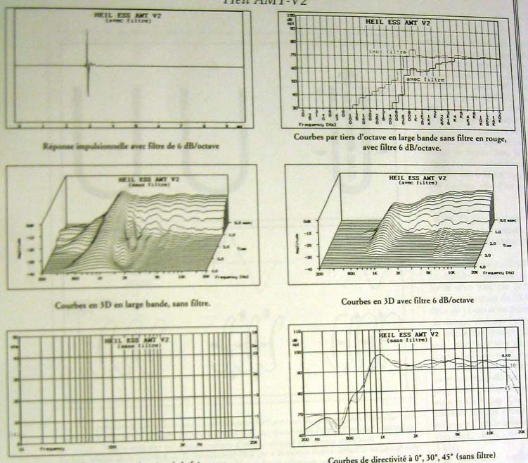

Just to illustrate here is the graphs from Prestige Haute Fidelite
CD
seen and felt Heils, with Gauss woofers,
and plenty of power, a real eye opener!
as in post #10 in this tread
JBL's should work quite well
Bart Locanthi worked at JBL and Gauss( and pioneer and Altec)
he may well be the father of the modern
low frequency loudspeaker-

Has anyone else actually measured the current drivers/ribbon (yellow mylar)? The 800-9k number seems very brutal :bigeyes: , making the driver almost useless, for those of us who can actually hear above 9k 😉
Do we know if the french magazine was measuring the mylar ones?

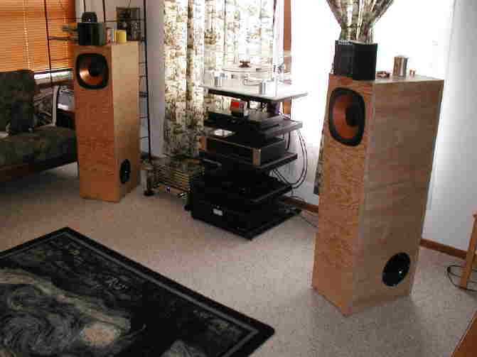

Hornaudio - your spectrum analyzer must be broken. There is no way these only go to 9k. Please provide supporting evidence. Here is a pic of my homebuilt speakers with yellow ribbons and the tweets are amazingly good and extended.

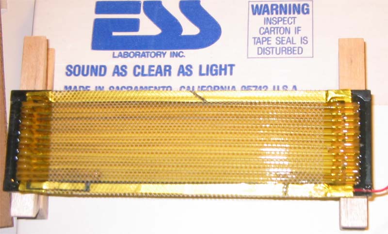

I've wondered whether the tweeter in the picture was the largest Heil ever made...
