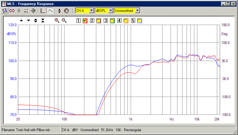

Wasn't sure if that would come out. Yellow diaphragms, from memory
one of the plots was 2 stacked vertically and the other just one.
This is the later style thicker (3mm) lamination Heil.
As you can see they certainly do go past 20k.
We also tried sonic comparison of the older (soft clear) diaphragms
versus the newer yellow ones and the new ones were cleaner
sounding, but they both had their own slight character.
I have them ruunning with Altec 414c 12" alnico MB driver and
it's one of the few drivers that work with Heil.
cheers
terry

Thanks! It's confirmed!
terry

In this same post I attached the measures done with the later version of the Great Heil with Yellow cartrige and as you can see the measures are very good.
Post #28
http://www.diyaudio.com/forums/showthread.php?postid=670521#post670521
I have had the 3 versions of the cartrige, the original "soft" from 1972, the clear version from 1994, and the last Yellow version.
There are no issues with the yellow version, they sound fine and go up to 20K no issues.
cheers.
Post #28
