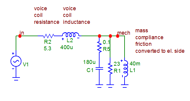

I have not read all the 9 pages, but one of the first things to come to my mind is testing and measuring power amps with real, preferably large woofer loudspeaker systems as as load, thus not a simulating network. Purely out of curiosity, I for one would be interested to see if Blameless amps- that is i.m.o. what we are basicaly talking about- in reality remain unaffected by large woofers "talking back" (back emf) to the amp, especially when driven harder than just a few Watts. Large systems such as the AR9, KEF105, B&W 80x and the likes thereof would be very nice as test bed. To stay sane & healthy, that speaker should be placed in isolation somewhere, in order not to deafen the measuring technician/hobbyist.
^ You'll now rule out 99%+ of anyone considering these tests if that would be a required criteria.
Is there a way to simulate it somewhat realistically with any kind of (readily available) testing gear / loads? Again... novice here...
I would envisage the measurements to be able to be done with a good quality sound card, a scope, 2, 4 and 8 ohm load resistors, an as yet to be defined speaker dummy load, and a selection of capacitors between 1nF and 2.2 uF.
If you make R-L-R//L//C load
it acts exactly like the speaker, with "energy exchange" as well. No difference. There is no difference whether the energy is stored in mass/compliance or capacitor/inductor. Same "back EMF".
So back drive your amplifier under test from another amplifier via a series resistor of around 4 Ohms. I doubt that you will find anything unusual.
