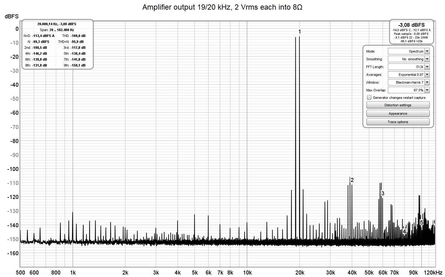

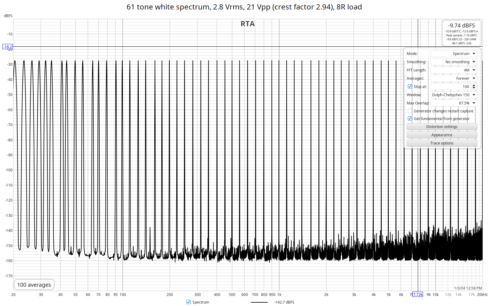

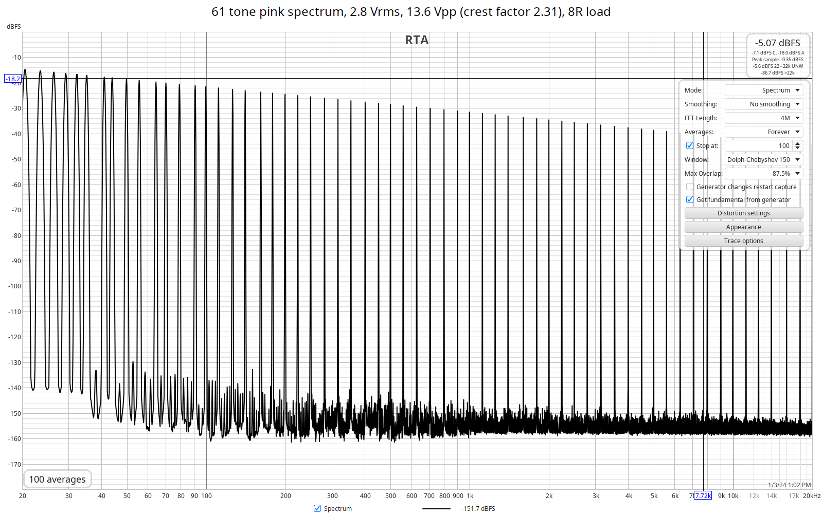

I wonder myself isn’t a two tone IMD measurement as inadequate as is 1 kHz THD?
Multitone signal is closer to the real music signal than any single or 2-3 tone sample.
Here are 3 measurements of the same amplifier. Which is more suitable or if not, then why?

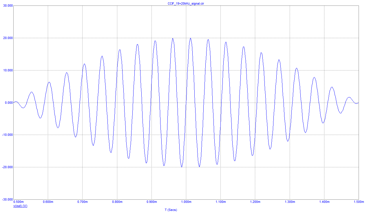

Only in case that the amplifier has slew rate high enough and does not show too much HF nonlinearity. Remember that 19+20kHz CCIF IMD max. dv/dt is defined by amplitude of 19.5kHz sine, dv/dt = 2*pi*f*Vp
Low SR degrades CCIF IMD result, HF non-linearity creates odd order skirts around 2 base tones.
Multitone test signal has much lower amplitudes of individual harmonics and thus the multitone result is often better than the CCIF IMD. Again, depends on amplifier non-linear transfer function, that is both level and frequency dependent.
Nice post! I guess the multi-tone is a good test but I would like to see a full power as in full output as in full output voltage swing of some sort to look at large scale non-linearity effects as well. Most amps perform admirably at low powers, where often the test instrument noise floor and distortion dominate.
I prefer 3rd, then both channel running, also at 4 ohm. Vpp to be at 80% of max Vpp. That would be reality test.
Both channel doubling current, transformer radiation in the box is higher, ripple is higher.
Cons is there is no numerical value of that test, only visual analyses of FFT.
