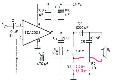

For me the ability to convert a (chip) amp to current drive for use with fullrange drivers is of such high sonic importance that absolute (chip) quality is overridden by the fact that this driving mode has its advantages.
So an old contender like TDA2003 / TDA2009 does the job of making the loudspeaker actively sound better than with a better spec voltage amplifier.
Can this be taken into consideration in the evaluation list?
"easy convertability to current drive"?
This is an implementation aspect and should therefore not be part of the AFOM I think.
This should not be an amplifier assessment criteria. The criteria would simply look at this amplifier as a black box and then report the results accordingly. How the amplifier is implemented, other than protection features, what topology, solid state or tube should not come into it.

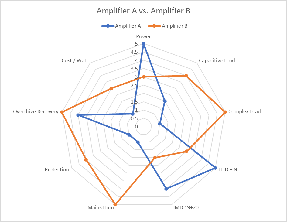

What we are aiming for IMV is a simple set of measurements that can be applied to commercial and DIY amplifiers, that if largely scoring well, will assess the amplifier as all round capable, rather than the single dimension distortion figure objectivists have gravitated towards. People will certainly game some aspects, but that will hardly change their score if they have neglected other parameters in doing so.
As already agreed, the results will be presented in graph format with a top level figure of merit normalized to 0 to 10.

Having been a part of a number of standards committees, I have one suggestion to offer to perhaps quell the dissent re: "ratings".
Consider not worrying about a "total" rating. Certain people do value certain characteristics above others, and their decisions are theirs to make based upon the criteria they value most.
Although a "spider / radar chart" can be a bit busy with 10 or so factors, to me, it seems a nice choice for this application if people would like to compare properties across amplifiers for multiple criteria. The scaling looks better if the minimum is 1 vs. 0 (just makes things easier to view), but that's not particularly relevant at this point.
Then... the discussion of which amplifier is "better" "in total" could perhaps be put to rest...
Example below....
Looking at the frequency response of most speakers makes this a no no and can result in buzzing, uneven response and speaker burnout
