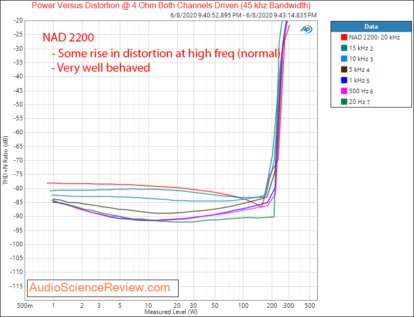

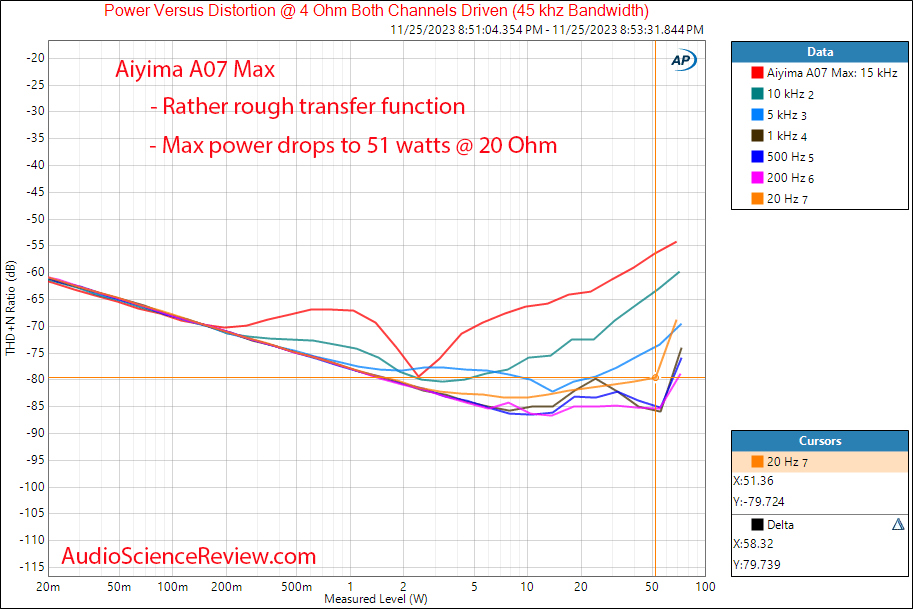

In the top graph, the power increments (driven from the source signal) are too large so the clipping profile is rounded at the bottom of the trough just before the amp goes into clipping. To fix this, reduce the source signal amplitude steps.Power vs distortion ?
View attachment 1253916 View attachment 1253917
(Images from Audiosciencereview.com)
I agree with you - distortion vs power must be added. I’ll do that when I update the first post and also add the frequency response updates.
