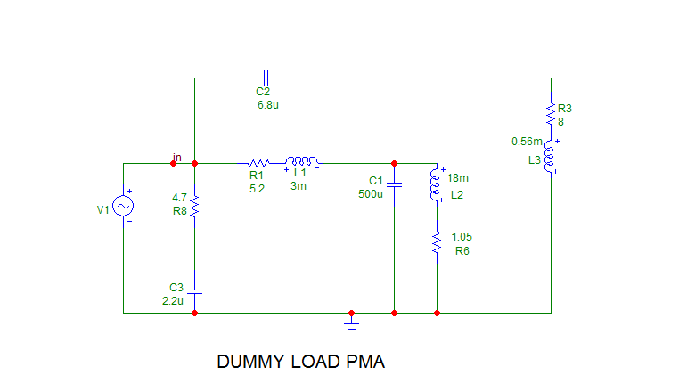

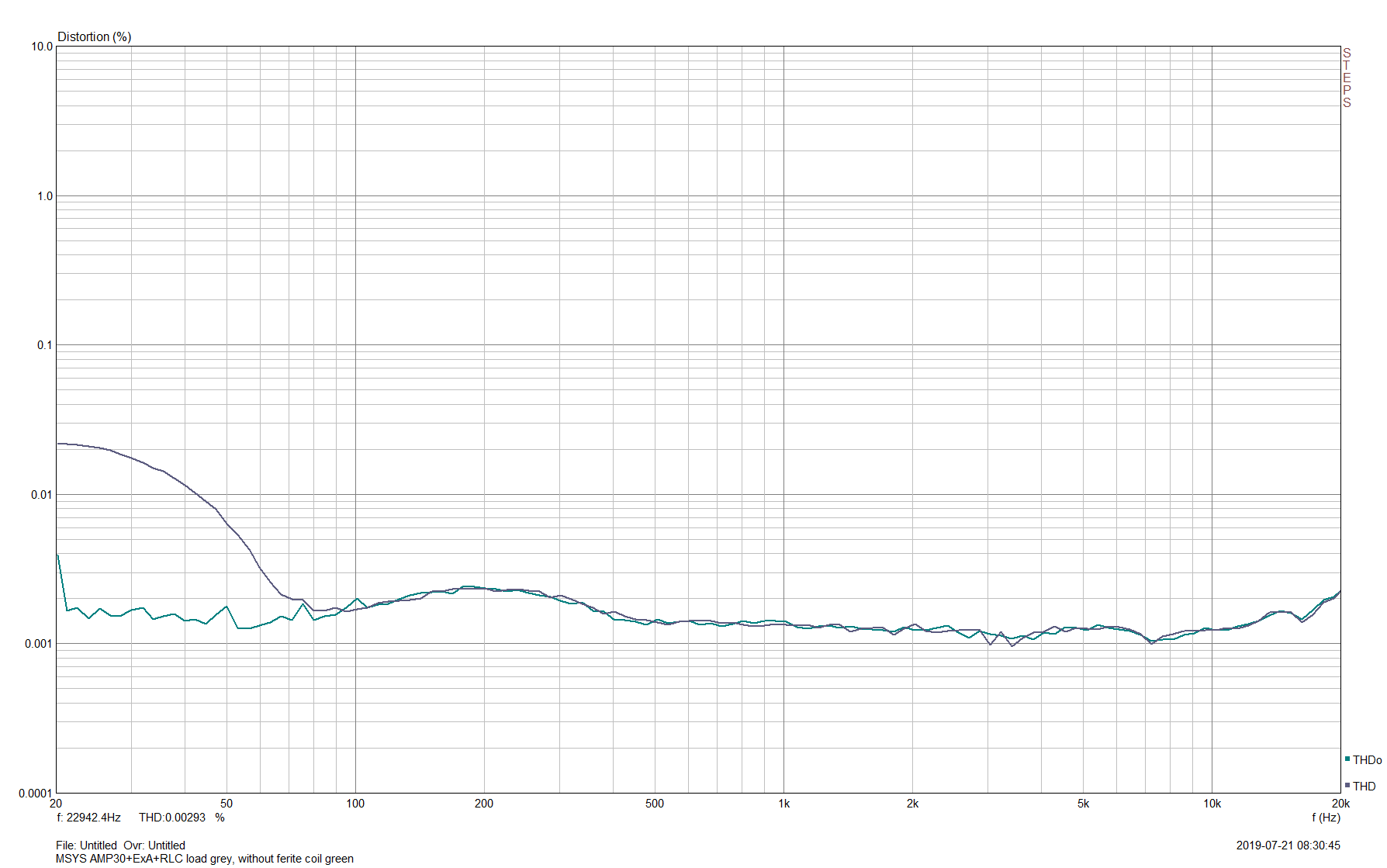

BTW, I use a non-linear, ferrite core inductor in the dummy circuit RLC resonant circuit. Below 100Hz, it is pretty nonlinear and tests damping by creating a divider with amp output nonlinear impedance.The load is quite complex, non-linear and non-intuitive.

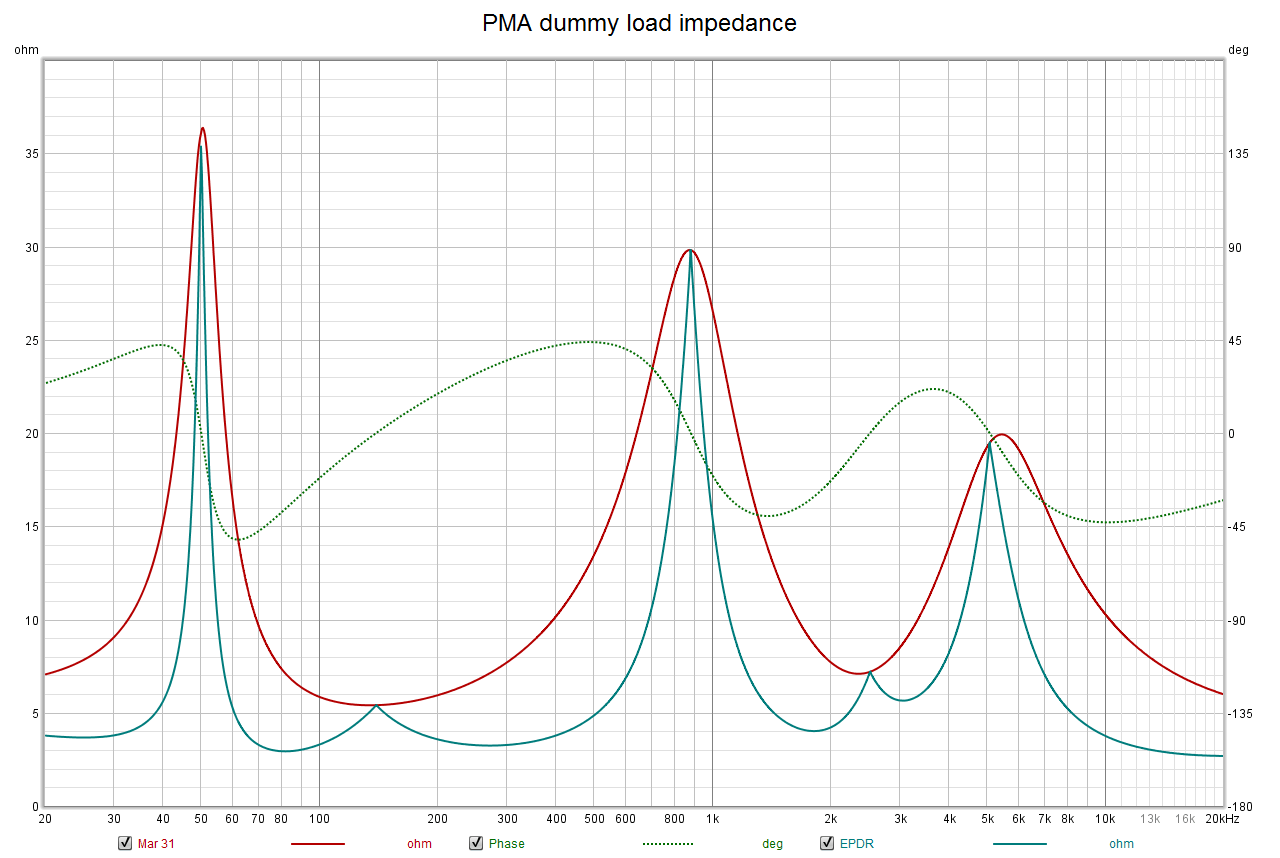

Does someone want to propose a dummy load that will test the amplifier’s ability to drive a complex load.
A loudspeaker is not a practical load for reasons of cost and practicability.
He wants one, but can't have it until I'm done perfecting mine 😆Rather build them, it's a DIY forum after all.

A simple test would be to choose a resistor and inductor in series which gives the most adverse phase angle for power amp dissipation. The resistor can be lower than the nominal impedance according to some fair statistic of speaker impedances and the inductor chosen for say 60 degrees at a 40Hz test frequency. This is easily combined with the capacitor load stability test. A switch box is convenient but the contact resistance is sometimes enough to hide instability.
Testing using a free air woofer is not necessarily better than a sealed woofer because extreme phase angles cause less strain than moderate phase angles. The woofer peak should be tall and broad so there is more total spectrum taken up by moderate phase.

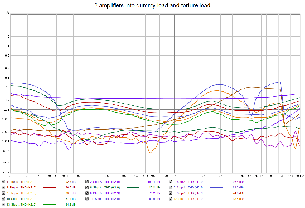

Hi Andrew, I am not sure if to propose, but I can share the circuit I use to test amplifiers (not speaking about trivial R//C):
L2 has non-linear ferrite core, so there is the LF nonlinear effect when measuring distortion at amp terminals
