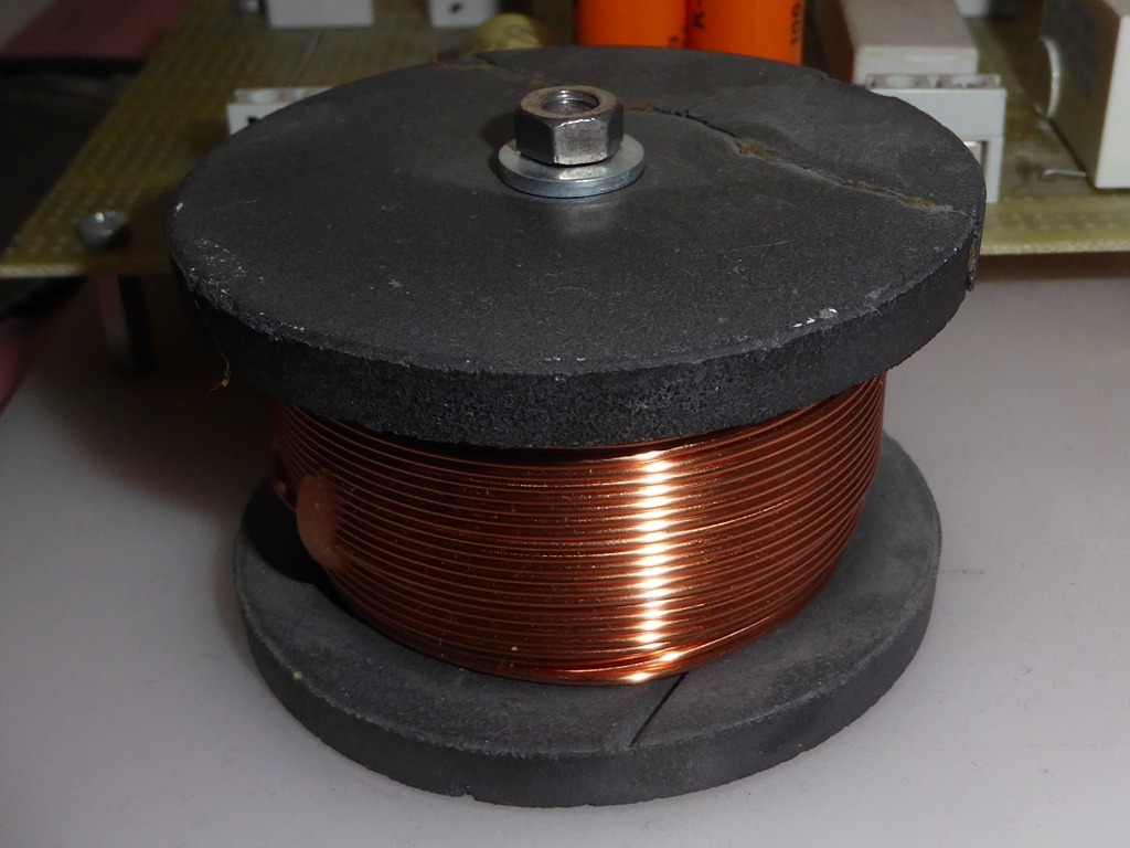

This looks like a great test load PMA. For the non linear L2device, do you have winding/core details because people will have to be able to build this.
This load shows deep impedance dips and large phase angles in regions of the audio bandwidth where you would normally get a lot of music energy - so an ideal test bed IMV.
(Maybe a BOM also?)
(Maybe a BOM also?)
Unfortunately not exactly. Please see photo below, diameter = 65 mm, height = 40 mm, Cu wire dia = 1mm.For the non linear L2device, do you have winding/core details because people will have to be able to build this.

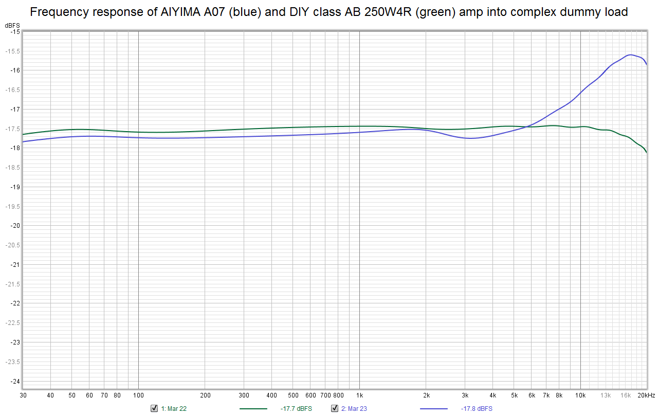

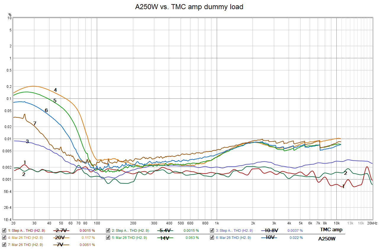

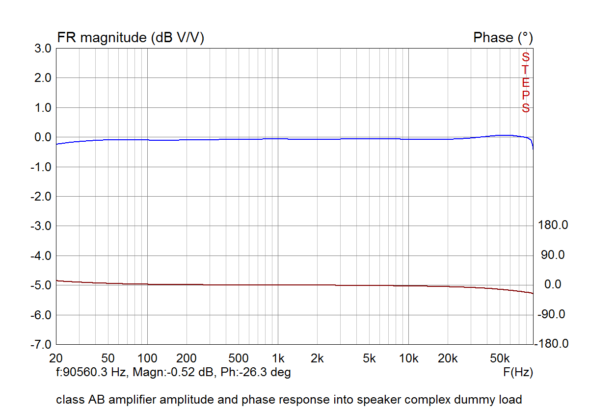

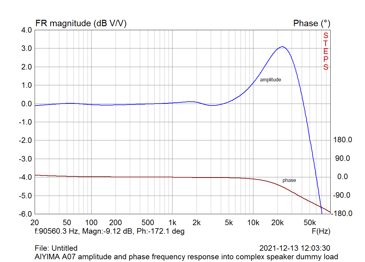

All, I prefer hard data to debates or anecdotal stories on amplifier testing, so some more plots.
