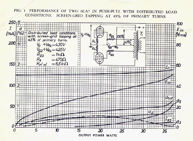

One example from vintage tube amp world , here`s the graph which represent standard ~35W Ultralinear push-pull A-class OPS formed from two standard 6CA7 (EL34) pentodes , where we can see that dynamic THD consinst only from H2,H3 &H5 and nothing else , that OPS-charachteristic is measured alone, fully loaded ,and open loop of course .

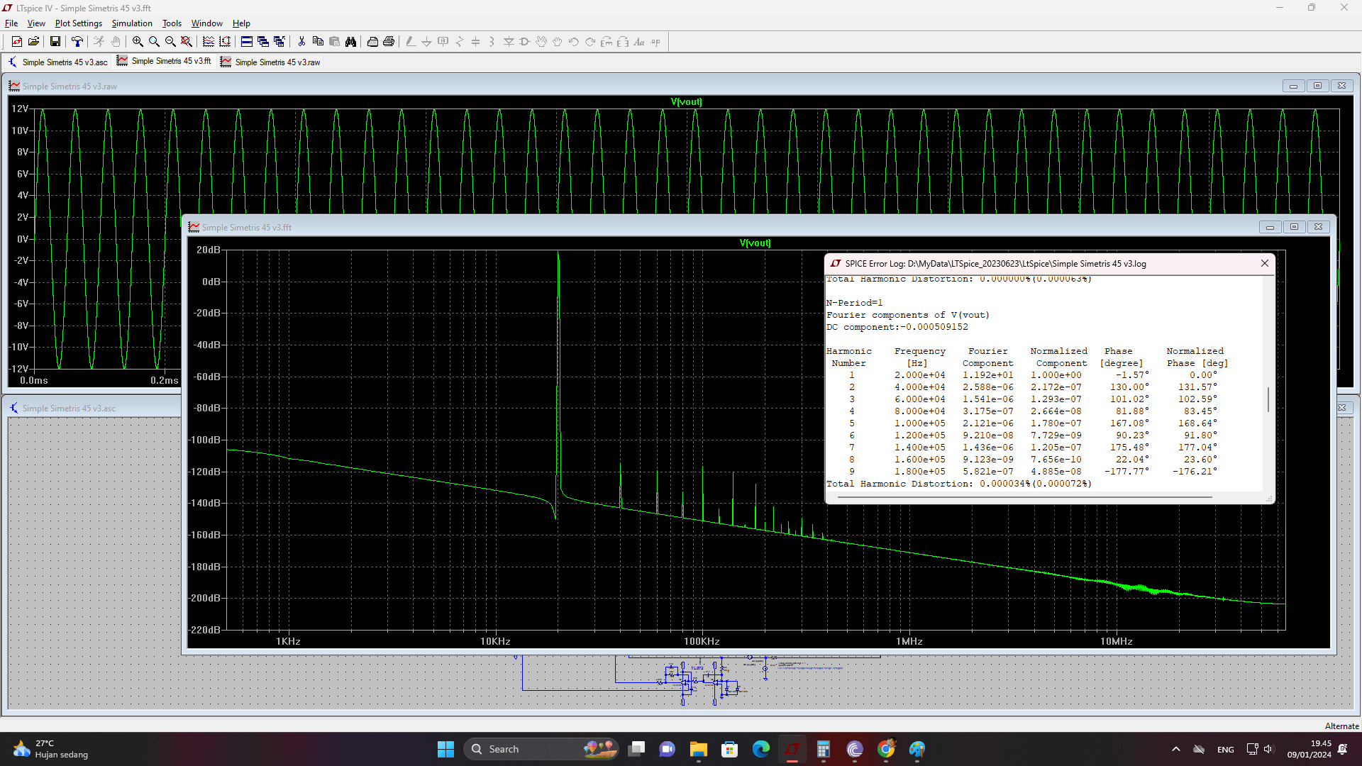

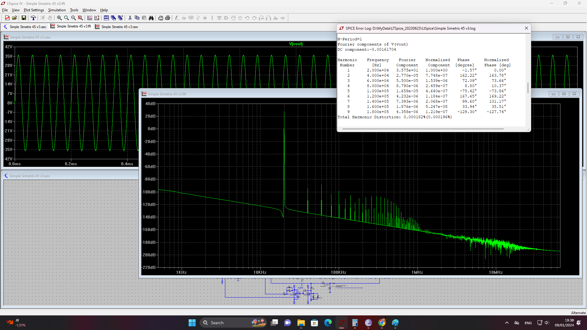

"As for crossover distortion, many amps show the sign of decreasing distortion as power increases, without anyone complaining about the sound quality."
I found it is true when I simulate many amplifiers with single-ended VAS. But symmetries VAS can be different, like this simulations.
