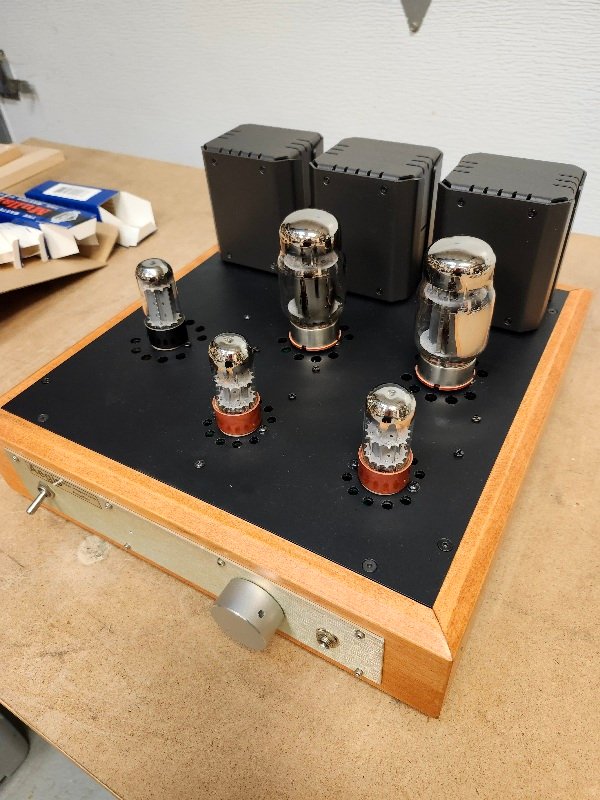

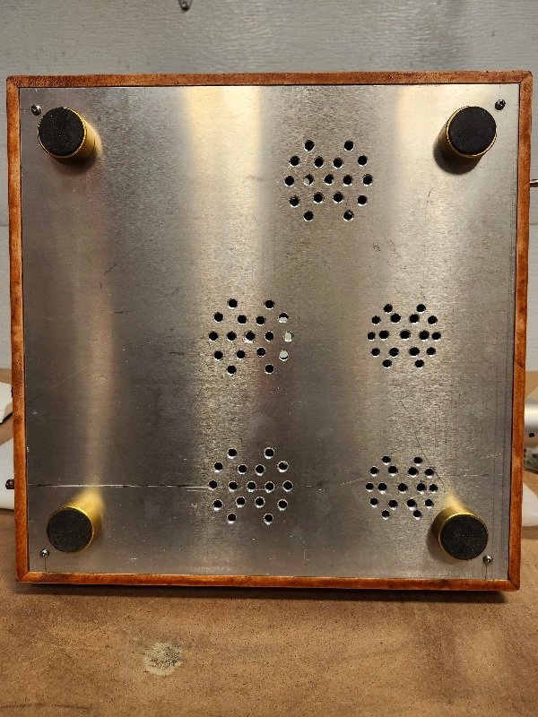

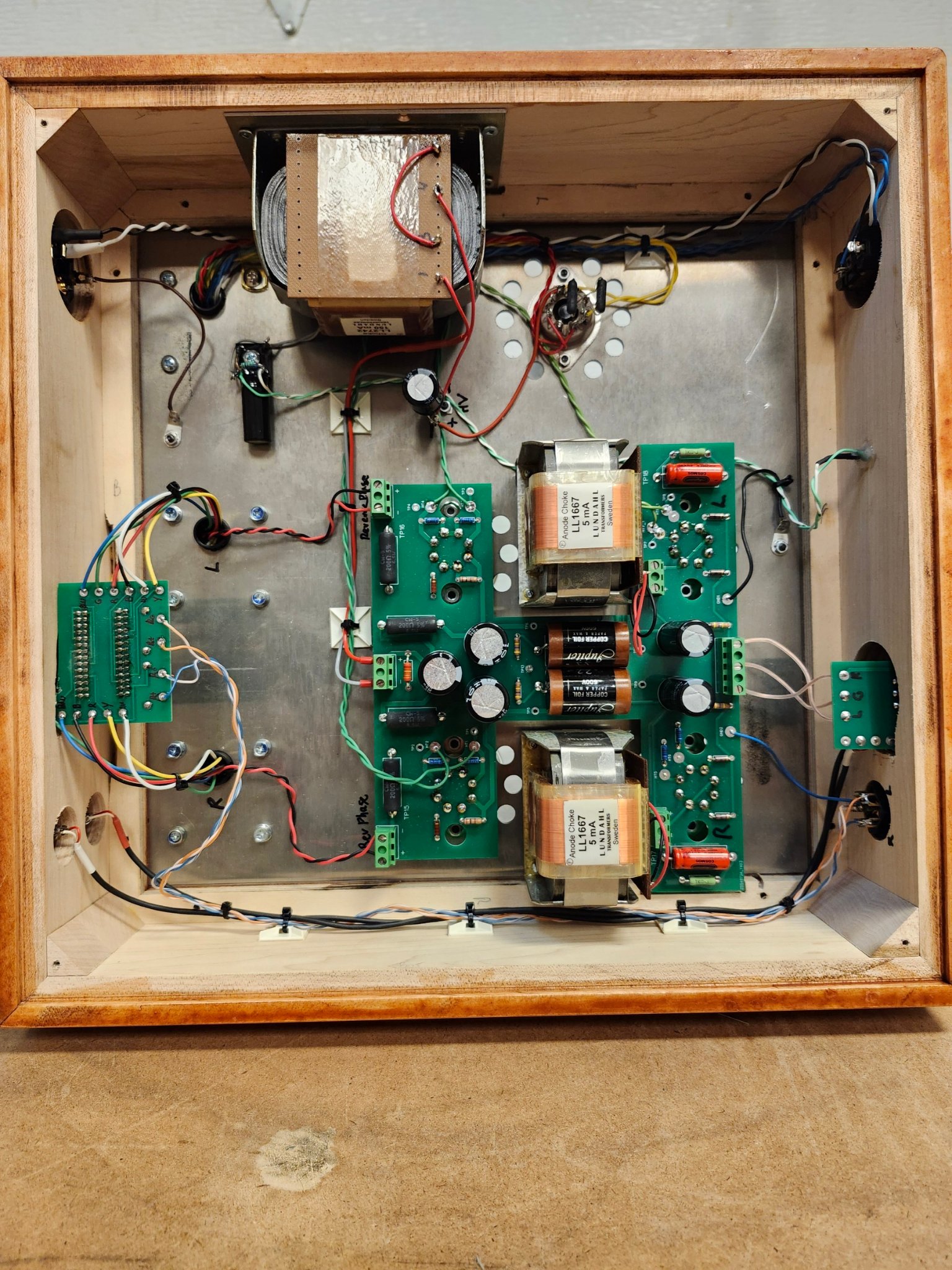

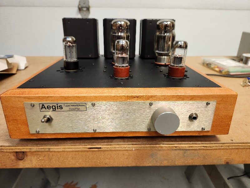

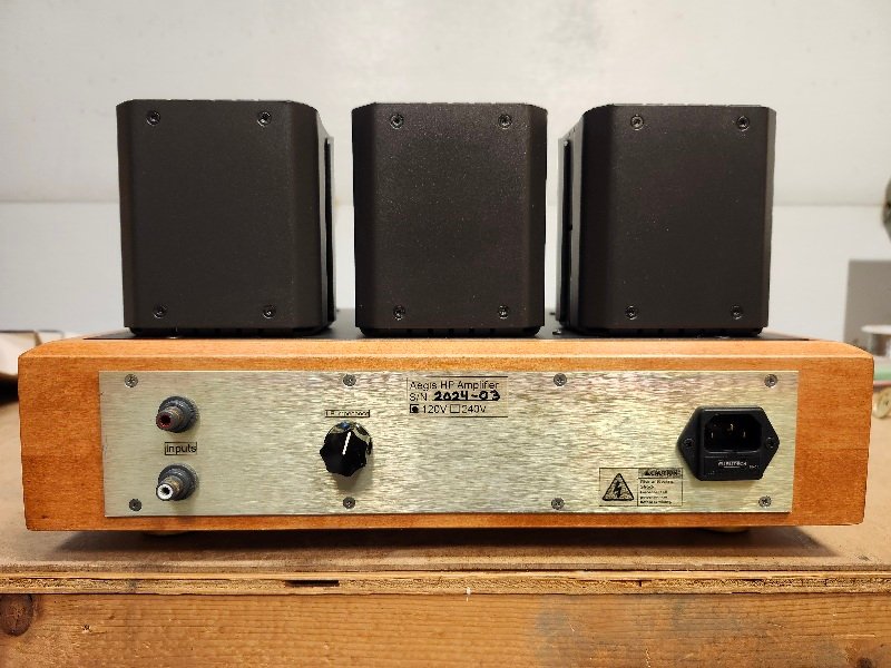

My own Aegis. I bought only the top plate from Landfall and I made the rest with maple. For the back and front I completed with my stock of recycled aluminum plate to mask the larger holes I had to drill into the wood panels. The bottom plate is also made using recycled aluminum plate.
It worked the first time, and sounds as good as ever, here using Mullard KT88 tubes. I added a small DC supply for a front Power-On green led.
