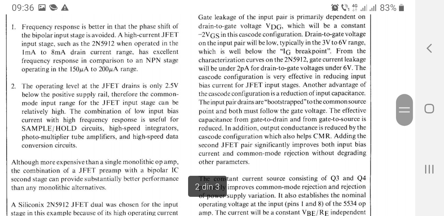

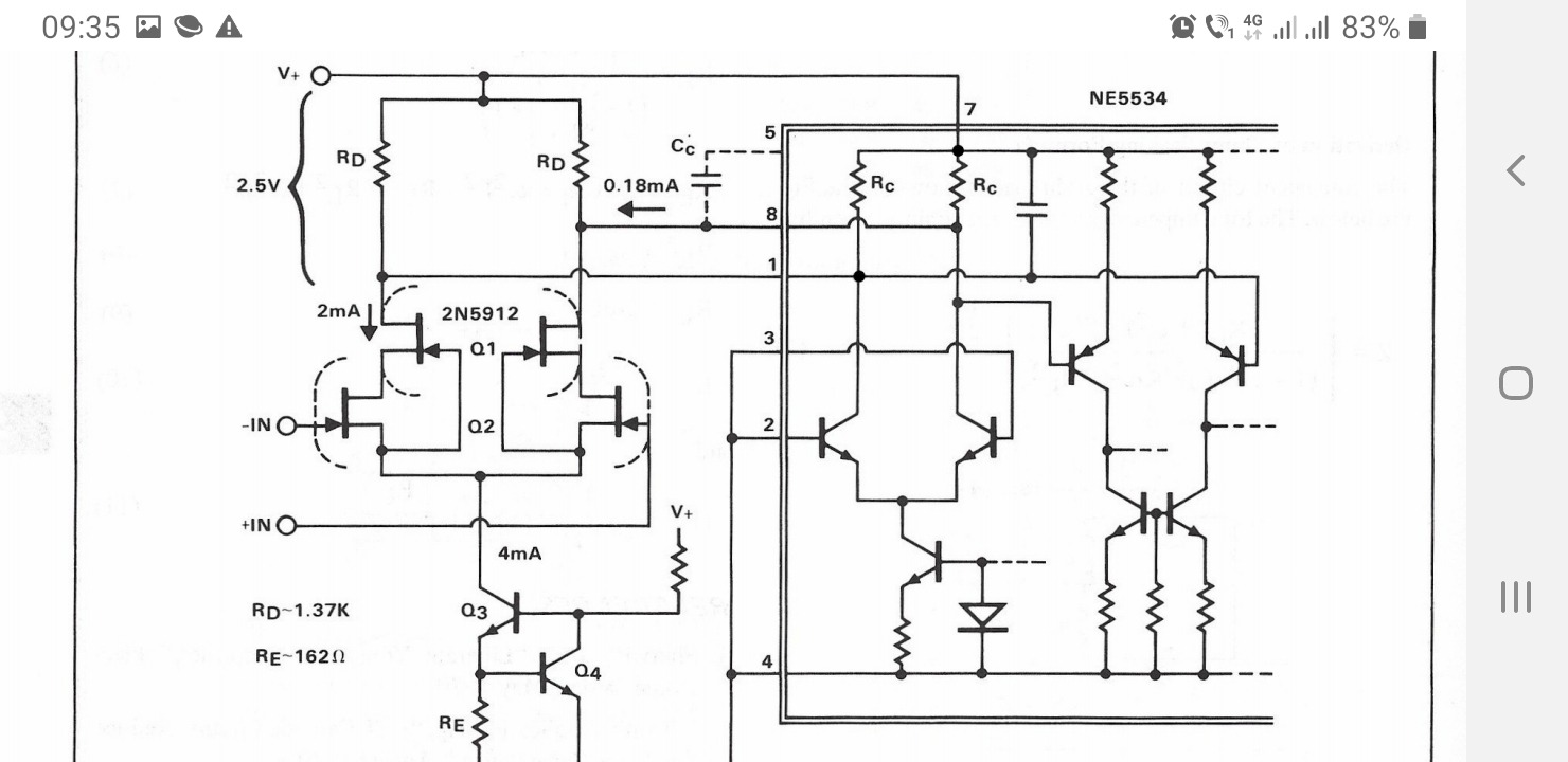

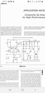

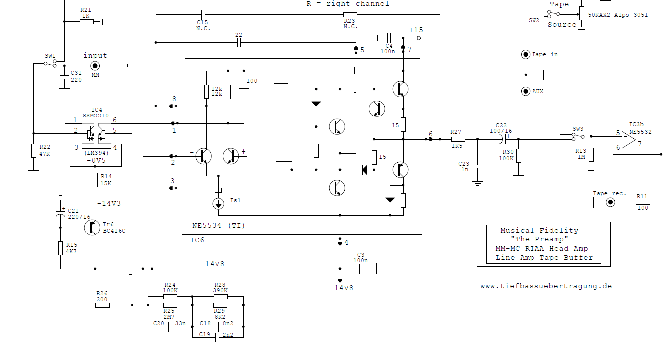

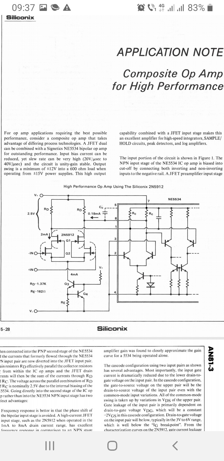

Something like the attached from Musical Fidelity? Also have a look at TI app-note 222 page 7 that has a similar solution for the LM318.If you make a pcb for 2 x ne5534 make space for 6 additional low noise transistors (ksc1845) and 4 antiparallel clamping diodes for the future.Look back and see there's a schematic where the input trz inside ne5534 were replaced by output transistors.
https://www.diyaudio.com/community/...s-in-high-frequency-range.390030/post-7129131

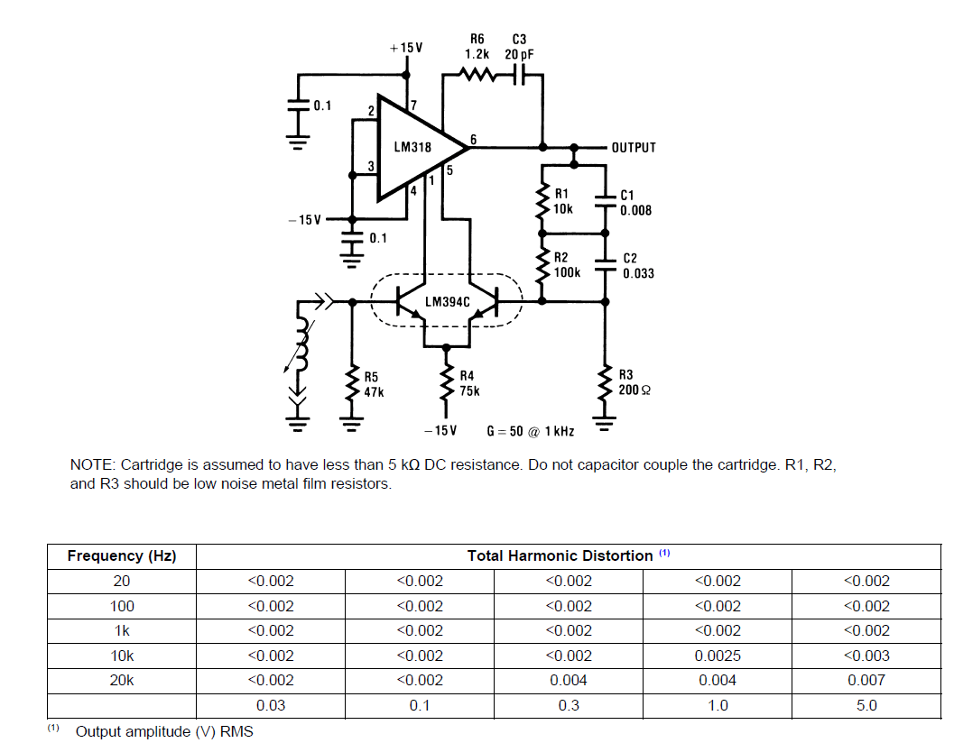

Note different pinout (pin 5 & 8 swap) between NE5534 and LM318. Some may prefer the LM318 solution as it is running at 1/5 the current in the input pair compared to the NE5534. Additional advantage of lower bias-current when direct coupled to MM cartridge. The circuit in AN222 could probably benefit from having R4 replaced by a CCS like in the Vogl3 schematic in post 44 by Dreamth above.
Then again, others would recommend JFET over the LM394 for MM cartridge
The tail current of the differential pair in the LM318/LM394 circuit is close to the noise optimum for a typical moving-magnet cartridge. (See https://www.diyaudio.com/community/...ono-stage-85-dba-sn-ratio.387375/post-7135693 , ignore the values for 20 kHz spot noise and multiply by 1.4 * sqrt(2) * 2 * (1 + 1/hFE) ~= 4 to get the optimal tail current for a symmetrical differential pair with 500 mH cartridge. The result is about 100 uA to 150 uA.)
The NE5534/SSM2210 circuit makes sense for moving coil cartridges or as a compromise for a circuit that has to work with moving coil as well as moving magnet. When you only use it for moving magnet, you pay extra money to get more noise, as the tail current is well above the optimum (÷).

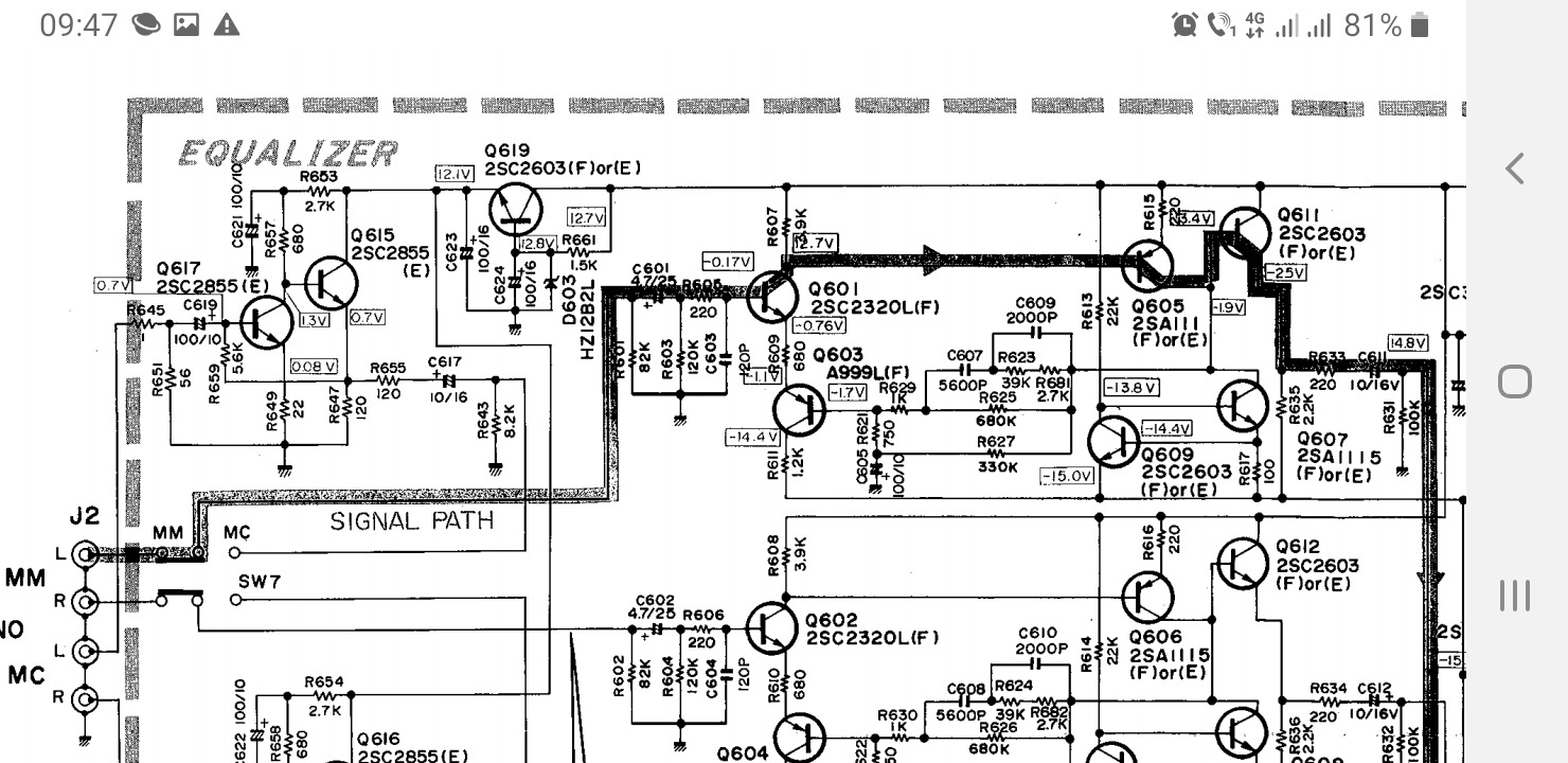

First circuit has about 900uA/2 the second has 190uA/2. I have no ideea why the first circuit is as it is, but most people I read in the past placed the optimum collector current around 1mA to overcome the shot noise in known low noise bipolar types.I saw a distribution of collector currents between 10uA and 1mA in real circuits, but it might very well be that the optimum current depends on the particular chosen transistor too...If that's so then we have to fake it until we make it...

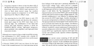

There's also the frequency response of bipolar trz vs jfet trz at a given current underlined in the Siliconix appnote and Nick and you made very clear that you like jfets so I'll give back a bit 🙂
I told for too many times why I preffer bipolar trz in ordinary phono preamps
even though I have one favorite phono preamp with jfet inputs and I won't repeat that again.I tried to replicate kenwood l-02A preamp, but there's one transistor I can't find...and replacing it is tough bussiness.

Marcel,The tail current of the differential pair in the LM318/LM394 circuit is close to the noise optimum for a typical moving-magnet cartridge. (See https://www.diyaudio.com/community/...ono-stage-85-dba-sn-ratio.387375/post-7135693 , ignore the values for 20 kHz spot noise and multiply by 1.4 * sqrt(2) * 2 * (1 + 1/hFE) ~= 4 to get the optimal tail current for a symmetrical differential pair with 500 mH cartridge. The result is about 100 uA to 150 uA.)

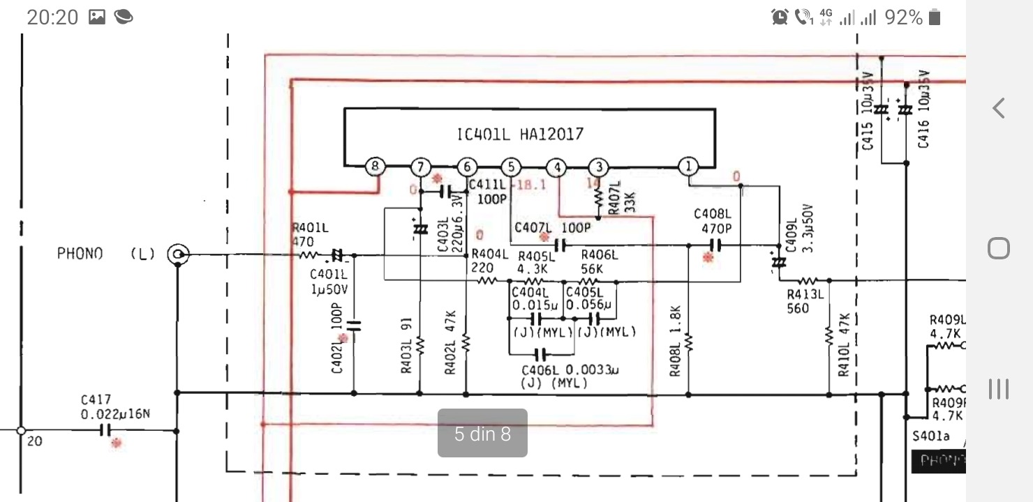

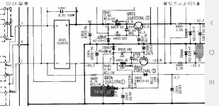

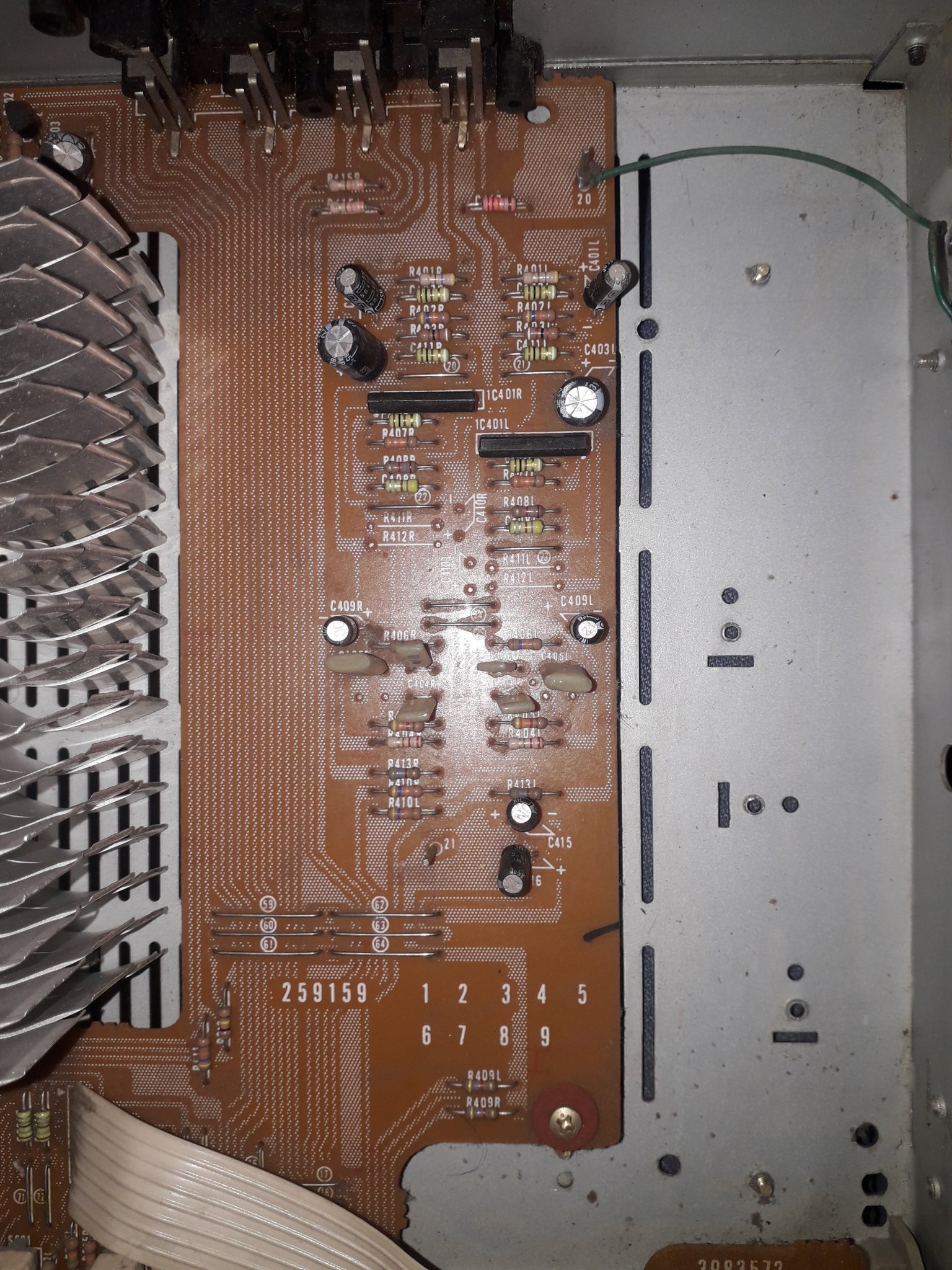

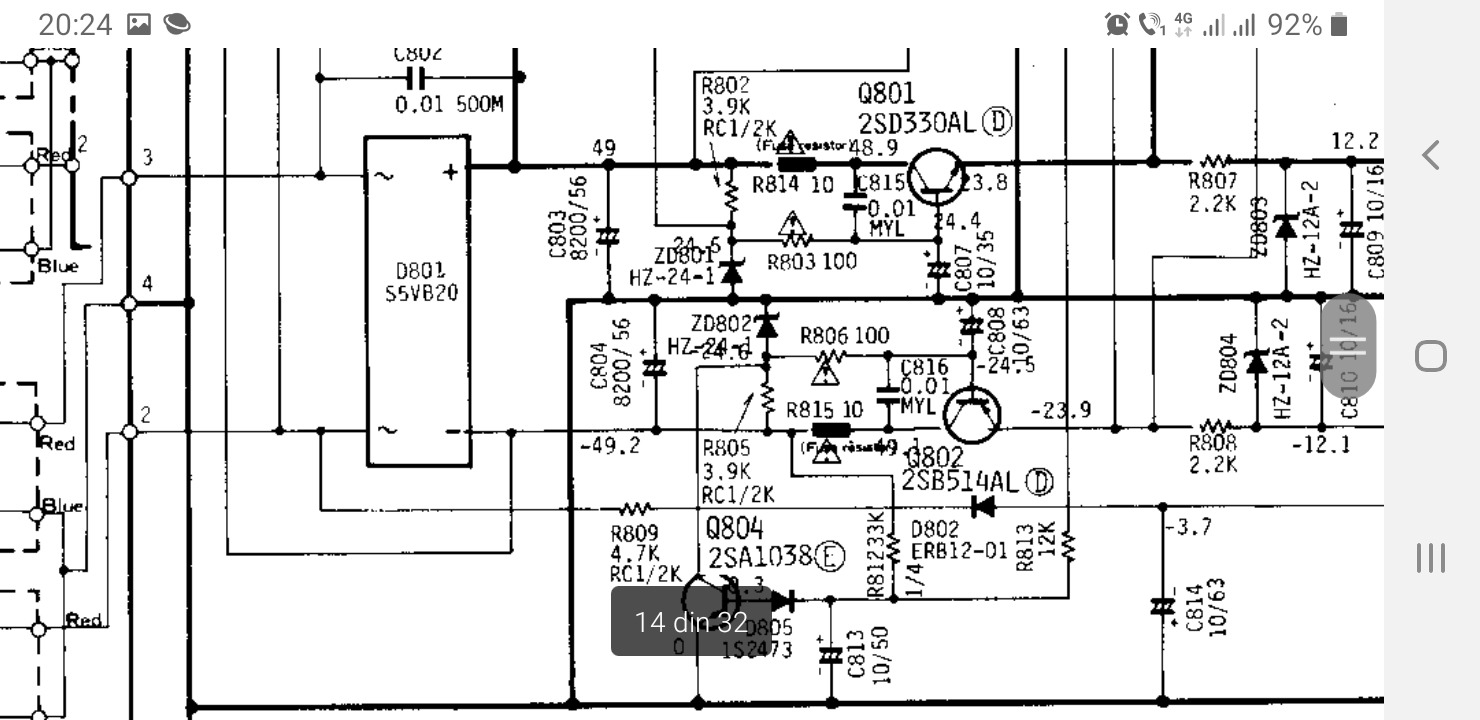

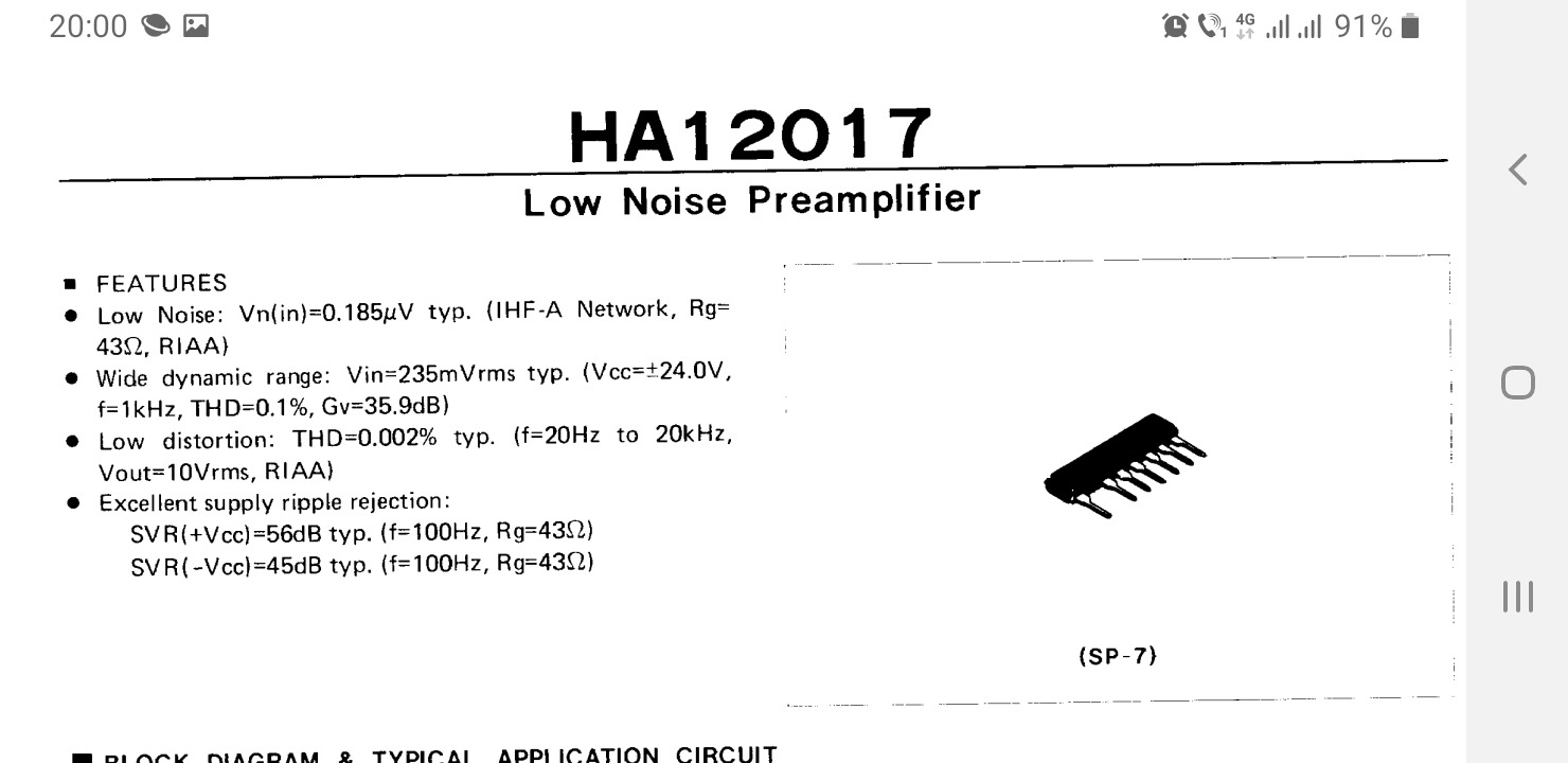

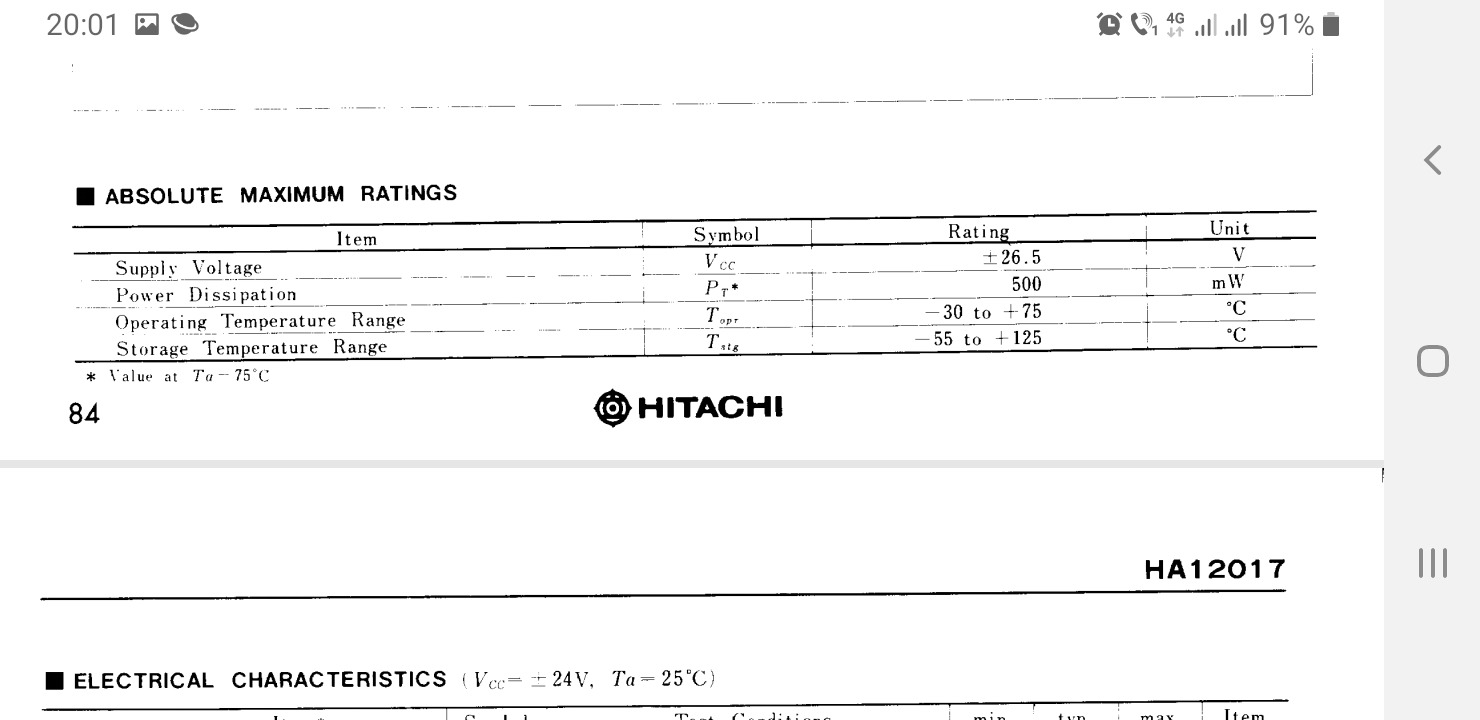

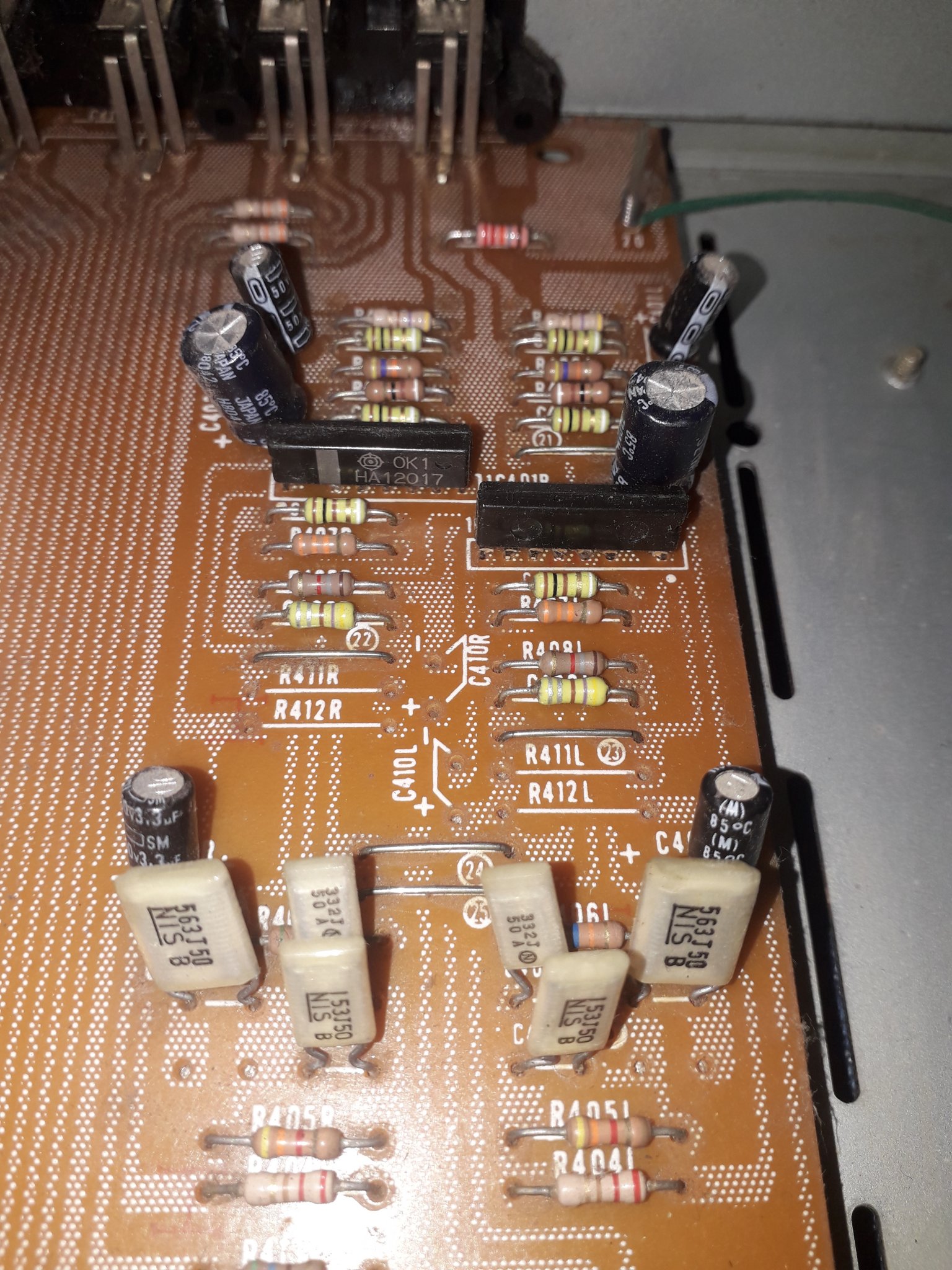

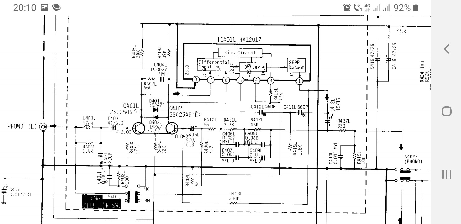

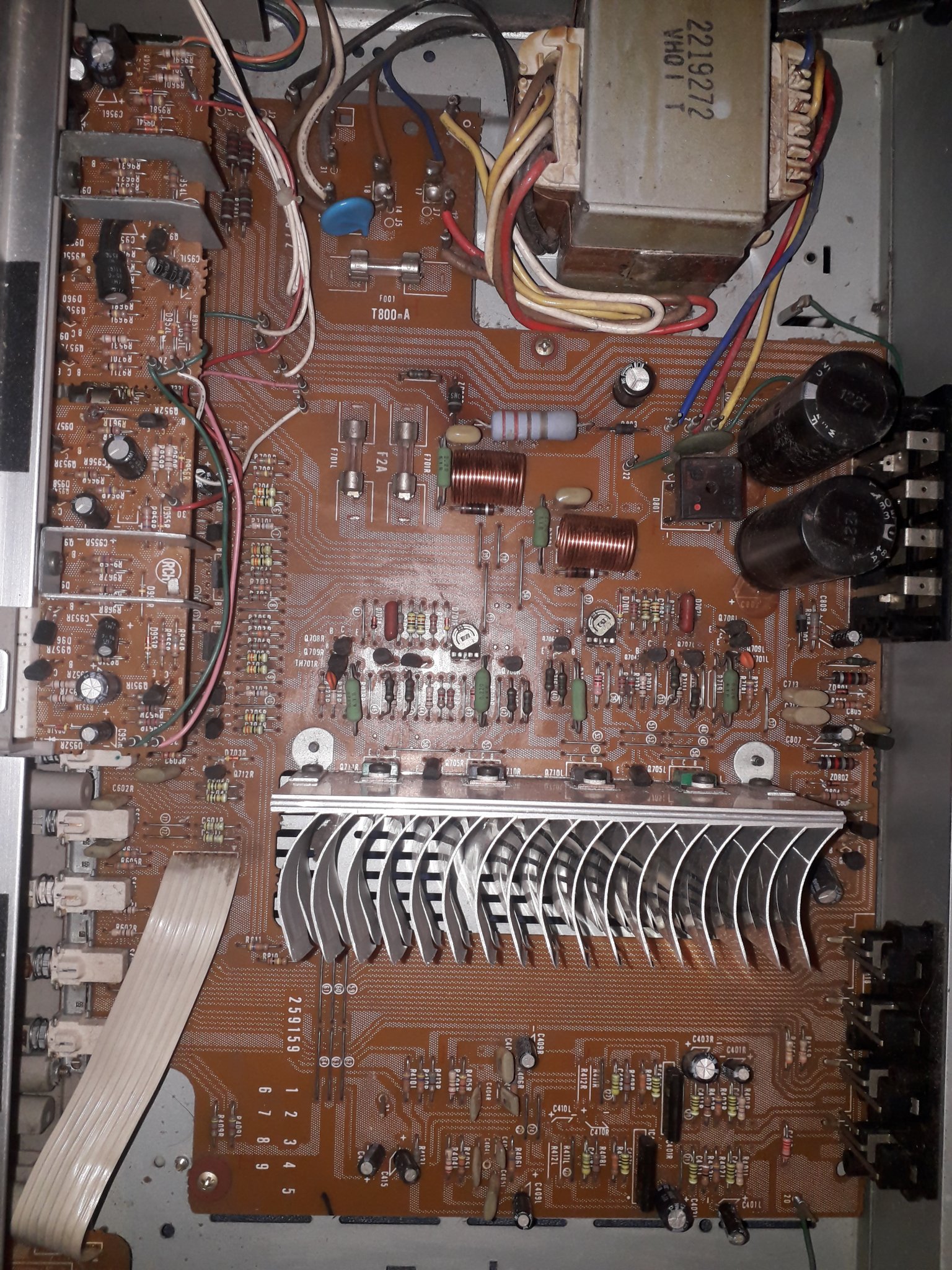

They didn't get into making high speed trains for being clumsy.. this is how they gave the ability to work with mm carts to a 500mW op amp in 1980.Also see the elegance of pcb design:
Hitachi ha-2700, 3700...HA12017:
