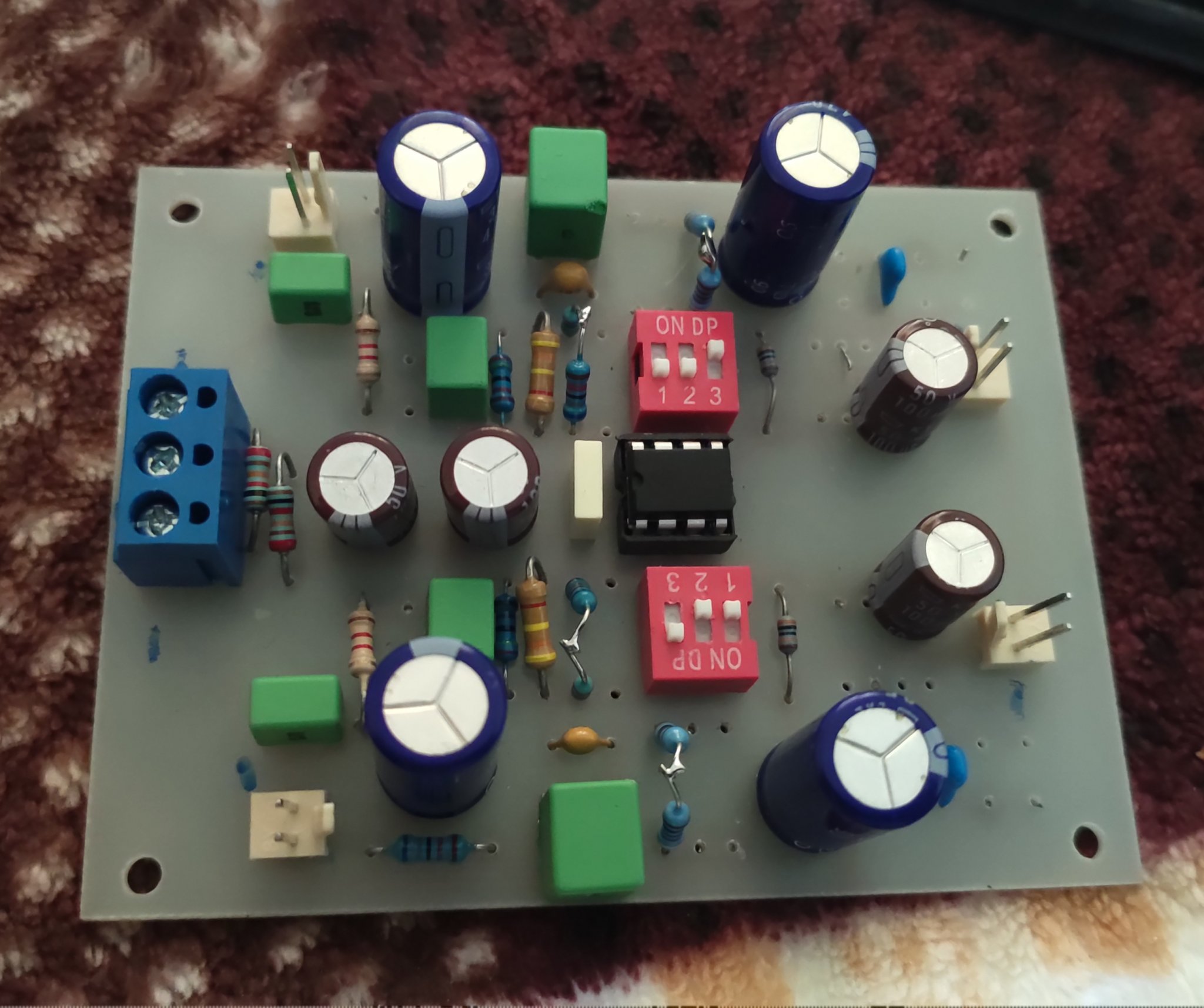

I'm pretty sure you're on a completely wrong path.Can we see your first actual circuit, pcb, decoupling and know the supply voltages?You should have at least +-18v supply.Ne5534 allows for +-20v with no problem and max +-22v.You need headroom first.I know it's counterintuitive but go to +-18v supply first, then +-20v and listen.Use a feedback network from one of the well known commercial designs first, don't go with diy versions cause commercial designs were sold by the millions so they are thoroughly tested. Ne5534 is guaranteed for max +-22v and it's cheap.If you burn a few at +-22v there's no real waste.
I posted the first circuit on the first post of this threat. The voltage supply is +-15 and I'm using NE5532 right now .
This is the PCB:
And the power supply PCB:
Apparently looks fine.

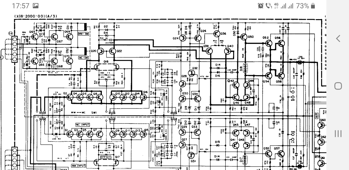

I'm going to repeat my last PM here to.No matter what schematic you choose go first with +-18v supply.Then if you want to be conservative try D Self schematic with 2 ne5534 found in post 12 .With two ne5534 I'd shamelessly go with the max voltage supply of +-22v as they are cheap.Burning a few just adds to your experience.The only problem is saturating next stages output on dusty records...

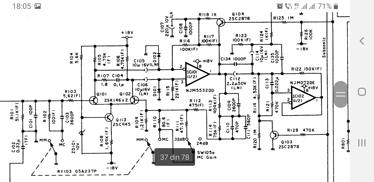

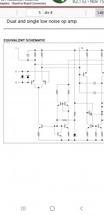

If you make a pcb for 2 x ne5534 make space for 6 additional low noise transistors (ksc1845) and 4 antiparallel clamping diodes for the future.Look back and see there's a schematic where the input trz inside ne5534 were replaced by output transistors.
https://www.diyaudio.com/community/...s-in-high-frequency-range.390030/post-7129131

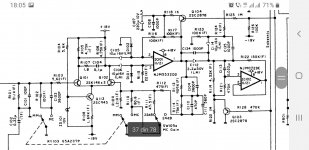

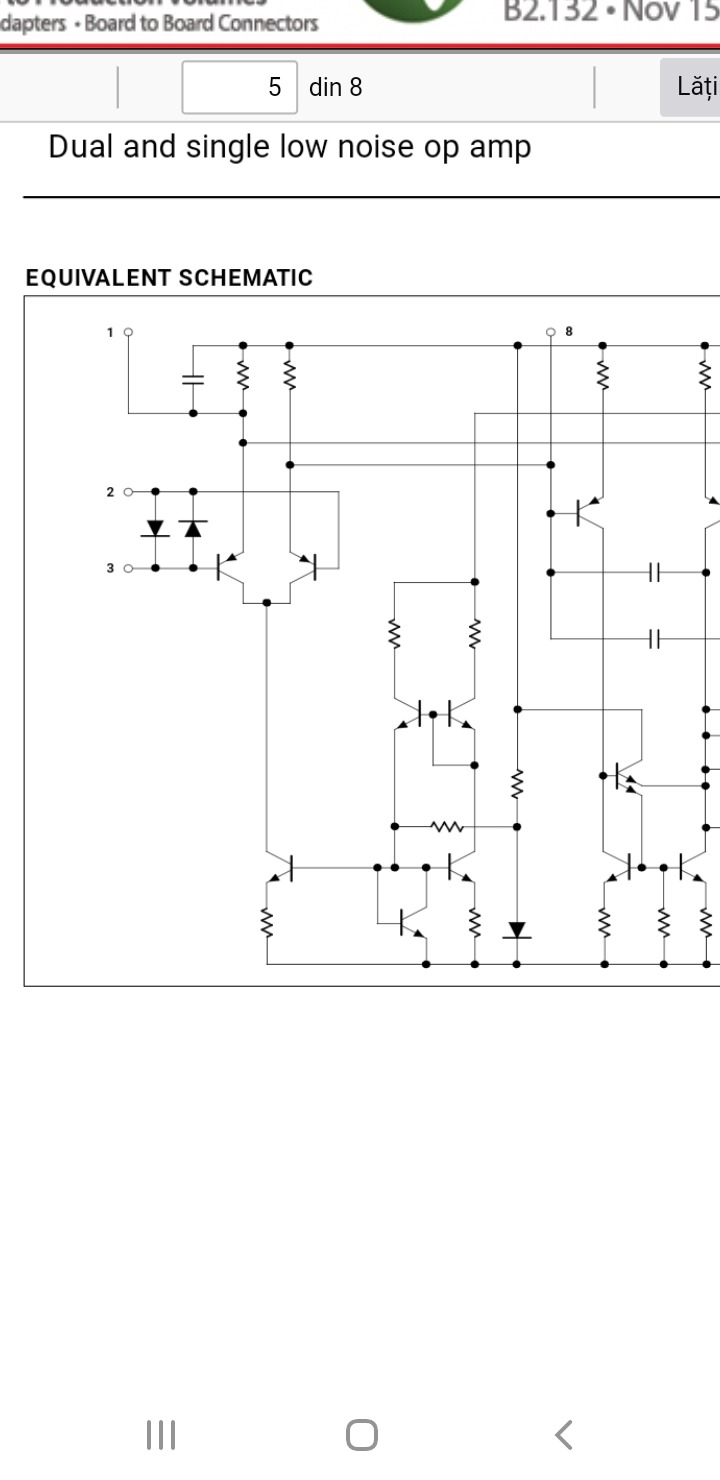

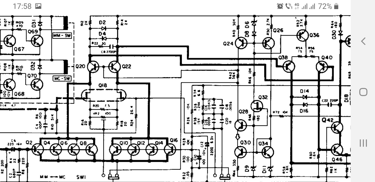

Now the clamping diodes can be placed between pin 8 and 1 with or without replacing the input transistors.They can be ordinary 1n4148, faster 1n4152 also germanium or even schotky diodes and can be placed as in the third screenshot of post #49 where you see Aiwa c30 phono preamp.
https://www.diyaudio.com/community/...s-in-high-frequency-range.390030/post-7129472
It's probably the 20th time I say that: the second and third printscreen is what I and very few other people on this planet consider to be the best solid state phono preamp ever made and that has all the best techniques to limit that "harshness" no matter its source and also has the lowest impedance riaa network and the highest supply lines at +-43V.
You can see that each critical gain stage is clamped too.
You can clamp the op amp inputs differently as in the fourth printscreen if you consider ac coupling the normal inputs of an op amp but that's Nakamichi ...and a Nak is a Nak!
There's a fourth way of clamping an op amp inputs, but that's for the next stages after a high supply phono preamp and we'll discuss it later after you build your new ne5534 preamp.

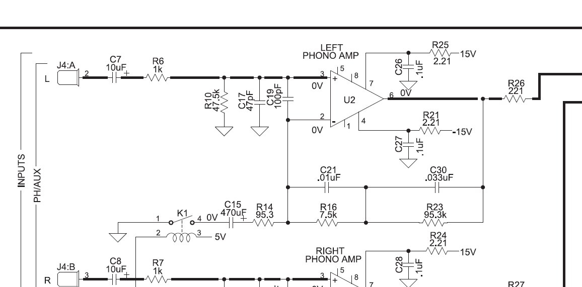

that's a good suggestion. mcintosh preamps use 5534A op amps for the phono stage - just copy that for a quick test.
and you can brag that its a mcintosh clone.
Reactions: dreamth and Alavala
Here in Eastern Europe we have little knowledge about american stuff so your suggestions are welcome! Can you show us some relevant phono schematics from Mcintosh ?While a quick Google search is handy, a first hand experience is often more valuable.

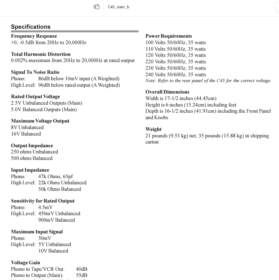

lots out there. here a schematic and specs from their C-45.
i think i've posted this before on this site.
here's some quick review comments from stereophile.
specific to phono stage in 2nd paragraph from bottom of page.
in spite of it using opamps, their comments were kind.
maybe they didn't know ...
