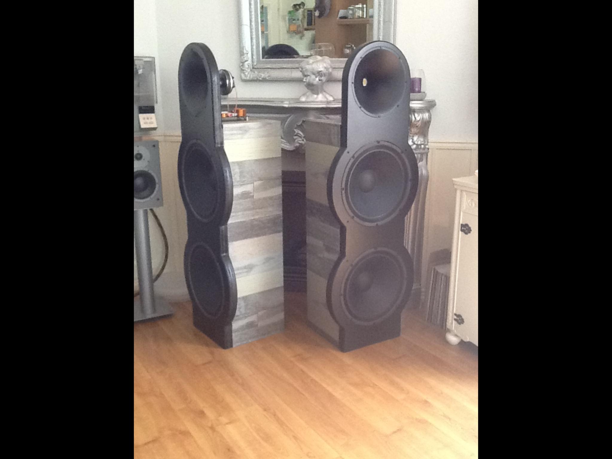

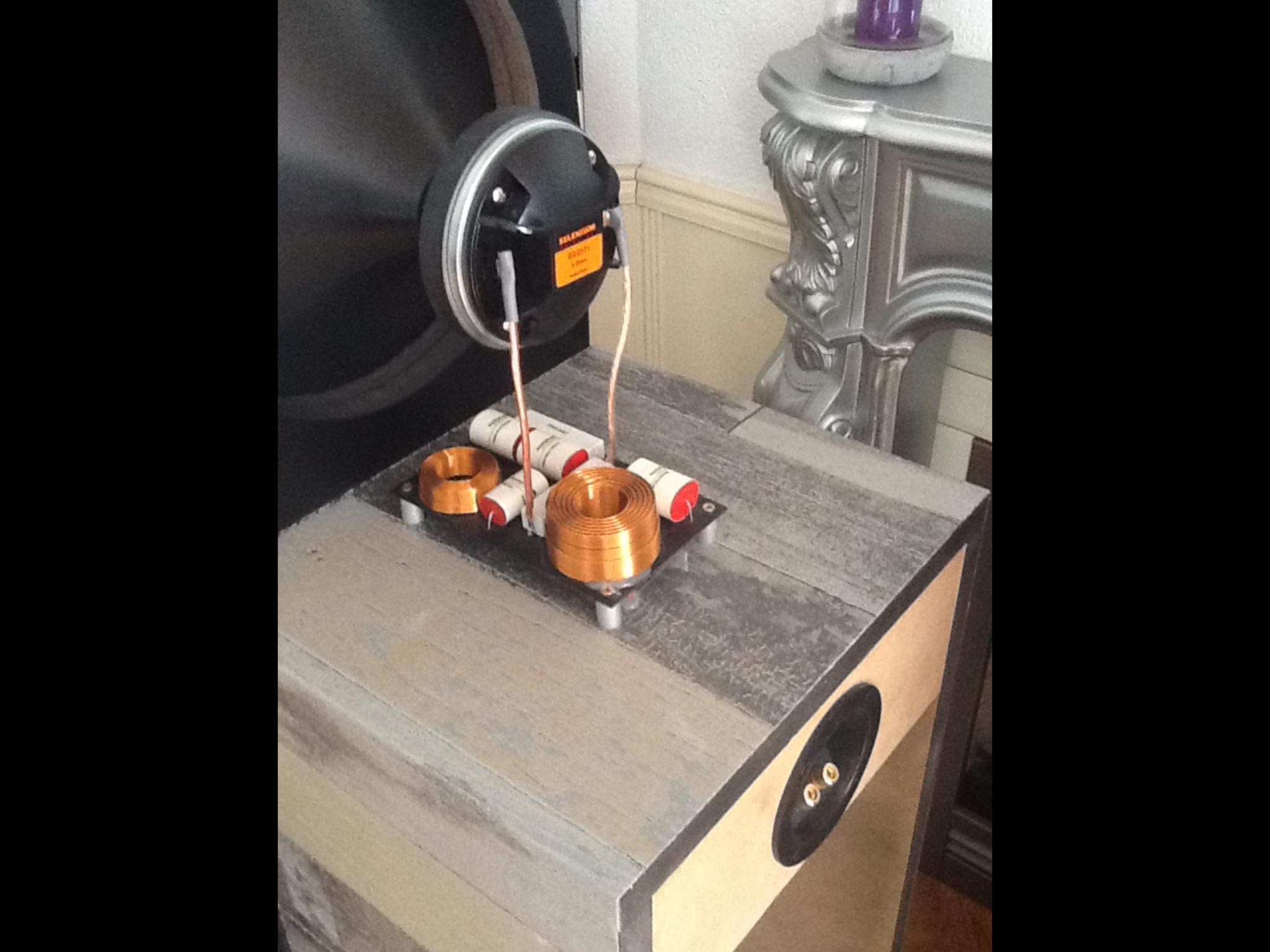

I used eminence alpha15” 2x and selenium d220ti with the 300b.
A well known design is with coaxial eminence.
https://www.diyaudio.com/community/...ade-modification-options.359407/#post-6324406

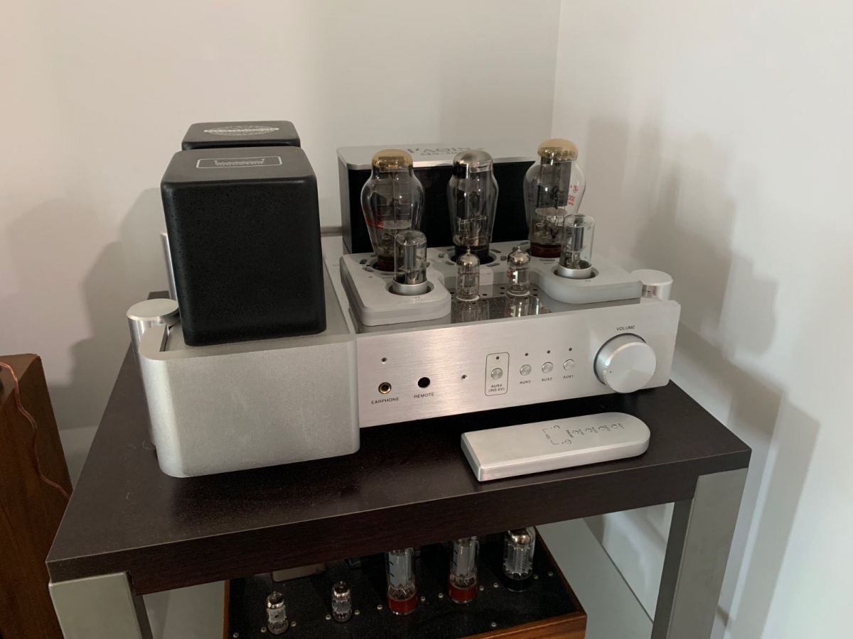

My 300b is a type which churns out around 11 Watts single ended Class A.
(monoblocks made by Diyhifisuply, the Lux mono max)

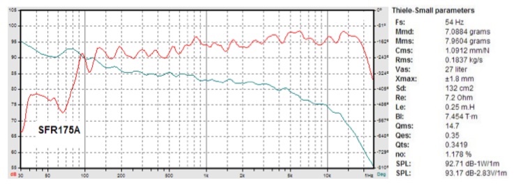

These are the Thiele parameters for the Sonido SFR 175/A drivers i am looking at:
Would this work?
The Qt is a bit low if accurate, but what I did was use a cheap 25 ohm pot to dial them in, then replace with fixed resistor(s); otherwise the HF might be too 'hot', so may need to damp the dustcap to 'taste' 😉.
