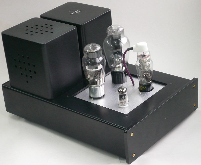

My system consists of an ELEKIT 8500 preamp
Elekit 8200 AMP running 6l6 tubes
MA Alpair 10.3 inside one of their basic bass Reflex designs
A RIPOL Subwoofer ( Do a search for "jazzman diy electrostatic speakers" )
Mini DSP HD
a craigslist found Yamaha integrated amp converted for subwoofer duties ( 140 watts per channel into 4 ohms ) ( the connector pins were pulled and the DSP runs direct to the PWR Amp )
The DSP runs flat for the Mark Audio drivers
Crosses over at 80 HZ at 12 db roll off
This way the Mark Audio Drivers/ Cabinet never approach their resonance point and prevents the RIPOL from developing any cavity resonances.
After many years of trial and error, this seems to check most of the boxes.
