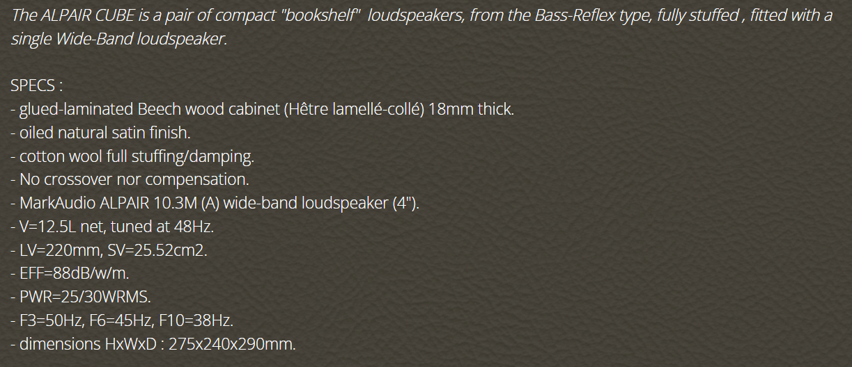

Compact, bookshelf-use, good tone, but low efficiency : that's the price to pay... These are now owned by friend, who uses it as secondary units with SE R120 triode amps.

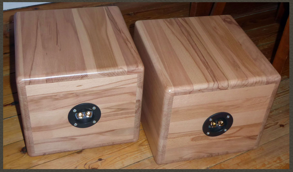

I use Oiled Glulam Beechwood for my cabs...

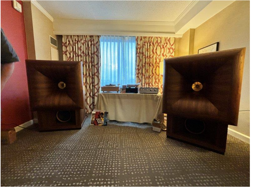

P.S.: large front horn / back loaded horn combination enclosure with a Sonido 8 inch fullrange driver in the field coil version and your tube amplifier, could really work
if you really focus on high sesnsivity you should consider something like this one
I heard these at the recent Southwest Audio Fest. Semrad Audio. I wasn't sure what to expect, but wow. They amazed in many ways playing Blue Note jazz records primarily. I asked for some classical and they also impressed on piano. I had my son with me with hearing up to 19 Khz and he didn't detect bothersome colorations or problematic high frequencies. I had brought him to the Zsu audio room and he (as he should have) found them terribly colored. He also felt the Borresen speakers had excessive highs, this consistent with measurements that I have seen. The horns are a JMLC curve...
foto is missing, here:
difficult to built, but the large front horn helps a lot for high sensivity
hope it helps, Stefano
At HF i doubt there is any horn loading … a horn maxes out at <4 octaves (exclude MEH)
