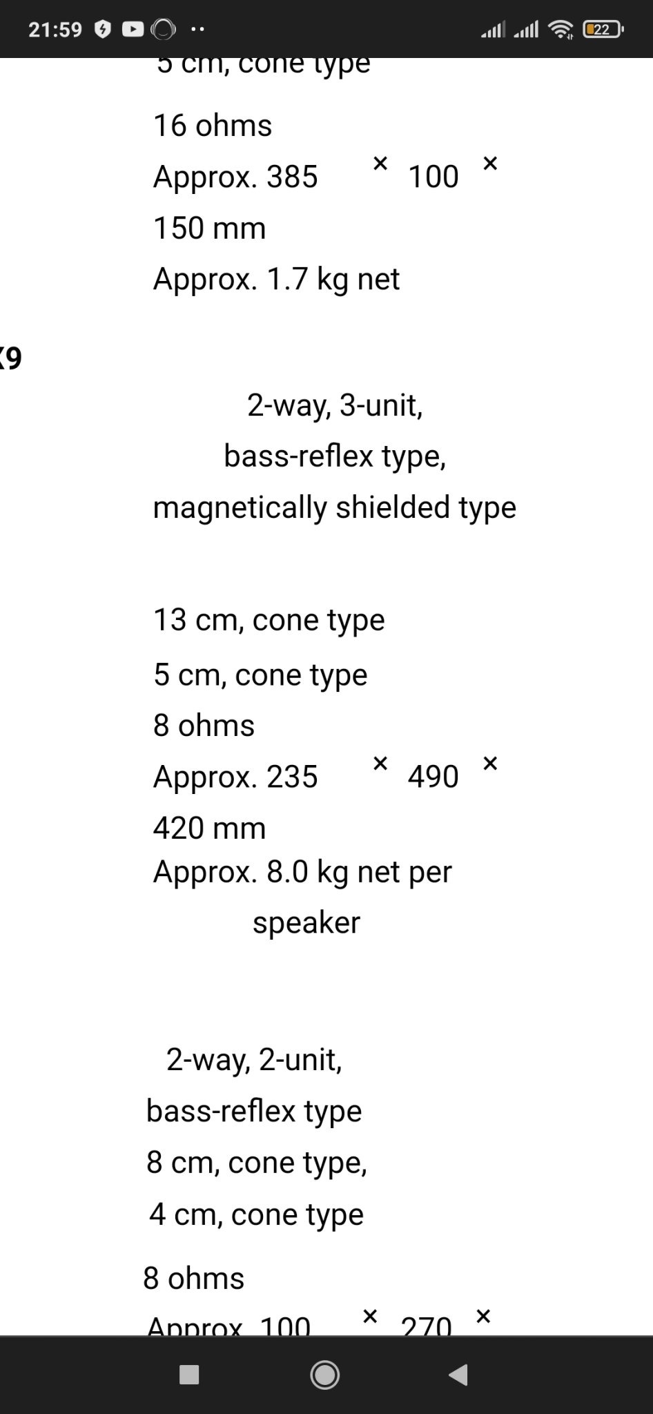

Hi guys . How are you ? I just got pair of flx9 speaker and tested it with original sony s9 amplifier . It sounds very better than s9 speaker . I think basically these 3 pairs i test are nearly same . Sony s9 dp800d flx9 all of these just have a simple capacitor . May i ask is there a simple crossover that i can make for getting better sound without measurements ?
I think s9 speaker isnt 3 way its a 2.5 way or same az flx9 .
I can make inductor and have access to normal capacitor.
