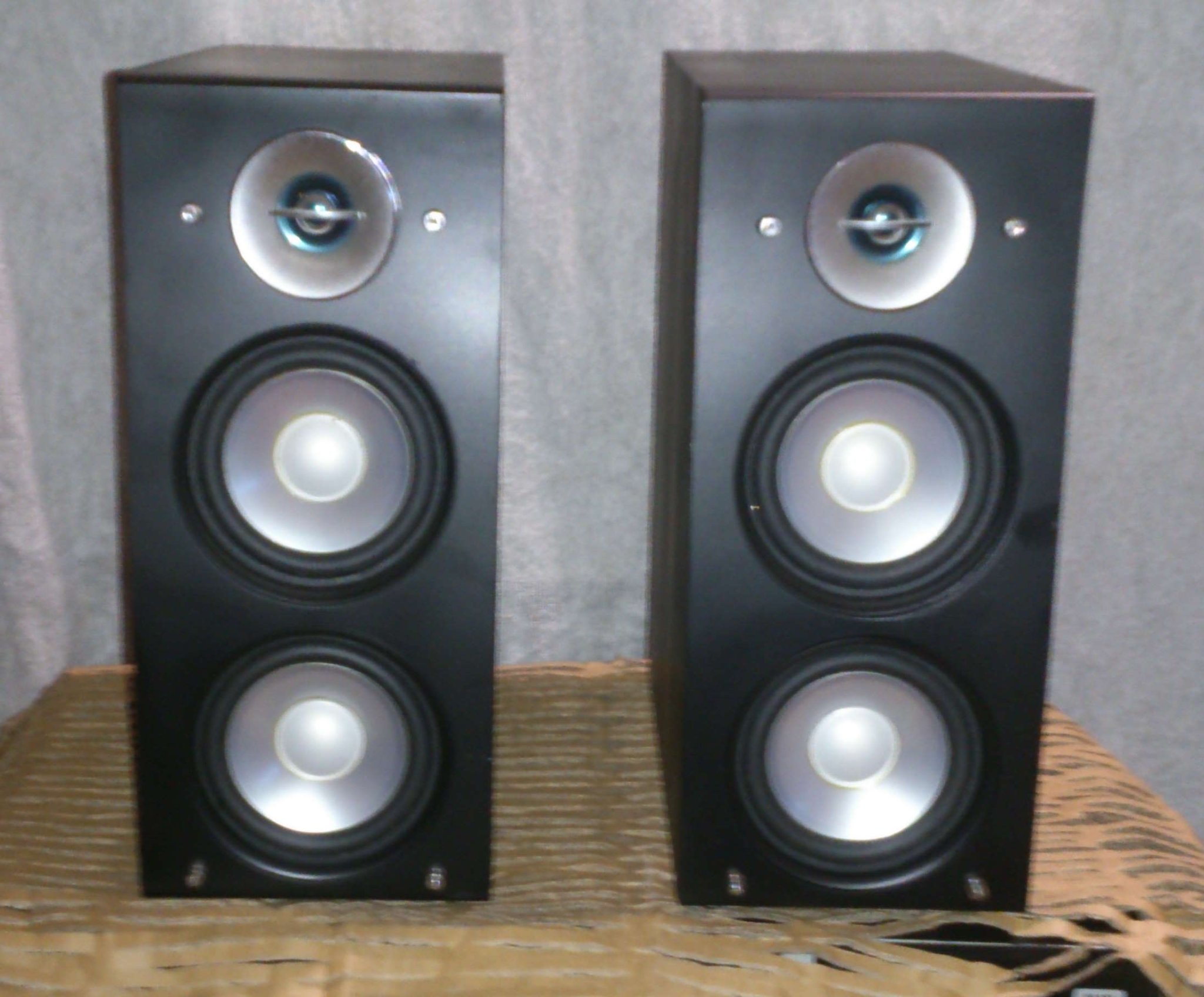

Yes, I agree with this.I believe many have gone down a rabbit-hole. The SS-S9 is not a 3-way speaker. It's a 2-way. The 6" woofers are identical, one has an inverted dust cap to make it look subwooferish. They sound okay although the cabinet is probably too small for the drivers.
Throw in a little damping, replace the cap. They should brighten up a little.
After seeing all photos I now understand the speaker and its very low quality.
A single tweeter capacitor is all they deserve. Adding a louder tweeter is a maybe (?)

I'd like to thank you all for taking the time to indulge me with my little experiment, You are correct $20 speakers aren't worth the effort, however I was simply interested to see if they could be improved as the drivers looked half way decent. Anyway, as I mentioned earlier, I'm 66 and have industrial hearing impairment and after some experimenting with other high quality speaker, I have noticed that I actually can't hear any of the tweeters at all LOL. But I can hear most if not all of the mid range and this is where I think these speaker are lacking.
Me thinks a mid and low range crossover may be what's needed. Just my humble opinion.

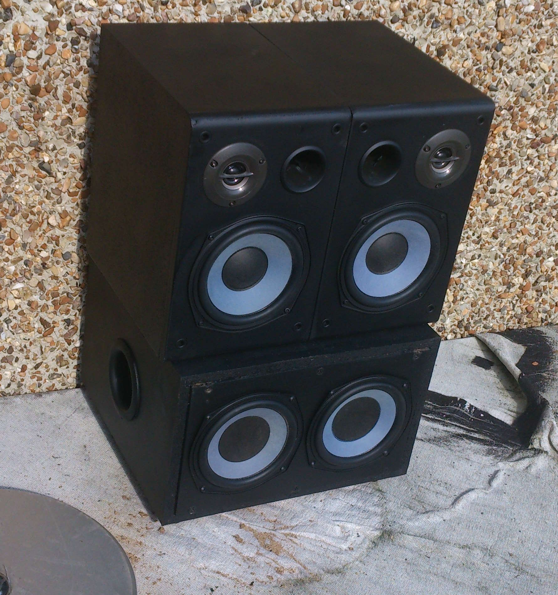

I know these things. I have their baby brothers.
I rescued their cousins from a dumpster . . .
And used the drivers for a 2.1 system.

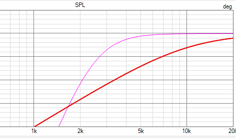

2uF itself does bring the response down a lot, here compared to a common LR4 @ 2k5
Edit: 5dB/div, sorry I cut that off.
