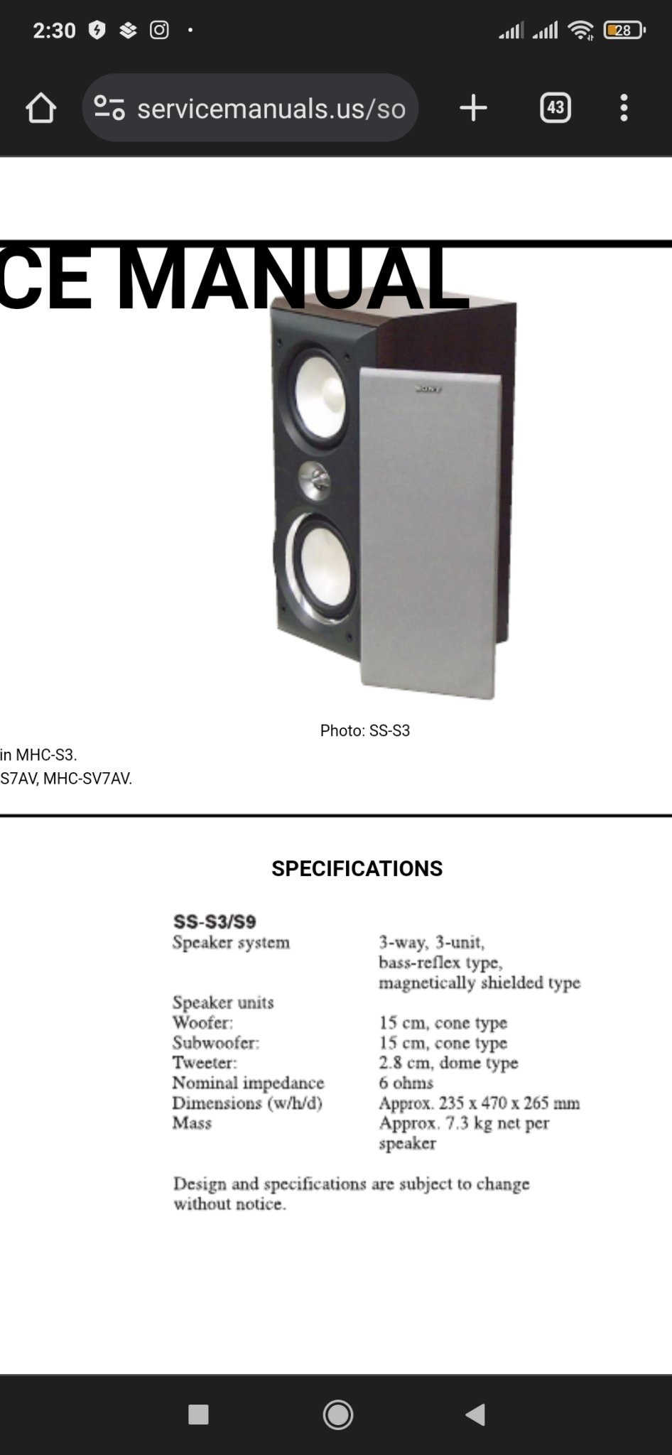

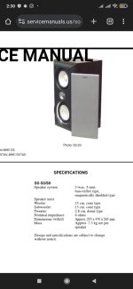

It says 3 way 3 unit on service manual of s9. But flx9 says 2 way 3 unit . Flx drivers are exactly same but s9 has a cap on one of drivers . I think they just used these drivers in different boxes without any crossover how it could be 3 2 or 2.5 ?!

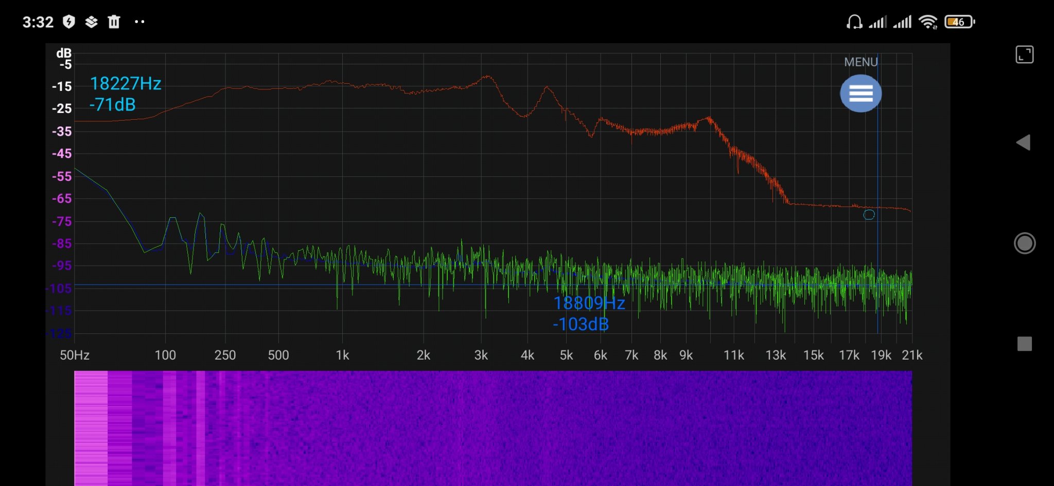

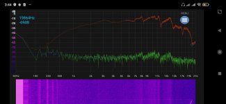

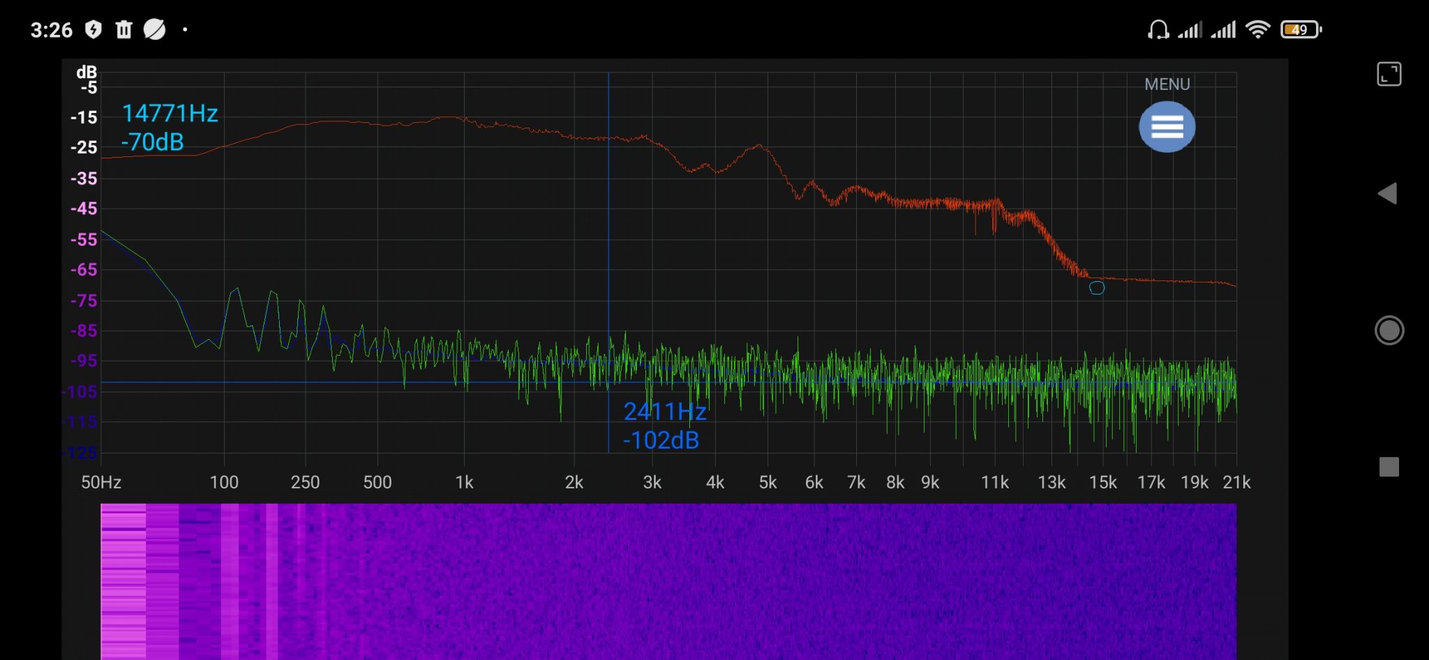

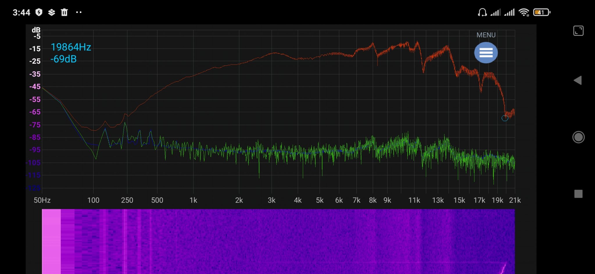

These are first test . Subwoofer woofer tweeter . First time i do that i dont know i do it right or not . Attach a razr gaming headset microphone to smartphone . Play 20hz to 20khz from pc .
I don't know my friend . Its says 3 way on manual of dp800 and s9 . Driver's look like each other different boxes . Other is flx9 with 2 exactly same driver it says 2 way on sony website . But as our friends said without crossover these means nothing . Also hear same sound on 2 drivers with cap and no cap i think sounds different .Will you make a 2,5 crossover sohra?

The dip above 14kHz is most likely due to the microphone. The rest is OK at first glance. Mid bases have a natural roll off above 3KHz, they probably don't even need a crossover, just to fit the tweeter nicely wit that one capacitor. It can be seen that they are not identical, one falls earlier than the other.These are first test . Subwoofer woofer tweeter .
Measure the entire loudspeaker at a distance of 1m in the axis of the tweeter.

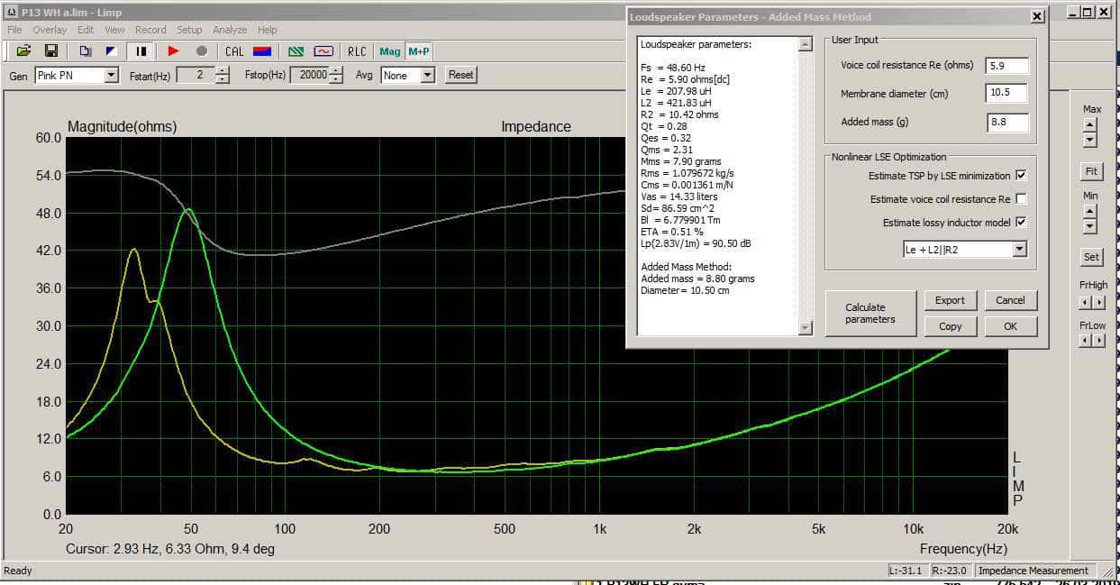

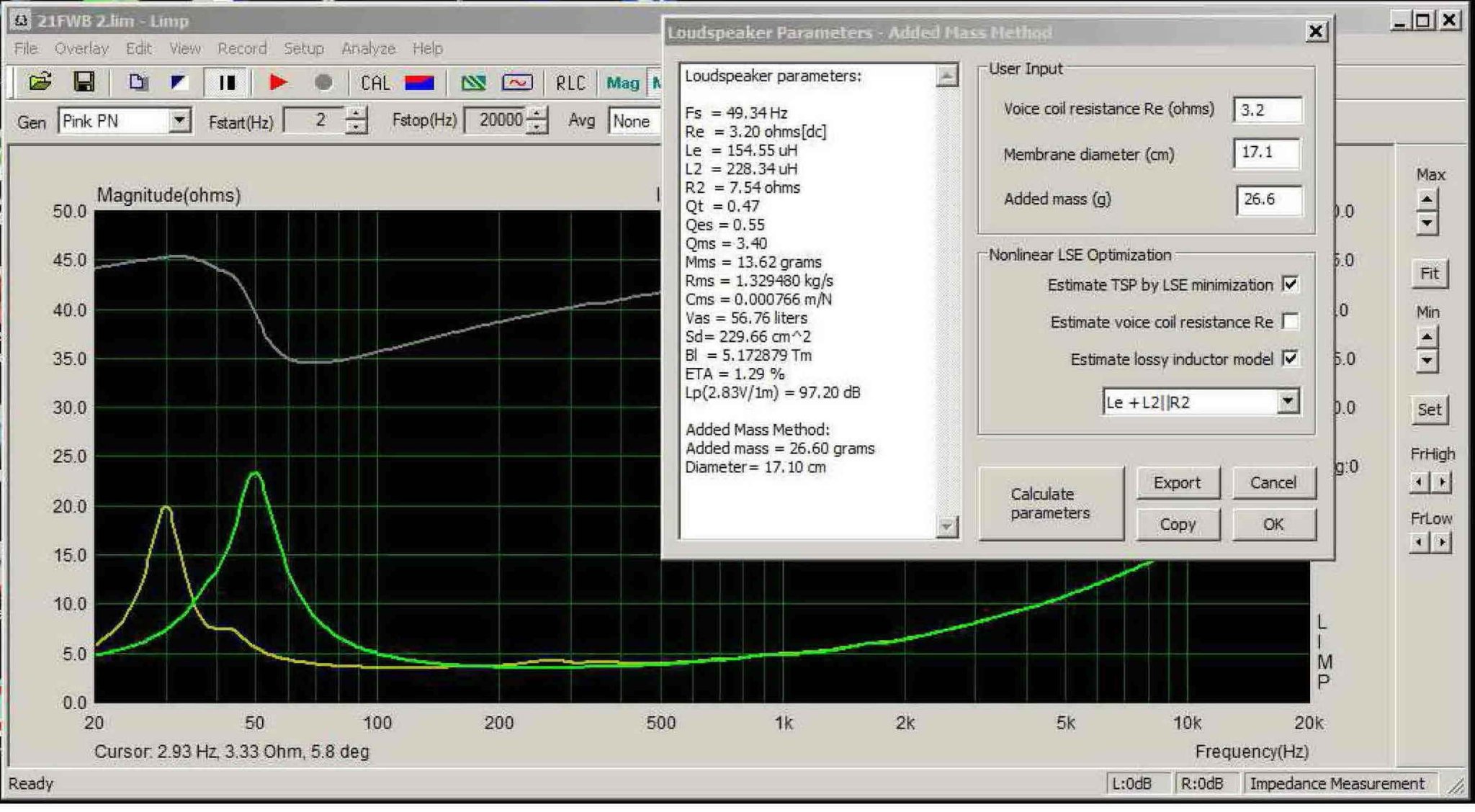

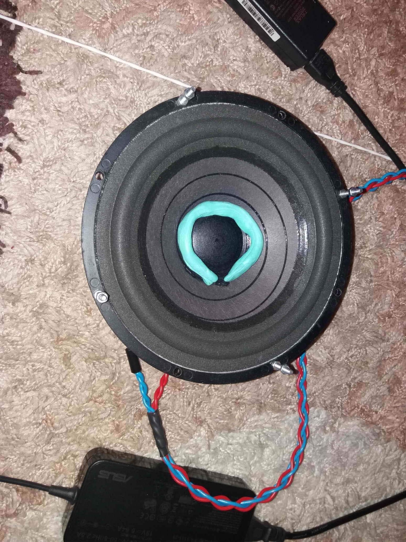

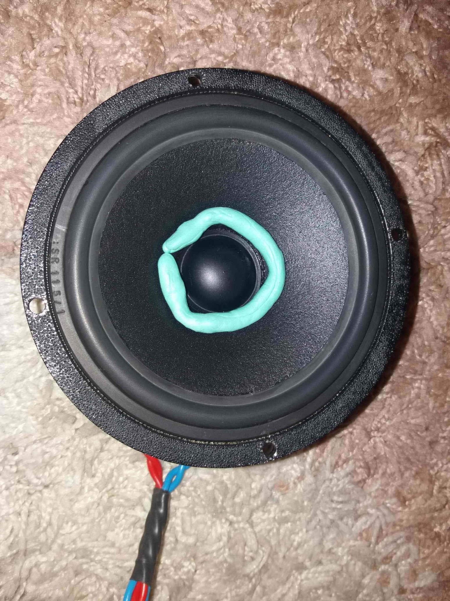

Shown here is the measurement of driver impedance and TS parameters using a PC audio card and headphone output. The additional mass method and ARTA (LIMP) software were used. I use the same, I just have an additional small amplifier, JIG and an external sound card. Probably not the most accurate measurement, but still very useful for choosing the volume of the box. Better something than nothing. 🤣
