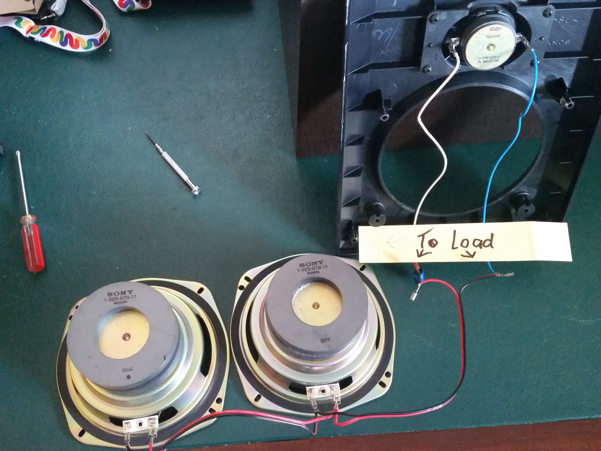

Both tweeters are 8.3 ohms, I will ad a circuit diagram of the actual lay out.All of this only makes sense if the tweeters are fully functional.
BTW guy, just to remind you all that I'm a complete nub regarding speaker, inductors and frequencies, and the terminology that goes with it, so you may have to dumb it down for me some what Lol.

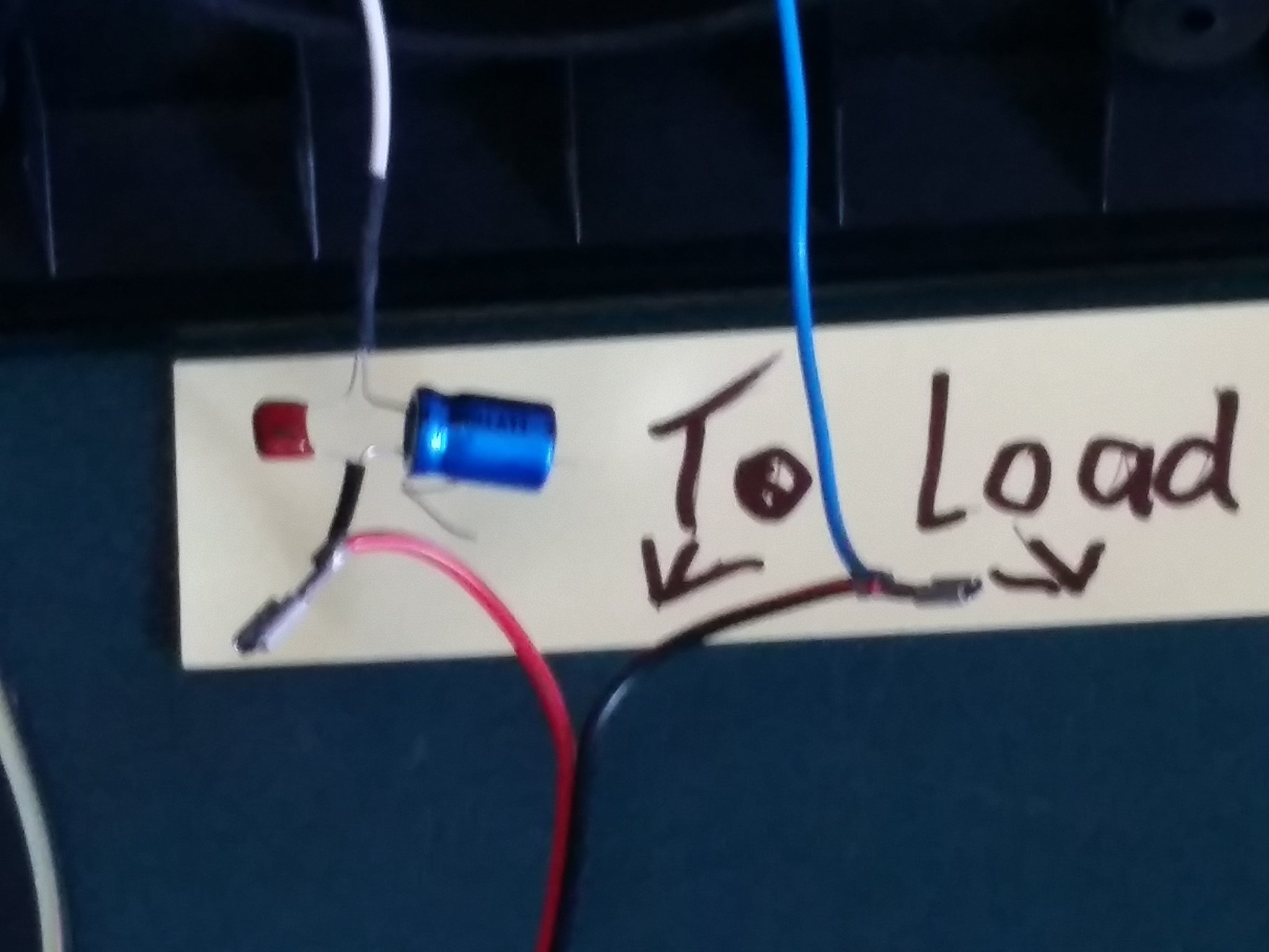

I think that upon further investigation > you will find that only one capacitor is used for the tweeterhere's the circuit.
and the other capacitor is used for the midrange. Otherwise, something is definitely wrong.

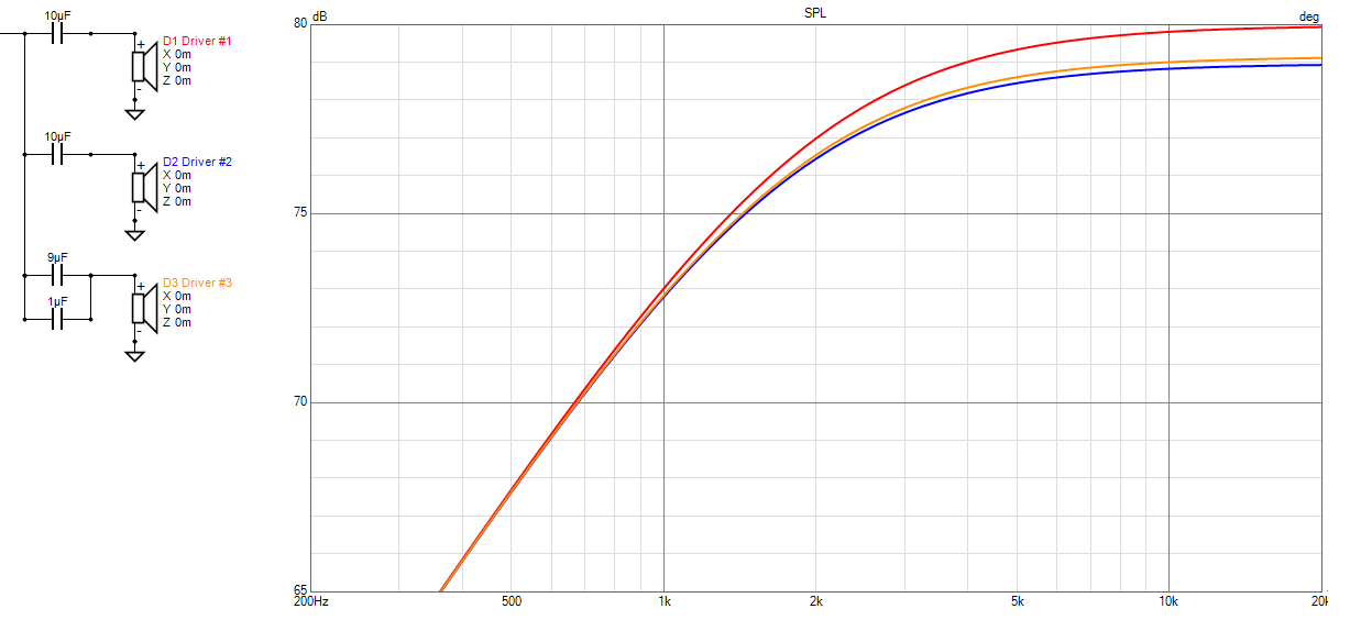

The problem here is that it lacks a bit of mids and highs, so I suggest a simple trial with a lower cutoff frequency by adding 1uF to 1.8+0.33.
Bypassing is a common practice at radio frequencies.
In this example.. Red=(10uF+0Ω) Blue=(10uF+1Ω) Yellow=(9uF+1Ω)//(1uF+0Ω) |

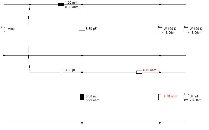

Anyway, here's my (simplified) solution to this wretched but interesting Sony SS-S9 problem:
Maybe one might need to fiddle around with the precise resistor values, but I think it will be an improvement on a loudspeaker clearly designed for low cost rather than high quality. 🙂

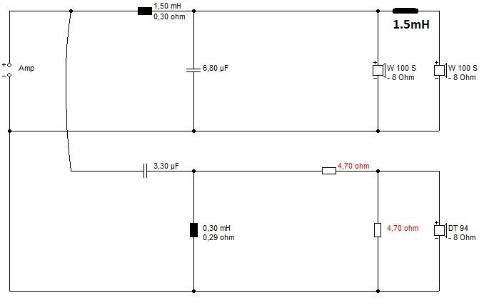

This is getting unnecessarily complicated. No one can make a meaningful crossover with unknown speakers. Get two 3.3uF capacitors of any kind (polyester, polypropylene, polycarbonate) as long as they are not electrolytic and put them in place of the two factory ones. Or 2.2+1uF. There will be a little more mids and highs in the sound.
Where is 'by the fanatics for the fanatics' spirit?
Simply doubling the cap to tweeter may lower the crossover frequency, hence produce more highs, but it may sound more distorted as tiny tweeter will be strugling.
