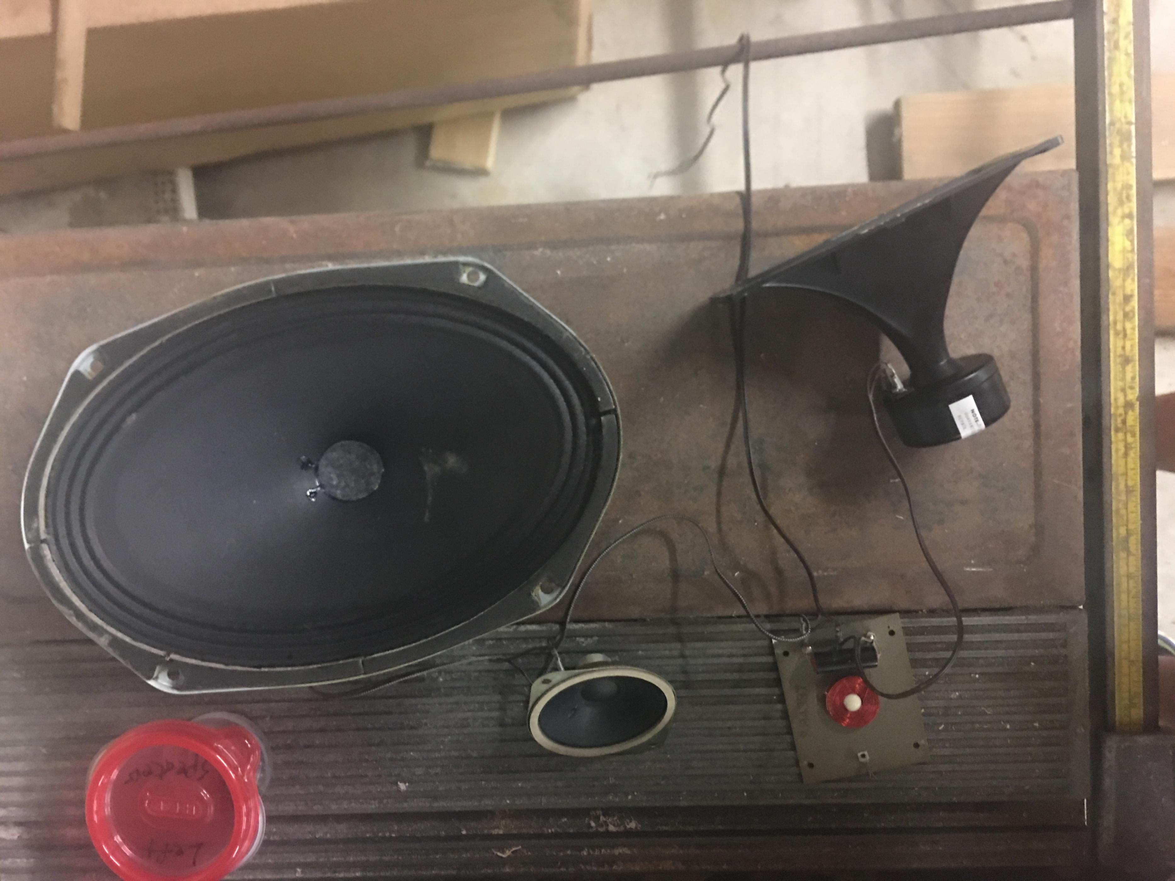

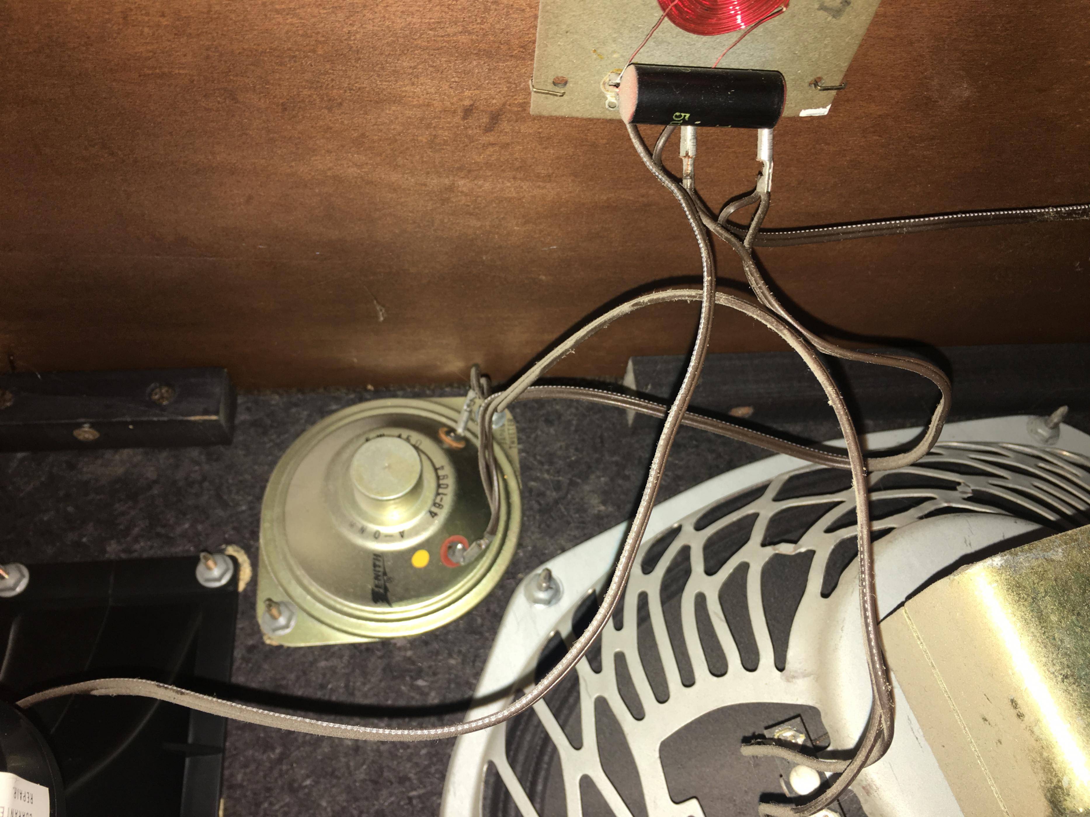

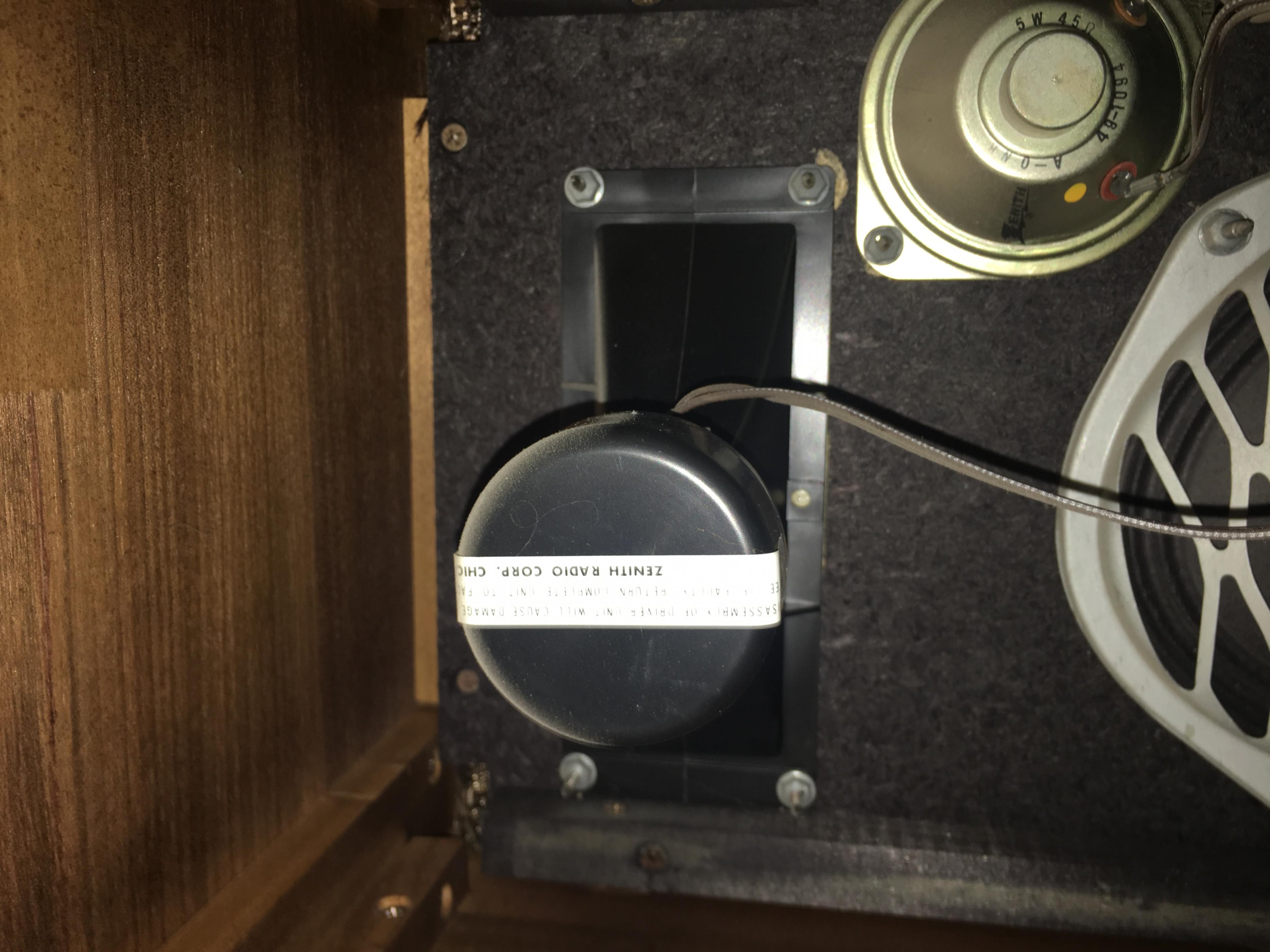

That's a very simple crossover for a three way speaker. I've been trying to follow the wiring shown in your photo in post #1, but can't see enough of the detail. Could you make a drawing of the circuit?
If there is any chance that the existing capacitor is an NP electrolytic then I would certainly change it in case it has deteriorated, but I agree with the previous posters that an exotic replacement would be overkill.
Is the horn a piezo?
If so it may not have any XO components at all
A 5uF capacitor implies that the ovoid driver is doing all the midrange

That looks very likely. Perhaps jmhitchcock will tell us if it has a magnet or not. I'm still puzzling over the wiring in the photo though!

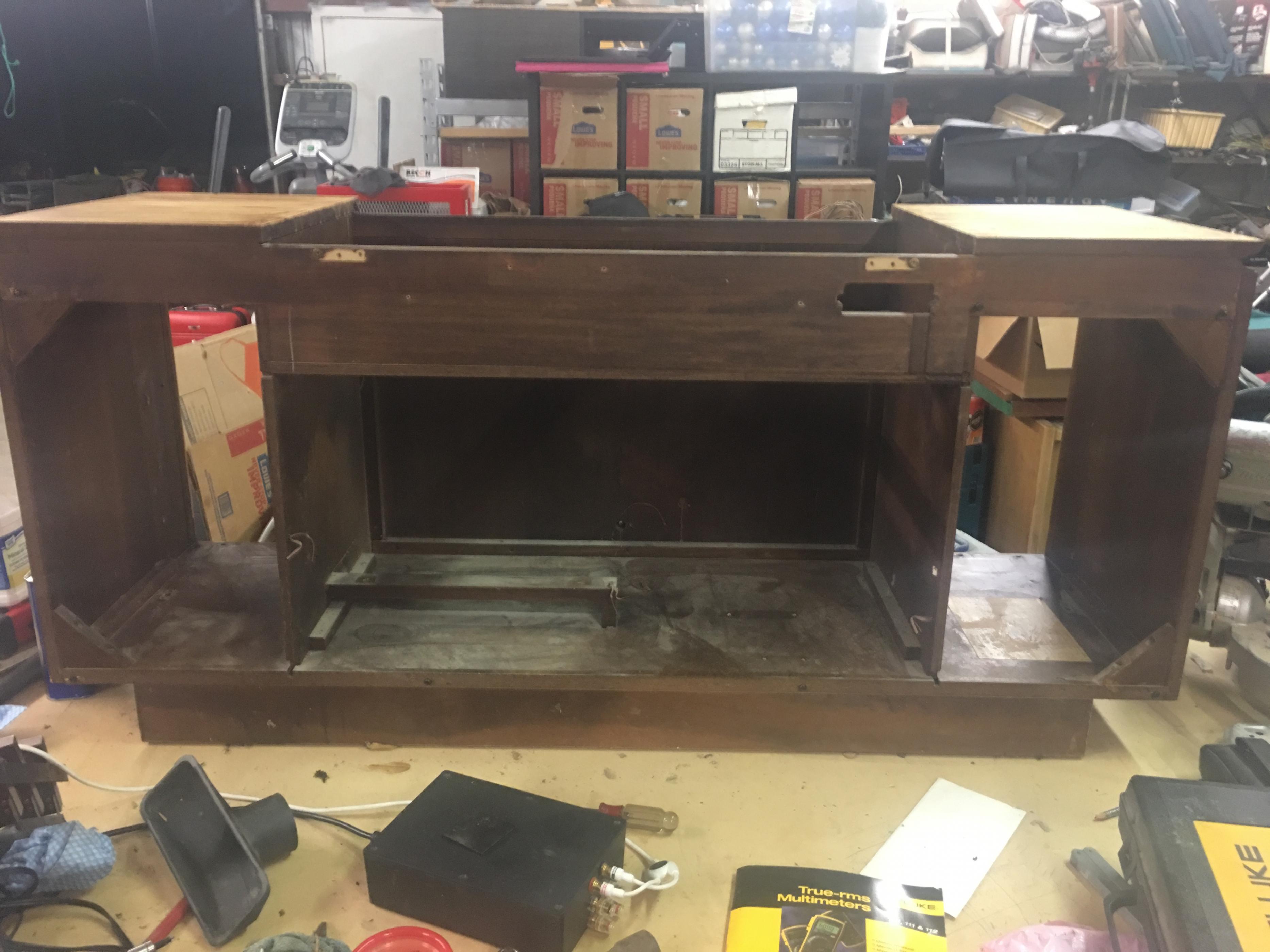

I’ll go out to the garage and take some pics of the horn and crossover wiring once the kids go to bed.

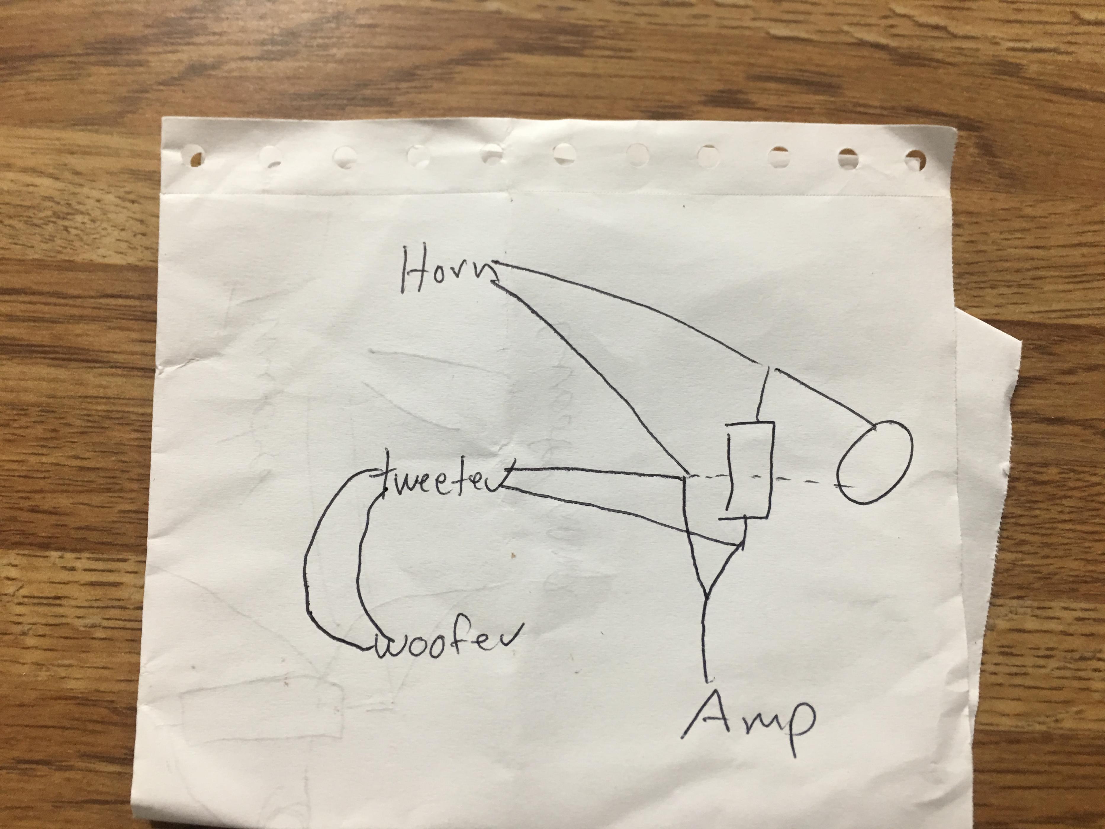

Pardon my rather crude drawing of the wiring. Let me know if it helps or doesn’t make any sense at all. I also added a pic of the horns.

No way is that little cone working full range, at the most those can handle the 5 watts rating with a cap in line. I am confused but I took it to be a series XO with the piezo
That small, closed-back tweeter that Zenith used, likely has a 30 to 40 ohm voice coil - I've come across them in doing console work at the shop.
Zenith had some odd setups through the years, I never could figure out some of it.
But I suppose it's to justify their marketing/advertising, - the more speakers, the better.

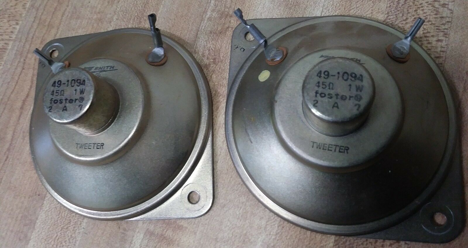

That small, closed-back tweeter that Zenith used, likely has a 30 to 40 ohm voice coil.
Yes wiseoldtech, it can be seen in the photo that it is a Foster 49-1094 45 ohm tweeter.
It is definitely wired in parallel with the 'woofer' and that is what had me puzzled.
Is it because of its high impedance that it is not overloaded by the bass frequencies? :confused:

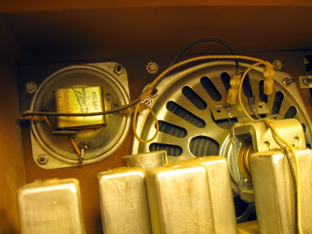

I've seen similar tweeters which carry a third terminal from which a 2uF capacitor connects to the voice coil terminal in order to supply the high pass filter as shown in the attached image of the Zenith radio..
Here's a link to the refurbishment of a similar Zenith console. Note the carbon resistor which is incorporated in its crossover!
Repurposing a 70s console -

Please measure DC resistance across small cone terminals, with nothing else attached to them, and post it here.
I suspect it will read "open" , which then might indicate some small series capacitor inside the closed back bell, between it and the actual cone.
Usually those are "outside" as mentioned above, but inside placement is not impossible.
FWIW large Piezo drivers often include a complex crossover and protection system inside the back plastic envelope, besides the plain piezo element.

Those Zenith 49-1094 "tweeters" are just a 45 ohm speakers with a stiff cone, thus favoring treble response. - no need for any crossover caps.
Since they're of such a high ohms, they present little to no load on the whole system.
They put out a weak sound, but as I mentioned before, allows marketing to add an extra speaker in advertising.

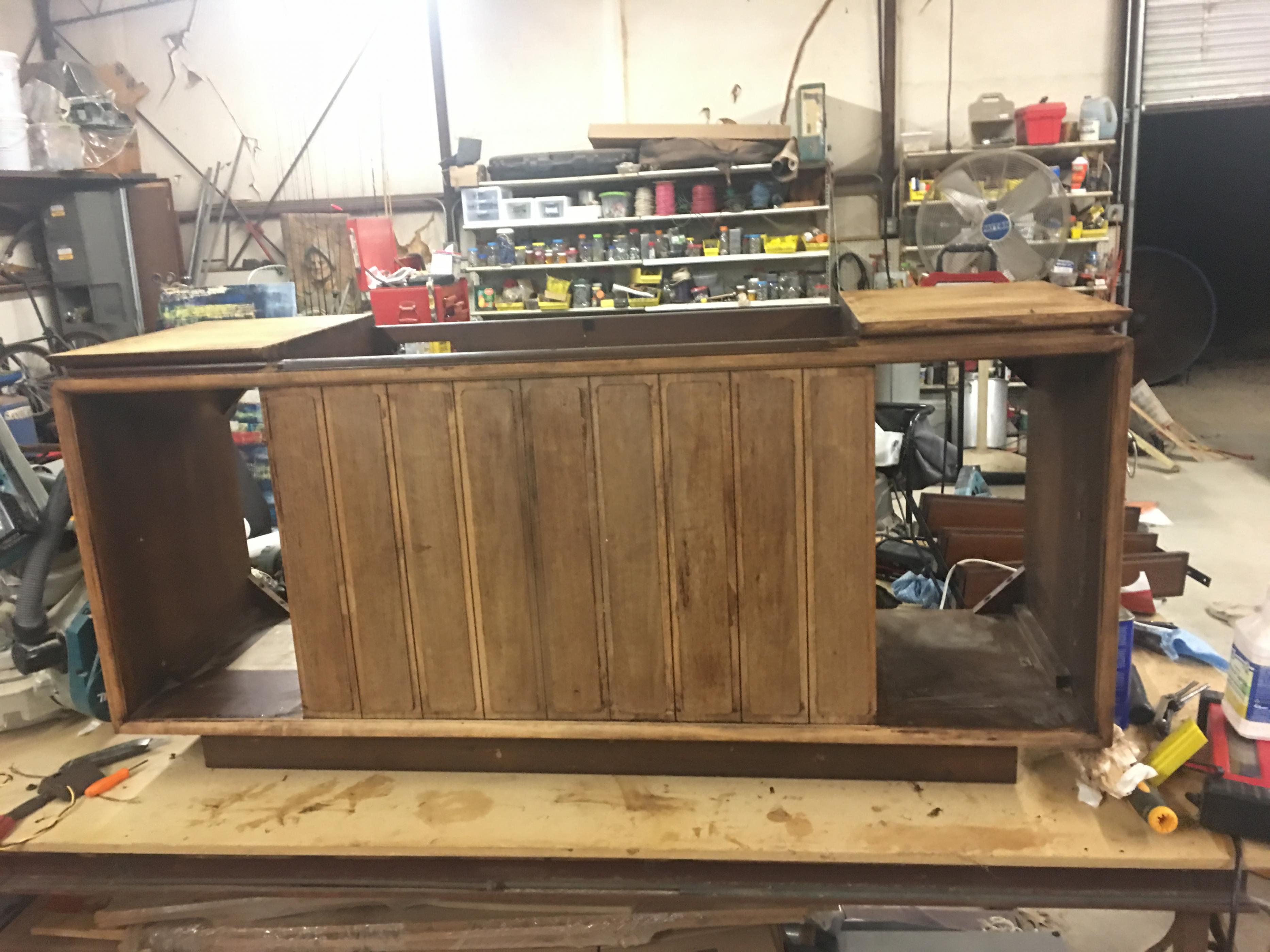

We would like to see how it comes out in the end!

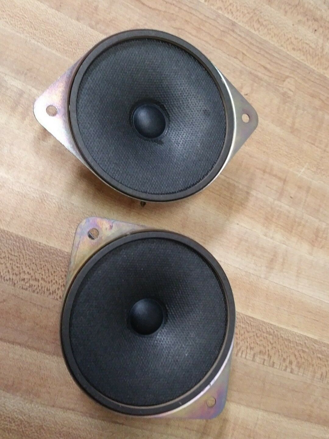

Absolutely! We decided to stick with the current speakers for now. I ordered new caps for the crossover, removed the speakers and started stripping the finish.
This week my goals are:
1) finish stripping the old finish​
2) build the storage compartment where the old amp and turntable were​
3) prep the cabinet for the new stain​
4) Decide on the amp we will use (Leaning towards a sonos amp my friend will sell cheap if I want it)​
