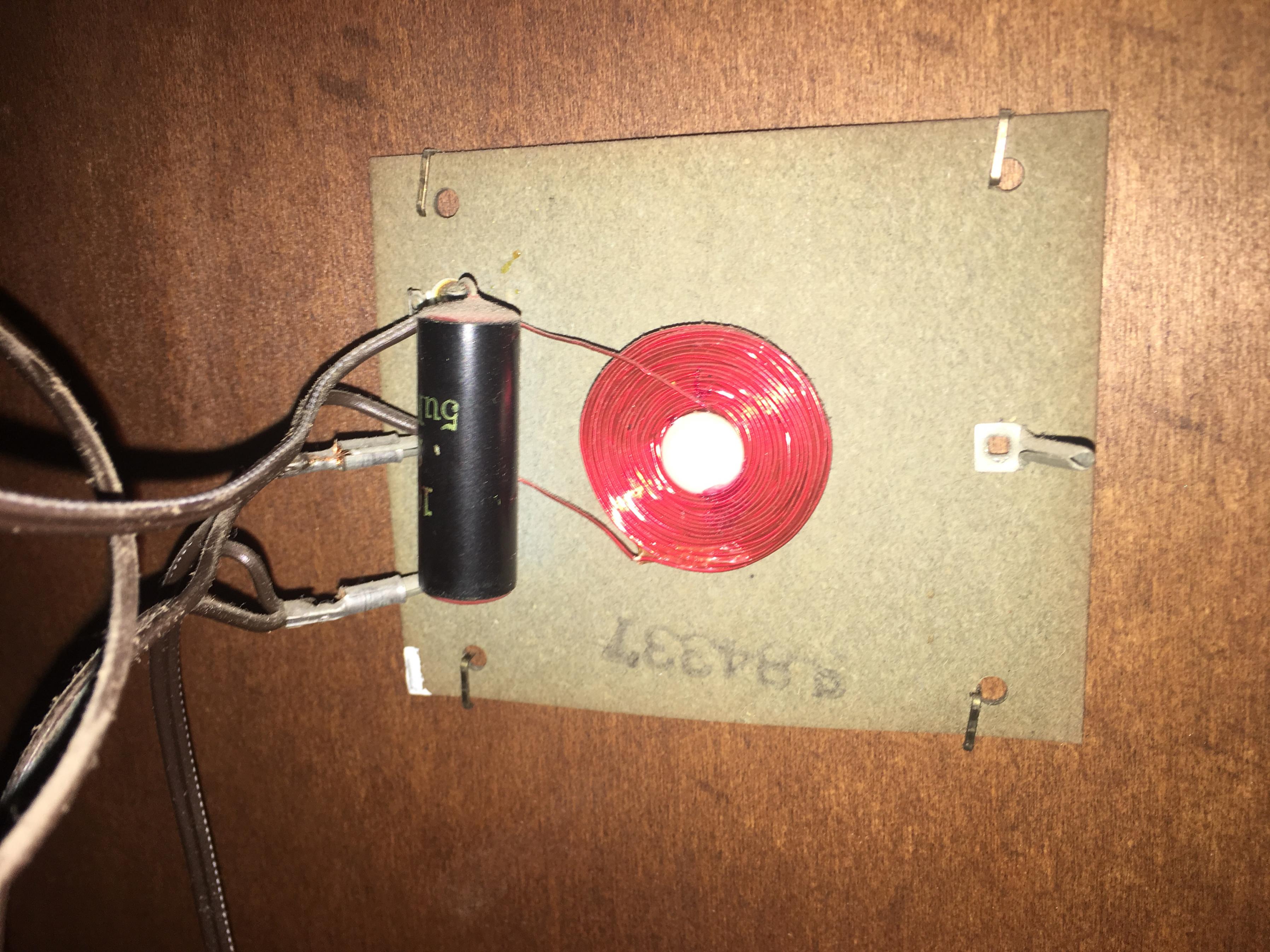

I took a look at the crossovers this morning. They have 5uf-30v caps on them. Any recommendations on replacement caps? I was looking at these at parts express:
Jantzen Audio 4.7uF Alumen Z-Cap 100 VDC Aluminum Foil Capacitor
Dayton Audio PMPC-4.7 4.7uF 250V Precision Audio Capacitor
Dayton Audio PMPC-5.1 5.1uF 250V Precision Audio Capacitor
Any thoughts on these caps? Would I see any benefits from the more expensive foil/film caps? Any other caps I should look at?

If using these crossover components with the original speakers, it's insane to spend money on "high quality" brand caps and chokes, because you won't gain a thing except a thinner wallet.
You can dabble all you want, but with 50+ year old mass-produced Zenith console speakers, it's a waste.
That's a very simple crossover for a three way speaker. I've been trying to follow the wiring shown in your photo in post #1, but can't see enough of the detail. Could you make a drawing of the circuit?

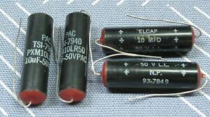

If there is any chance that the existing capacitor is an NP electrolytic then I would certainly change it in case it has deteriorated, but I agree with the previous posters that an exotic replacement would be overkill.
Yes, the capacitor looks like an ELCAP to me - black body, both ends caps red (I think that's dust on the top cap of yours).
I would definitely change this for a modern equivalent as these do not age well.
