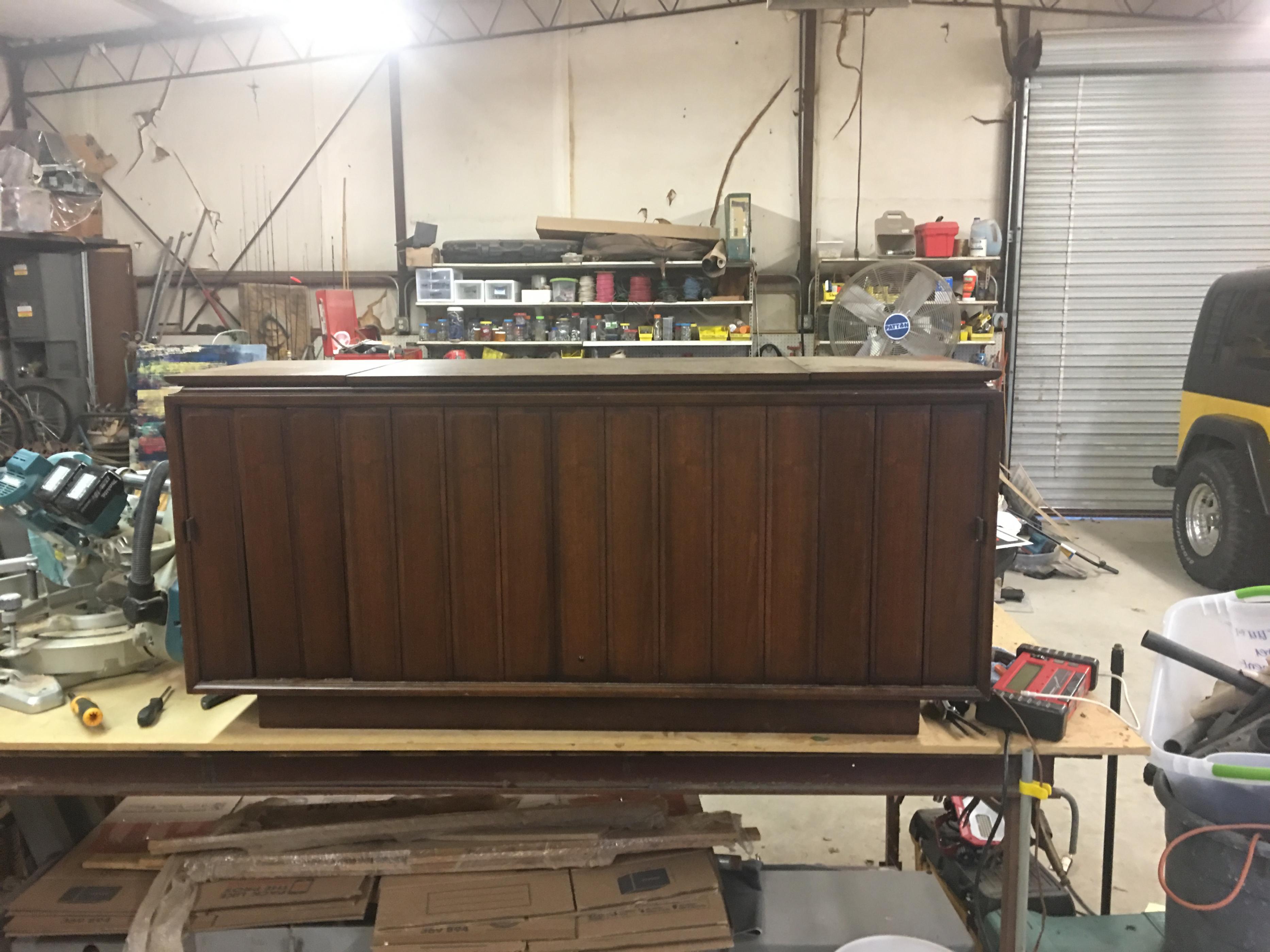

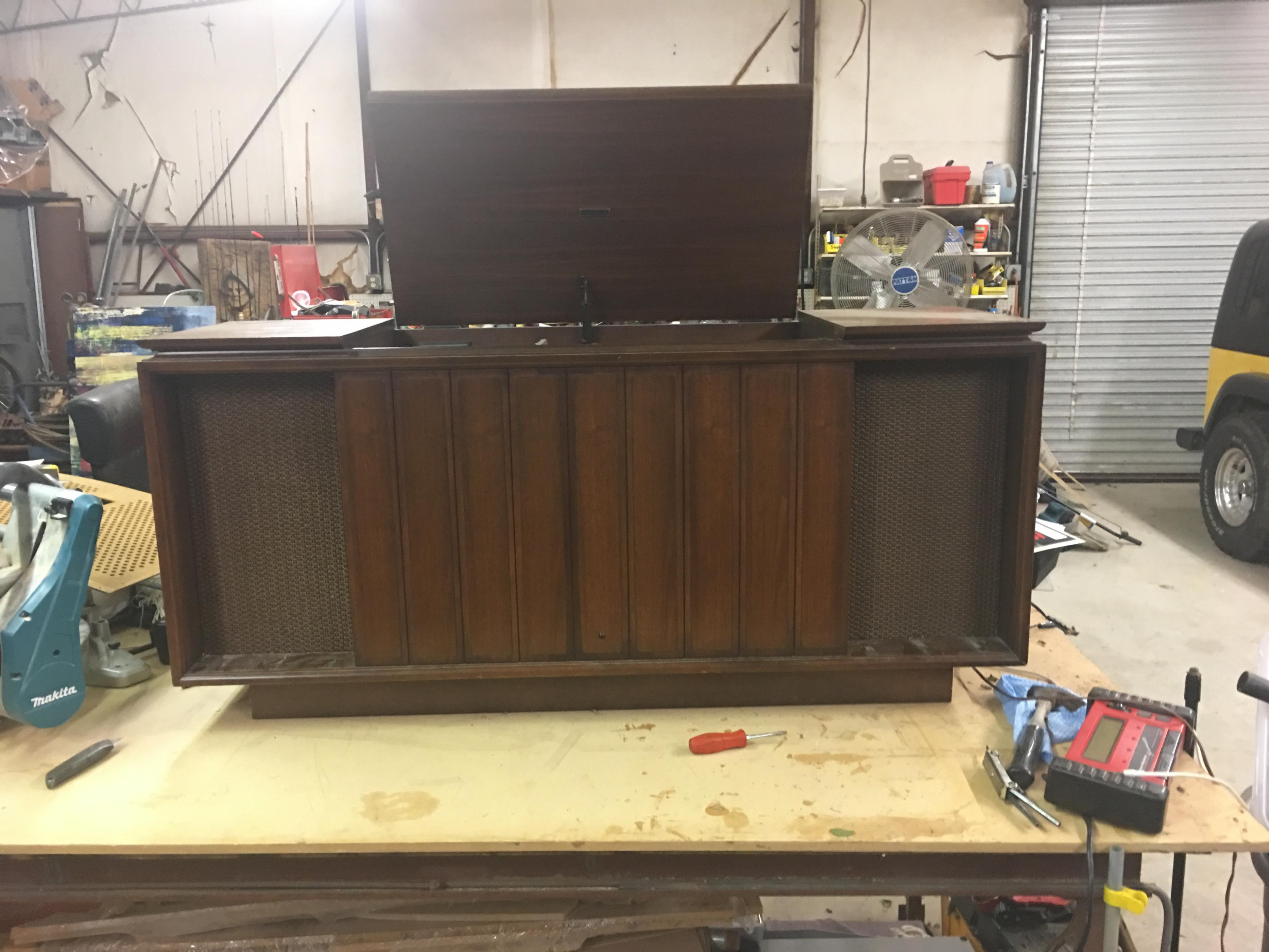

I'd like to see pix from the front also with the grills removed
Unfortunately its at my parents shop where I will be working on it this summer and I don't have pictures of the front off hand.

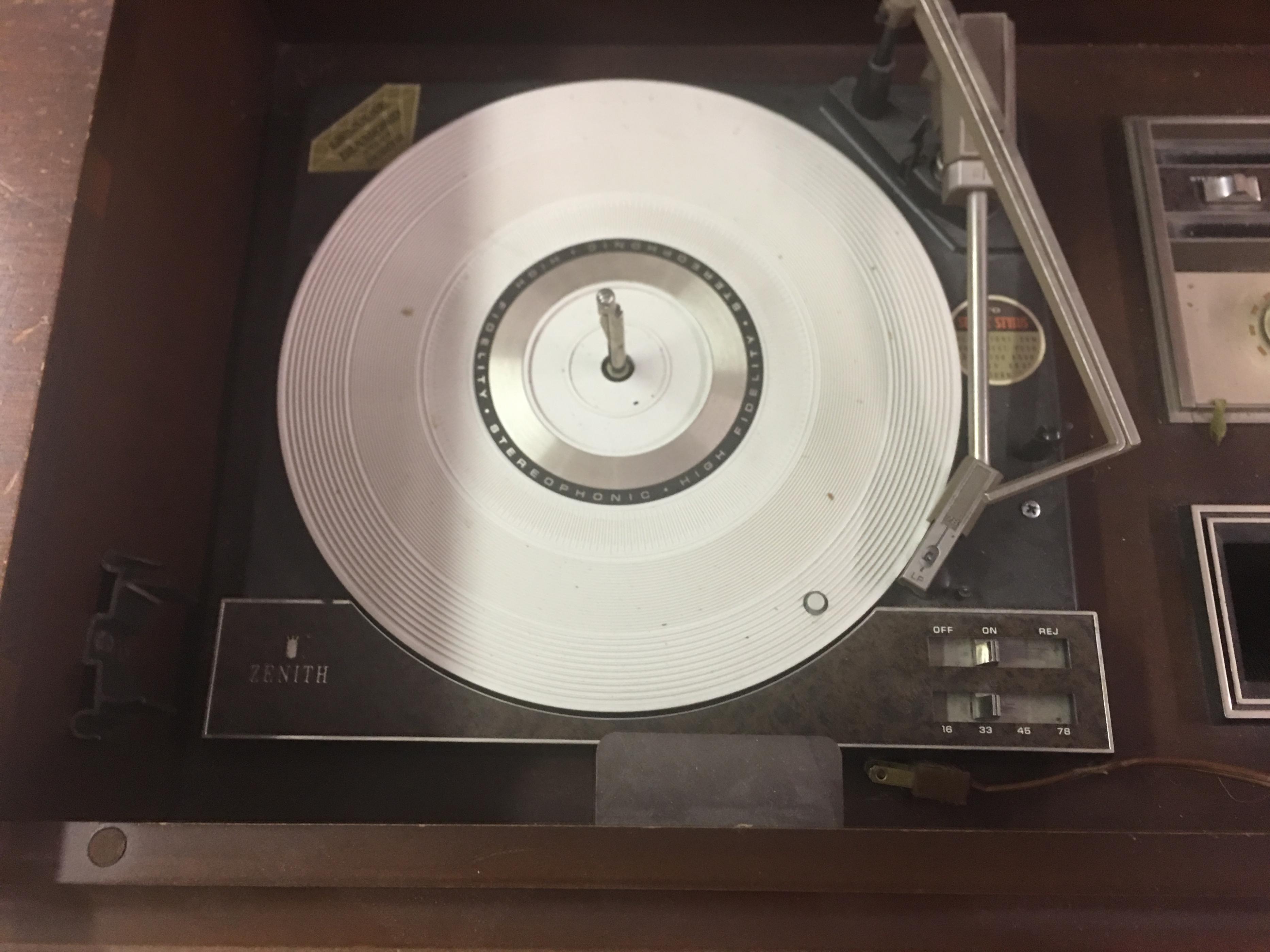

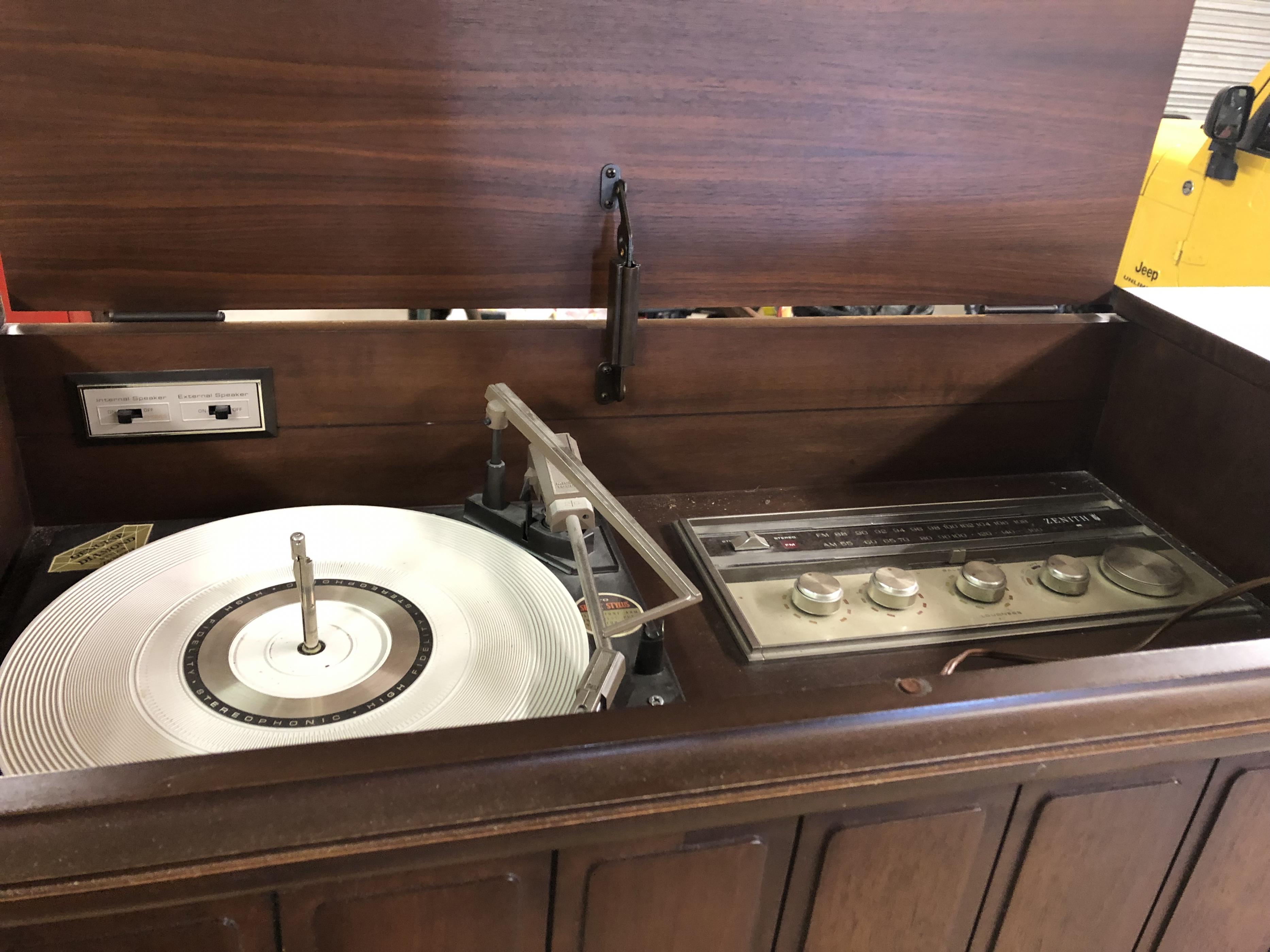

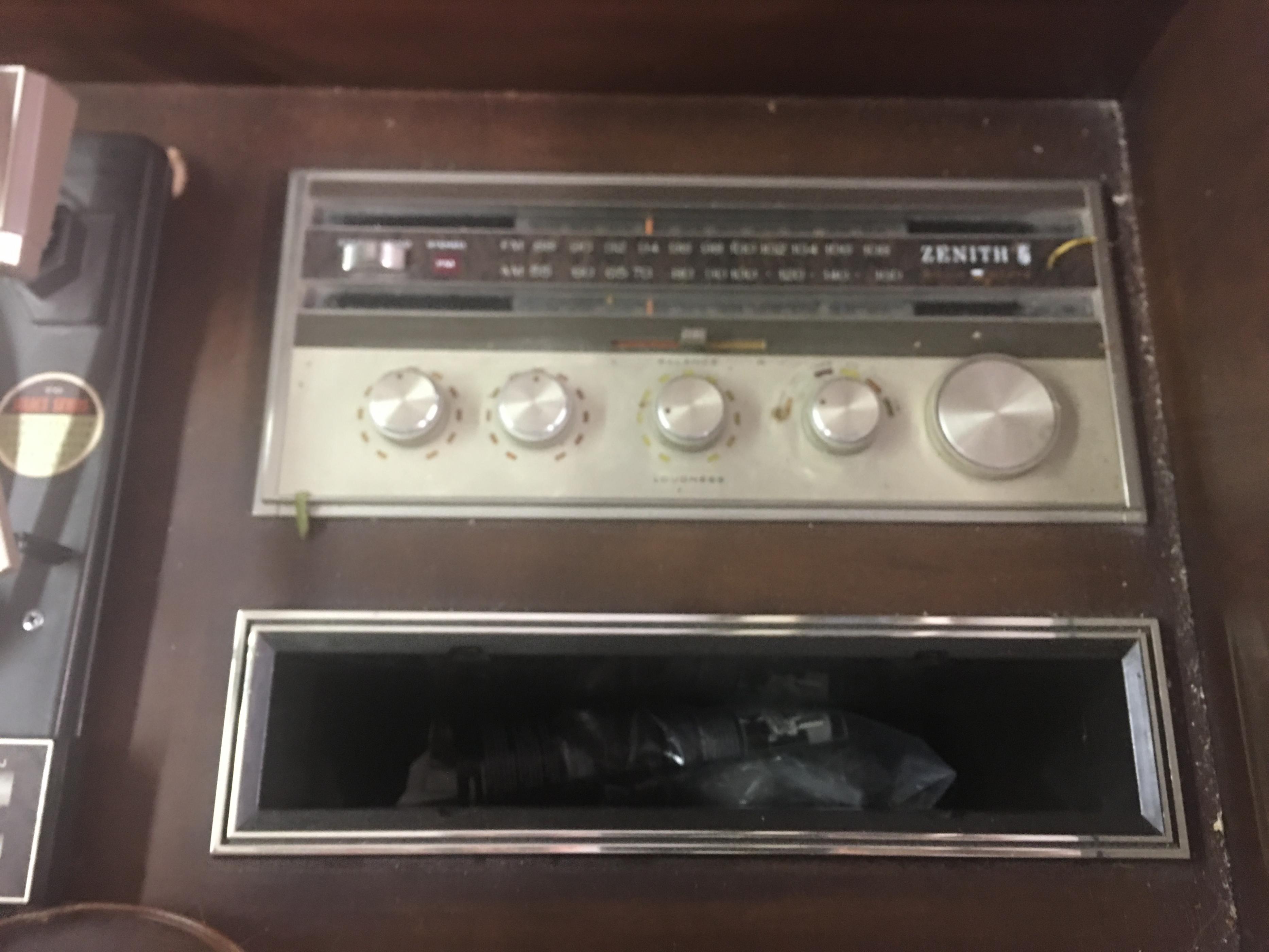

I'd LOVE to see a photo of the front and inside where the turntable is... 🙂 🙂 🙂
It took a while to take these but here you go:
