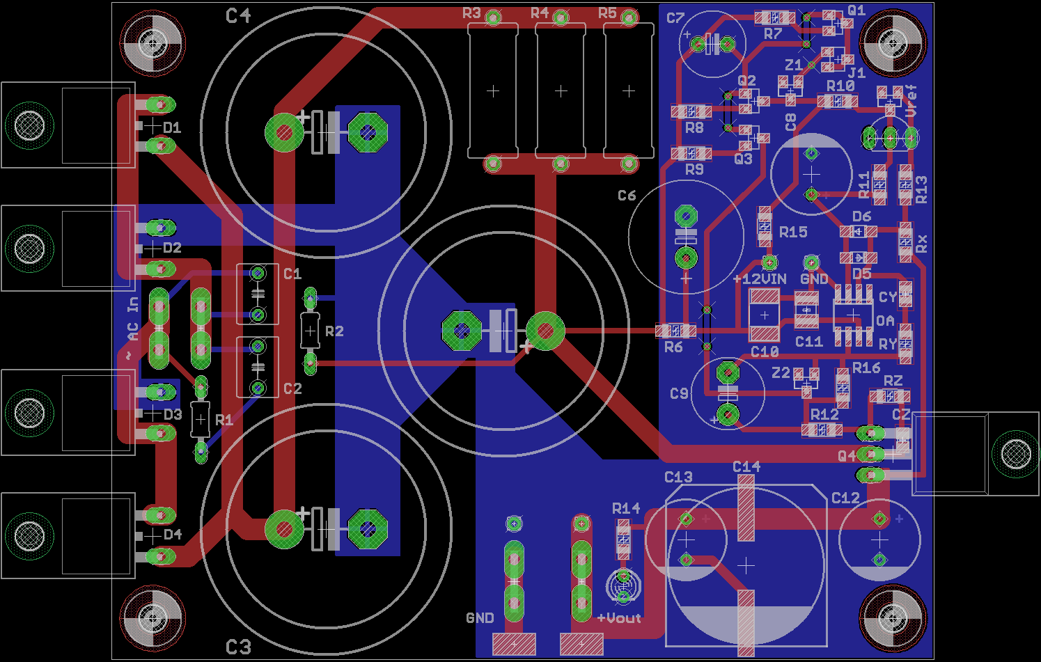

That +Vout connector blade (white arrows) cuts a big slot in the blue plane, perpendicular to the direction of current flow. Undesirable.
Why not add some more blue, above the slot, giving more of an unimpeded pathway from the Gnd connector blade, to the remainder of the blue plane? And also from the filter cap ground point, to the remainder of the blue plane.
Suggest adding triangle and rectangle.

Ok thanks a lot guys. Revised version attached (plus an image highlighting the bottom layer ground plane with the top layer turned off). To Andrew's point, I could easily extend the plane to include the area marked in lime green. This would run GND under the main top layer trace to the pass transistor. (Similarly, I could expand it to include the trace powering all the regulator components driving the gate.) However, I also understood that there is a desire to 'isolate' the pulses flowing from the rectifer caps and hence we take a definitive 'spur' from this junction area where C3-C5 meet. It was this thinking which drove the shape of my earlier draft (although I see the problem it presented.) (Rightly or wrongly I visualise this as ping pong balls bouncing off the edges of this GND area. slowly reducing velocity and one wanting to reduce the chances that a pulse directly slots down spur.🙂)
On another note, I was unaware of the LM336-2.5. Instead I have provided for the use of LM4040-2.5 as the voltage references for the 5V and 3V3 rails. I guess I could have saved myself a bit of board area. I have already purchased some of the A version LM4040-2.5. If I should switch to the LM336-2.5 please let me know. I used LM4040A-5 (vs LM329) for Z2 largely because of its availability in SOT-23 pakage.

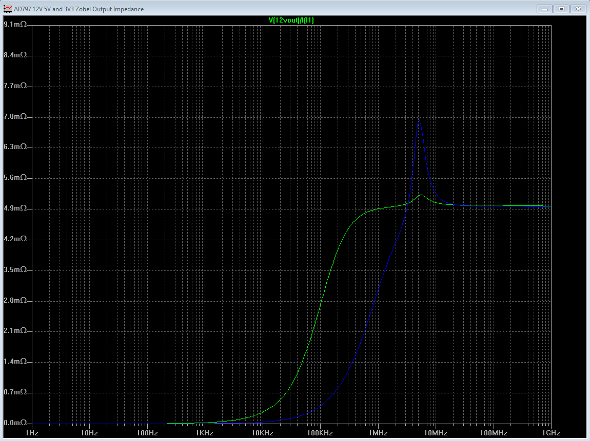

Dude you want a logarithmic scale on the vertical axis so you can see exactly what "close to zero ohms" really means.
And aren't you intrigued to run transient analysis when you hang a 1-ampere, 5 MHz sinusoidal current source on the output with 4 amps of DC load flowing? Don't ya want to know whether the blue peak at 5MHz is anything to fear?
Yeah I just hate scientific notation. Need to get used to it.

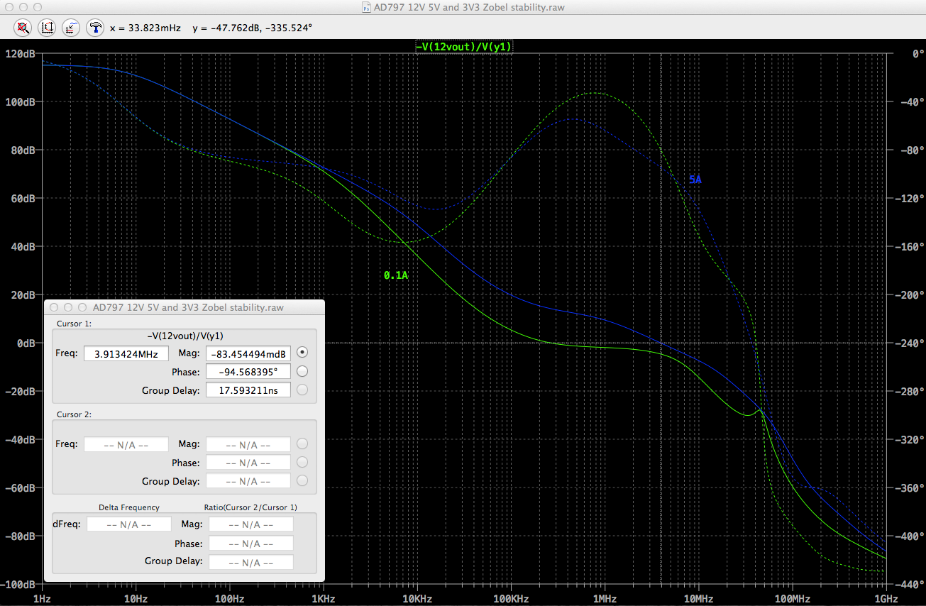

I was fearing it. It's not good...it breaks into oscillation when I add on the sinusoidal (SINE(4 1 5Mega 0.2)). I'm trying to rationalise this versus earlier phase and gain margin analysis...🙁
5MHz is where phase passes through -180 degrees (thereabout for all loads). Here I see 11dB plus of gain margin for 5A and more for lighter loads. I'm obviously missing something important re stability and presumably need even more gain margin.
If this thing has flat impedance below 10 mOhm from 10Meg to 1 GHz, either you get nobel prize, or your spice model has a slight problem. I suggest investigating the second option, which may also explain the peaking...

I understood that it was typical/normal for impedance to approach the series resistance of the output caps at high frequencies. (I can't find the exact source where I read this at the moment - likely Cordell.) It's certainly consistent with the output above - two caps in parallel each with 10mR of ESR.
I've spent some time with the models and even more re-reading all of Cordell's pages on negative feedback and stability. The models I have done for phase and gain margin analysis at various loads and transient load changes (extreme square wave step in DC current load) all seem okay. I have swapped out the op amp for an LT1498 in the model and it exhibits the same impedance behaviour.
The output above is with a Zobel network (100p cap in series with a 47R resistor) from drain to gate of the series pass transistor. A similar impedance plot appears with a plain 100R gate stopper resistor. With the Zobel at the gate, the op amp compensation is a simple Miller integrator of 47p. Increasing the size of the Miller capacitor has no affect on the impedance peaking but of course lowers fc and hence higher frequency PSRR. With the gate stopper, the op amp compensation requires a resistor in series with the Miller capacitor - a form of compensation discussed by Cordell also. I re-examined the output capacitors and looked at adding higher ESR there - it worsens gain margin.
I've read a lot about gain peaking being an indication of instability but I'm struggling to find a discussion regarding impedance peaking. I will keep digging but I am feeling way out of my depth here even when I now feel I can follow a good deal of discussion regarding negative feedback stability and amplifier compensation. Perhaps I am missing something even more basic.

Indeed I don't have the ESL of the output capacitors in the model because this information isn't available in the data sheet (it's there for the main filter caps). And I have not modelled trace resistance or inductance, nor anything downstream of the output from the regulator (wiring to my TPS3510 power control board, that board itself and wiring from there to the motherboard) - except the test load. Are you suggesting that this wiring resistance and inductance will likely mean the modelled peaking in regulator impedance is a non-issue (in like manner to the issue I had when I slapped on a lump of load capacitance)? This is one of the things I wanted to try tomorrow if I can carve out the time...
Ok adding capacitor ESL had an enormous impact on output impedance with the peaking more severe. But it improved phase and gain margin. It did not stop the oscillation with a transient to 1A of sinusoidal (+4A DC) current load. (Neither did adding the resistance and inductance of 15cm of 16AWG wire.)
