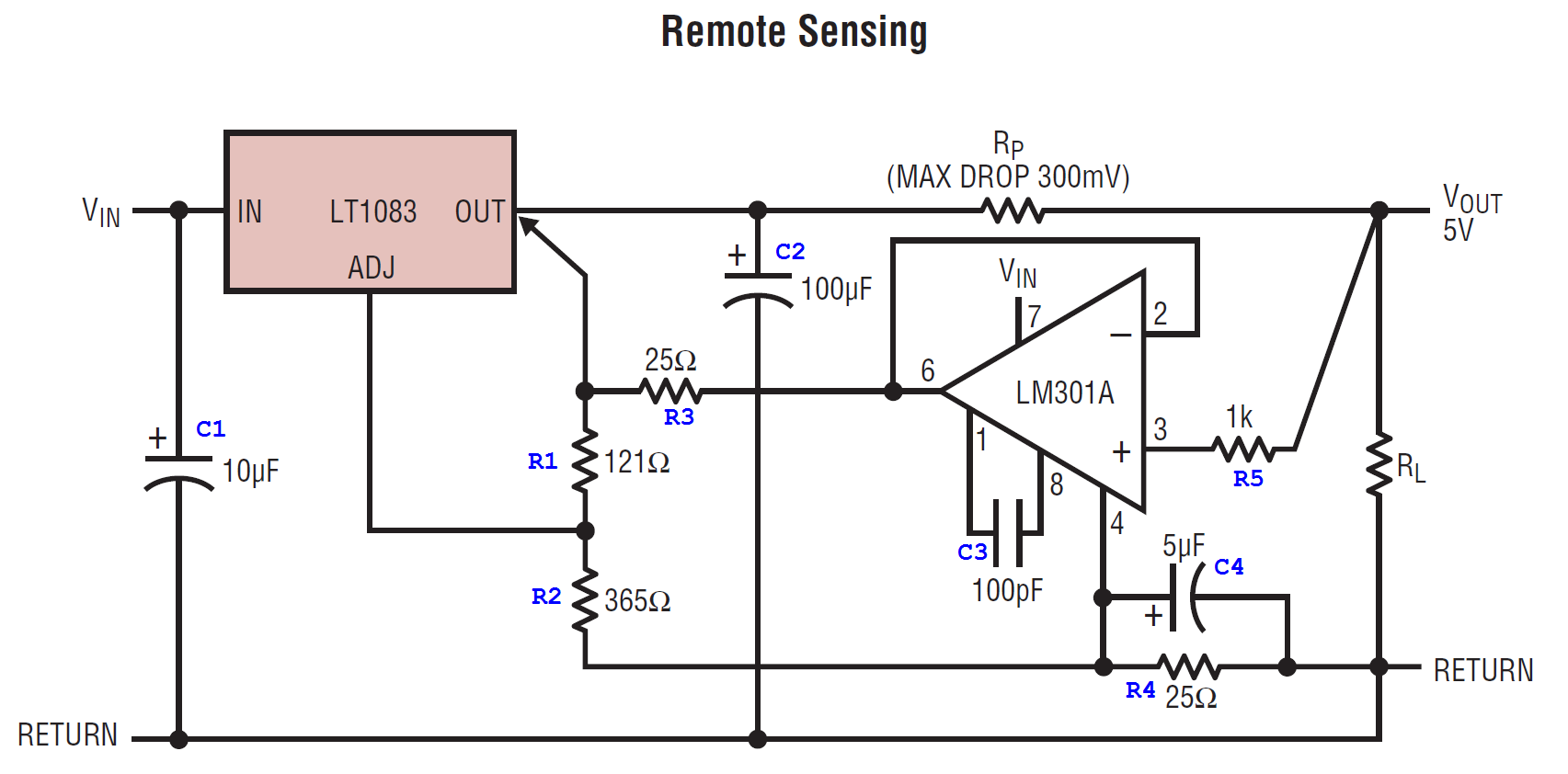

Linear Technology's Remote Sensing circuit in post #179 above, is somewhat unusual. I've copied the schematic below and added names for each of the components. Readers may enjoy discovering whether or not it works, and if so, how? It's a fun little problem in circuit analysis.
I've attached my own analysis and explanation below. It's in a .zip archive file so it won't accidentally pop up when you're browsing this thread, and ruin the surprise / fun of deconstructing the circuit. More than one "click" are required to open the zip archive, you can't do it by accident. Neither can your cat, no matter how furiously she pats your keyboard or touch screen.

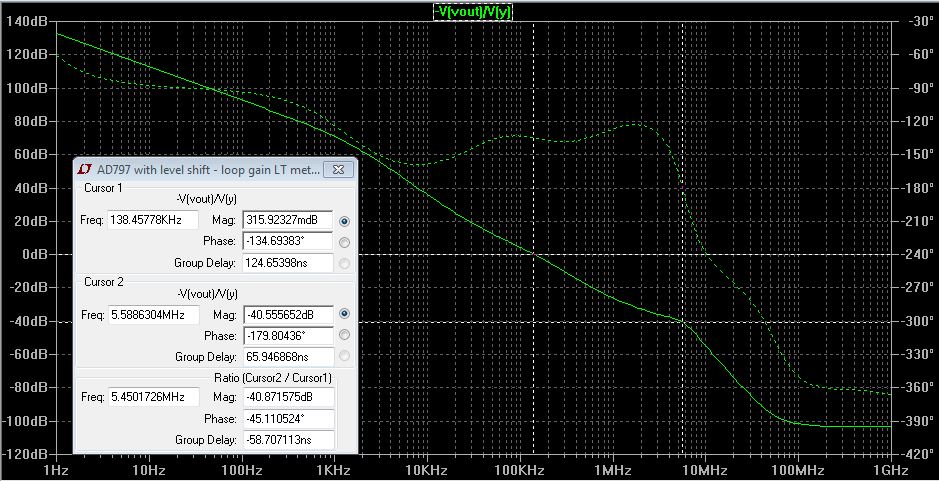

One of your most serious problems is going to be: how to employ the AD797 opamp (which requires at least 10 volts between Vcc and Vee) in your 3.3 volt regulator.
One option is to use the wonderful Linear Technology LT1498 opamp in all three regulators, since its supply voltage range extends from 2.2V to 36V (!!) and its other specs are reasonably nice. But this would mean abandoning the AD797 and you seem to be enamored of it.
Another option is to use 3 different opamps in the 3 different applications; use the "best available" opamp for each supply. And then hope they are pin compatible. And then hope that the frequency compensation schemes for each one, can be mapped into a common PCB footprint.
Well, here is yet one more option: provide a low current "super voltage" supply to each board, which is at least 10 volts higher than that board's regulated output voltage. Now you've got 13.3 volts, 15 volts, and 22 volts. You can use the exact same AD797 opamp, with the exact same frequency compensation, in all three boards. Another benefit: no level shifter! Even with the non-rail-to-rail AD797 driving a high-threshold-voltage enhancement mode MOSFET, the opamp output pin can swing higher than necessary.
You could set Vsupervoltage = 15V for both the 3.3V and the 5.0V boards. You could set Vsupervoltage = 24V for the 12V board.
You could generate these with a little dinky auxiliary transformer (24VAC @ 10 volt-amperes), an LM7824 for +24V, and an LM7815 for +15V. Small and simple.

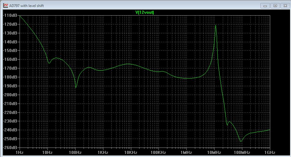

I had already started testing "The AD797 with 12V supply might even swing high enough for 5V out..." A little over 9V is required and so 12V would seem to provide good headroom.

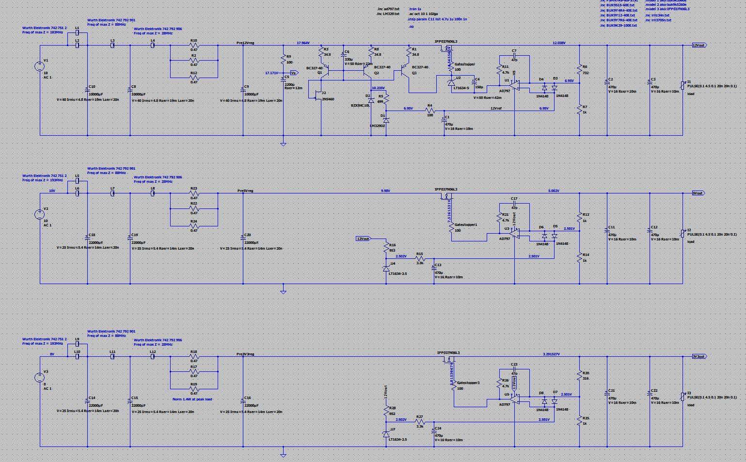

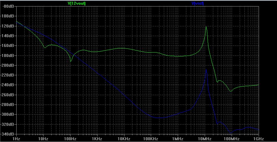

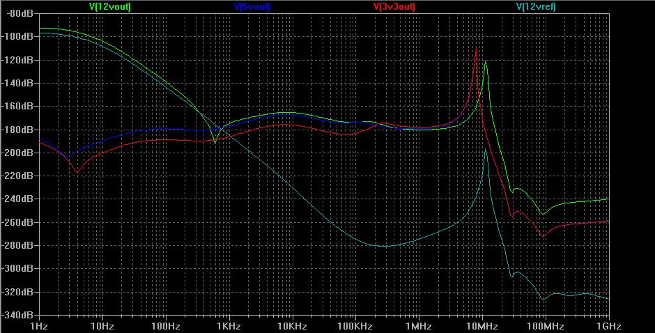

Not much progress due to alternate demands on my time and some LTspice issues. I did finish linking the 3 regs in LTspice and - apologies to Elvee - I am finally posting the .asc files.
Strangely, powering the Vref for the 5V and 3V3 rail from 12Vout affects the modelled PSRR of Vref for the 12V reg (with subsequent deterioration in 12Vout PSRR which likely affects the other voltages). This makes no sense to me as 12Vref is driven from Pre12Vreg and not 12Vout.
Attached zip of necessary .asc files etc and some pics of modeled PSRR.

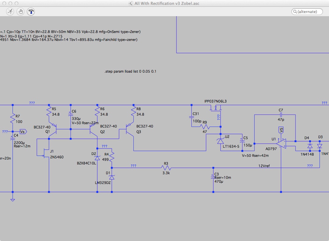

Mark or others, do you have any views on a Zoebel network in lieu of a gatestopper resistor. Cordell mentions a 47 Ohm resistor in series with a 100pF capacitor from gate to drain as being a better solution to potential instability than a gatestopper. In line with his comments, it would appear to provide more phase headroom with less impact on PSRR (less impairment of the speed of the pass transistor).
Attached are modeled phase and gain margin (0.1A load) with a 100R gatestopper which also requires heavier op amp compensation. Also attached is the same for the Zoebel network; it would appear to provide more phase cushion albeit less gain margin, allows less heavy compensation and models better PSRR.
Thoughts?
Thoughts?
The safe play is to include all three components in the schematic and (more importantly) on the PCB. If you think you prefer the RC network from gate to drain, go ahead and include an 0.10 ohm gatestopper resistor too. Now you can try out one approach (gatestopper but no RC) and/or the other approach (RC but no gatestopper) without fabbing new PCBoards.

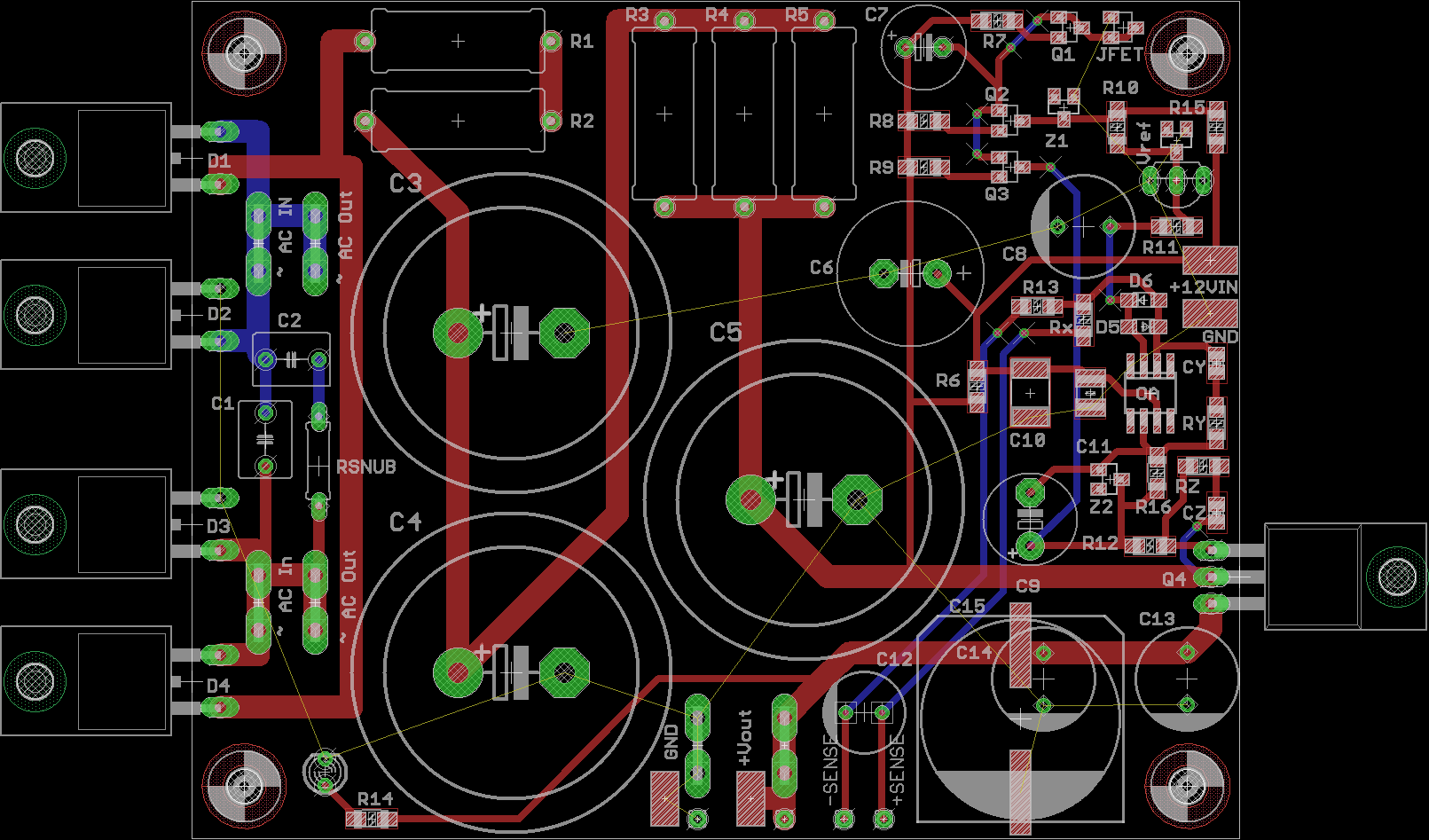

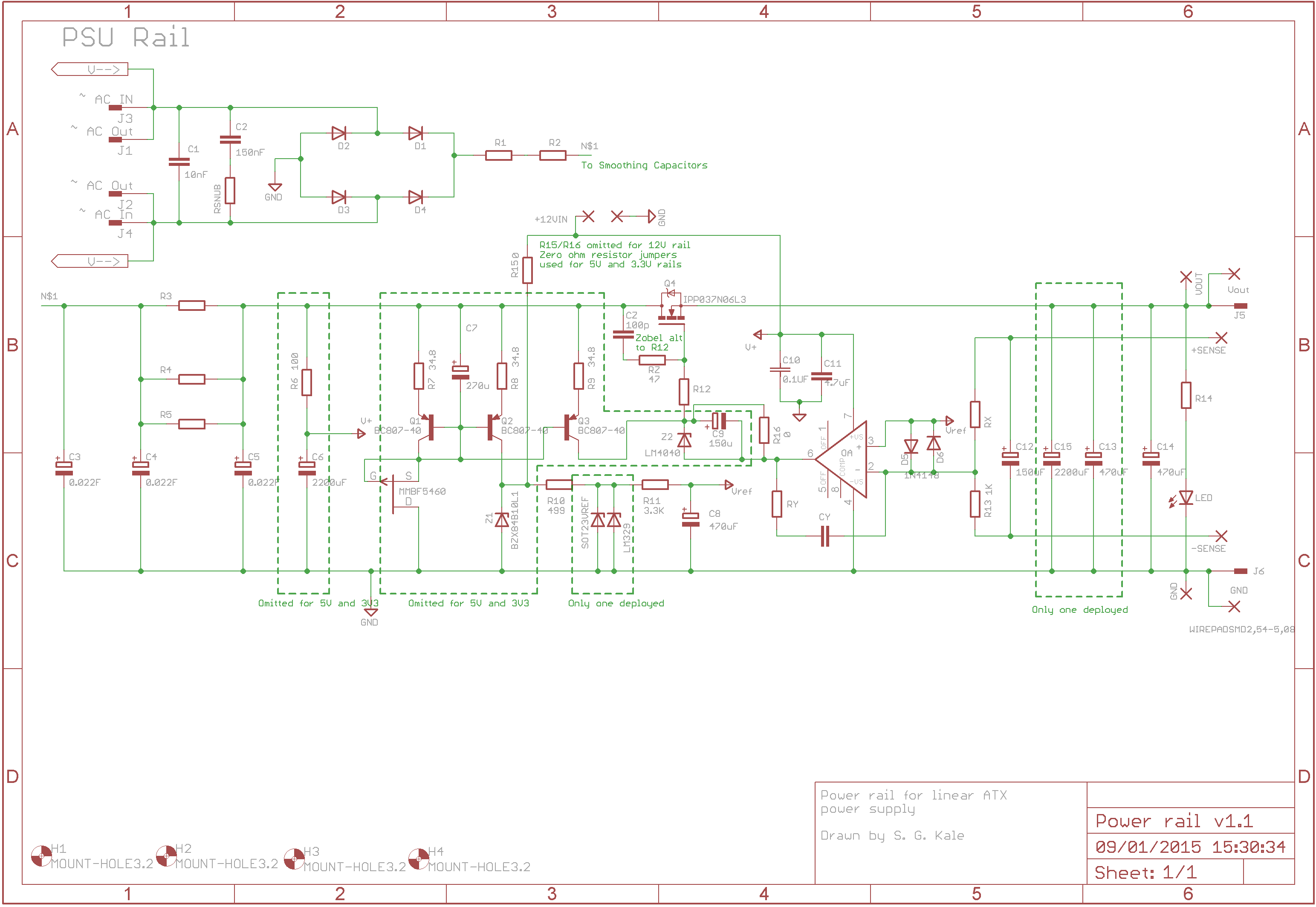

Latest and greatest. I still have some modelling to do here. Looks like R1 and R2 won't be needed, but I am not sure it's worth redoing the board as the space freed up largely ends up falling between C3 and C4. I may just dump the LED1/R14 indicator.
Schematic with annotations, board and BoM attached. All comments/advice greatly welcomed!
[Thinking about soldering the 12V SMD parts is intimidating. (The other rails should be easier as they omit many of the parts.) I will print the board actual size on a sheet of clear film and cut a stencil. I'll then have a go at 'skillet reflow soldering' it. I have an induction hob with a metal plate that converts it to a regular hob. The temp of this can be set. Unless of course there's a real risk that the induction will destroy parts?]

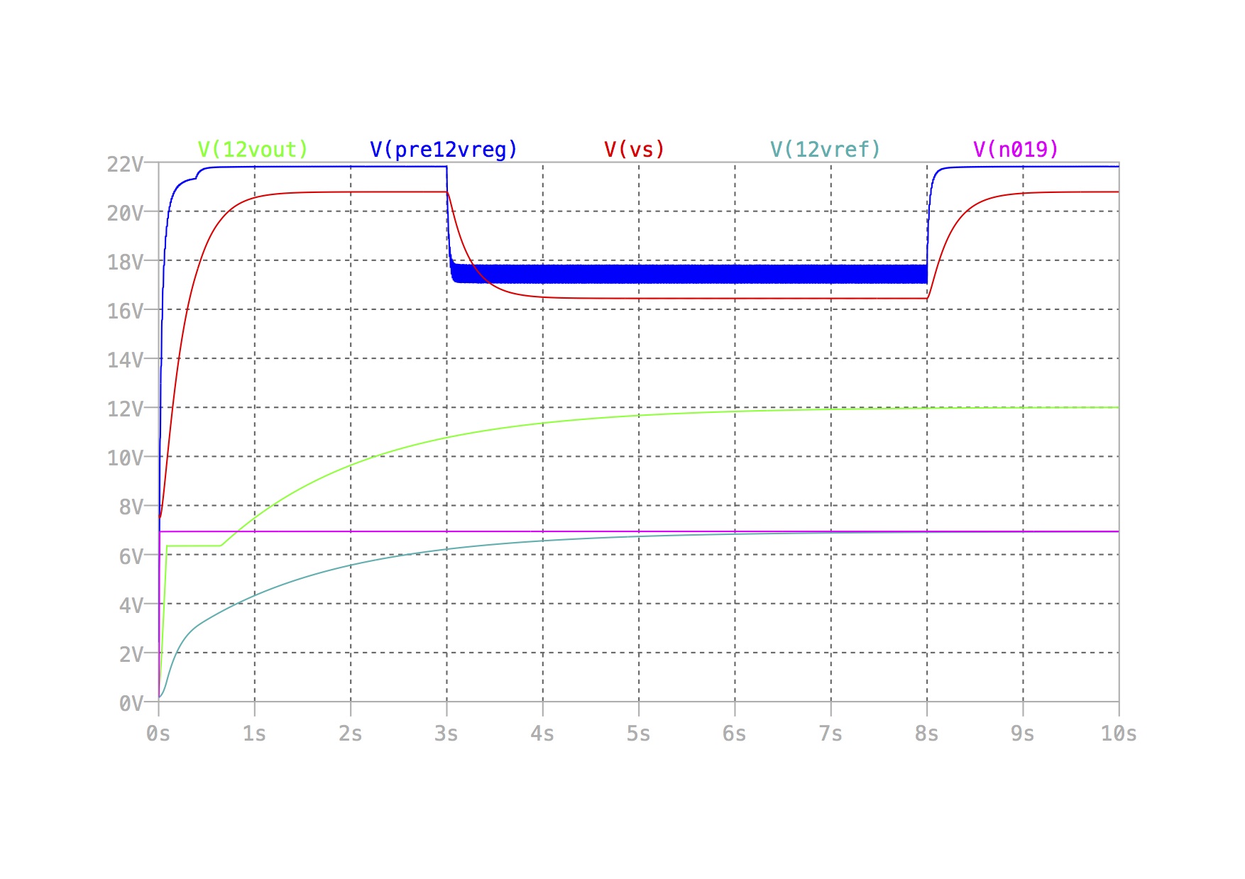

I've been distracted by another thing I'm witnessing in LTspice. To check all my power dissipation, voltage headroom etc I have a circuit which includes the NTC-based soft start, toroid, rectifier diodes and, of course, the regulator. I have stripped this back to just the 12V rail and attached it here. See attached.
The sim shows Vref for the 12V rail taking a long time to come up to 6.9V which surprised me initially because it's not the case in the DC-driven circuits but I believe it's because C3 needs to be charged and the RC filter has a very long time constant of some 1.55s and so Vref takes 6+ seconds to come up to spec. I guess I have learnt that LTspice assumes everything is fully charged when using DC voltage sources? (And that on initial turn-on there will be quite a delay before PWR_OK is true.)
What's interesting is if I run the circuit plotting Vref with differing circuit loads. Zero load = almost instantaneous Vref. 100mA and I get the gradually increasing Vref similar to the graphic I attached. In all cases the current through R4 is relatively unchanged, the voltage potential on the left side of R4 is unchanged. The currents through D1 and R3 do change materially with load which doesn't make any sense to me given the level of current through the non-inverting pin of the op amp should be minuscule in all conditions. I guess this is just device sim inaccuracy. There's quite a difference in this behaviour if one uses the AD797 model rather than the AD797A with the former seemingly producing more realistic results (except for zero load)...
