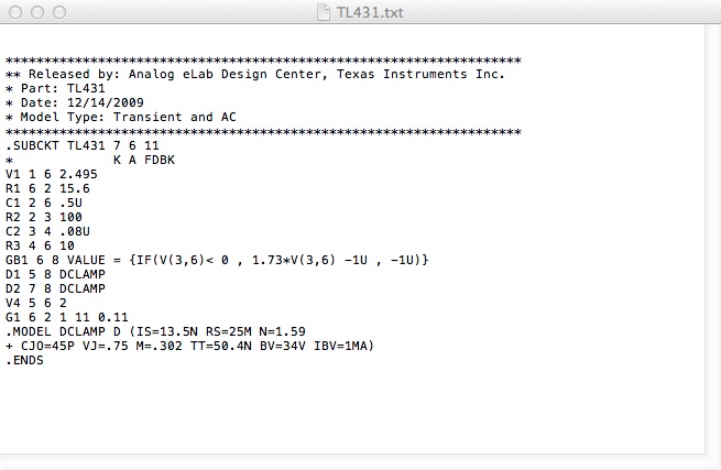

I took a look at the circuit in #159. You must have a rather different TL431 model to me as I could not replicate your output (even when stripping out ESR for the caps so that all components were plain vanilla LTspice native). In any event I still had problems applying it to also provide current for the level shift. I will have another look in the morning when I am less tired.

The people who built these ICs, had (proprietary) spice models that were extremely accurate AND that tracked the tolerance guardbands of FabProcess, VoltageVariation, and TemperatureVariation (the holy trinity PVT) 800% more accurately than you, a lowly customer, can ever hope to realistically achieve. Let the pros do what the pros do, for a living.

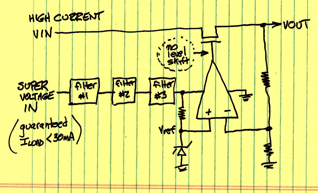

One of your most serious problems is going to be: how to employ the AD797 opamp (which requires at least 10 volts between Vcc and Vee) in your 3.3 volt regulator.
One option is to use the wonderful Linear Technology LT1498 opamp in all three regulators, since its supply voltage range extends from 2.2V to 36V (!!) and its other specs are reasonably nice. But this would mean abandoning the AD797 and you seem to be enamored of it.
Another option is to use 3 different opamps in the 3 different applications; use the "best available" opamp for each supply. And then hope they are pin compatible. And then hope that the frequency compensation schemes for each one, can be mapped into a common PCB footprint.
Well, here is yet one more option: provide a low current "super voltage" supply to each board, which is at least 10 volts higher than that board's regulated output voltage. Now you've got 13.3 volts, 15 volts, and 22 volts. You can use the exact same AD797 opamp, with the exact same frequency compensation, in all three boards. Another benefit: no level shifter! Even with the non-rail-to-rail AD797 driving a high-threshold-voltage enhancement mode MOSFET, the opamp output pin can swing higher than necessary.
You could set Vsupervoltage = 15V for both the 3.3V and the 5.0V boards. You could set Vsupervoltage = 24V for the 12V board.
You could generate these with a little dinky auxiliary transformer (24VAC @ 10 volt-amperes), an LM7824 for +24V, and an LM7815 for +15V. Small and simple.
Conceptual schematic below.

Mark, you're pretty darned good at explaining stuff in a way that sticks....thank you 😉
I agree! Thanks Mark.
Thanks again Mark. At the moment I am feeling rather beaten in this fight and the dual LT1084 has gained a very high level of appeal.

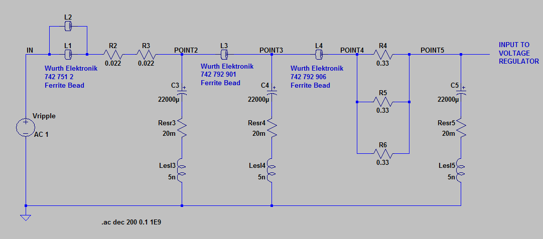

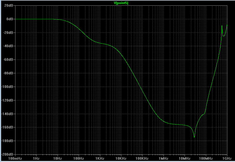

Two cascaded PSU/regs each with poor attenuation of the above audio interference still leaves the supply contaminated with the HF stuff.
Fortunately, post #92 in this thread offers some advice: "Sprinkle in some ferrite beads, with or without resonance killing resistors"
I plunked down a few of the beads whose models are built-in, presupplied with LTSPICE, interspersed among SGK's circuitry that sits between the rectifier bridge and the input to his (first) regulator. Simulator results attached. The beads seem to do a lot of good below 200 MHz or so. For attenuation above 200 MHz he will need to find a way to shunt out those equivalent series inductances; the standard ploy is to install SMD ceramic bypass caps. I'd start by putting one at the downstream side of each resistor.
_
